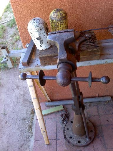

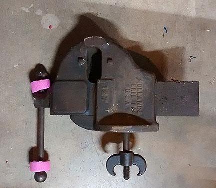

Ahh shame them out of biting! I found some rubber washers that I was able to push over the knobs when I warmed the rubber---moved them in a bit so they would show up better on my travel vise:

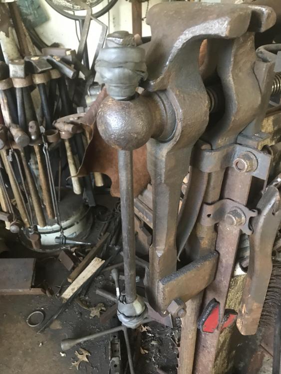

I cut some big rubber bands from an innertube (just cut straight across to make a ring) and wrapped those around the handle next to the knobs.
The picture ThomasPowers added got me thinking of my technique. It may be unusual, since I was self taught...or it may be common. I don't rightly know...
I never turn a vise with the handle centered , like the picture. The handle is always fully on one side, and I keep a slight outward force as I turn , so it never starts to slide. When the turn is finished, I just remove my hands and let it fall with a 'clunk' if it was facing up. No issues. I never get bit; there is no way for that to happen with this technique. I would wonder about the training of the smith, if I saw bright colored puffy padding on a vise in a one man shop, and they were not a teacher. If I may joke around (hopefully without offending anyone) , the padding looks like training wheels. The twine however, looks acceptable to the eye, like an old world safety feature. Just my opinions here :)
