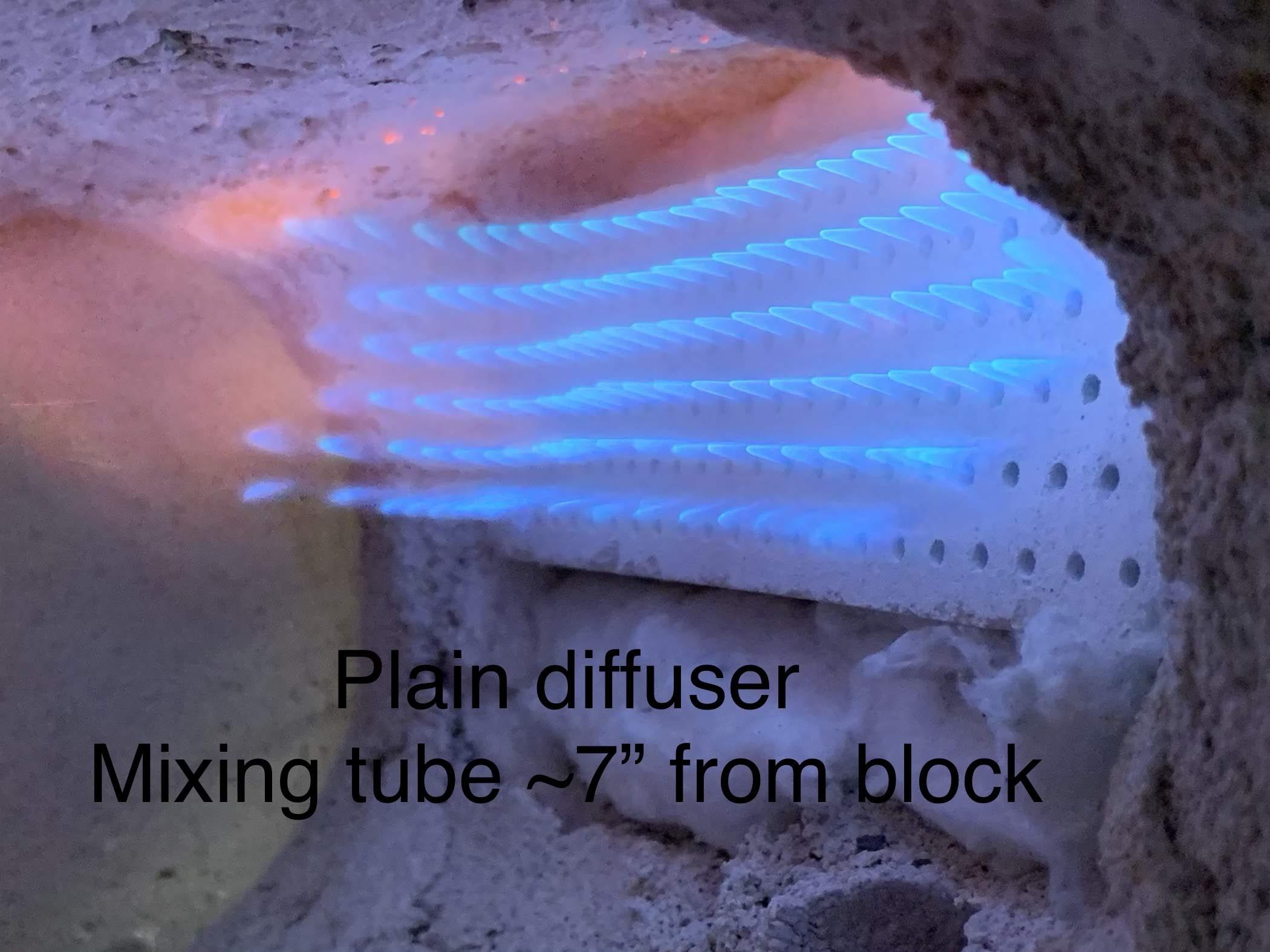

... I couldn't resist trying. In the as-designed setup, the end of the mixing tube is ~9.5" from the back of the nozzle block. I slid it forward to try a couple alternatives. Maximum extension puts the outlet ~5" from the nozzle block; I adjusted for what I thought looked best and it was ~7" from the nozzle block. I find these results interesting.

Looking great!  Good to see another burner with small holes and get some more data about them!
If I read this right, it looks like you have 6 rows of ~22 nozzles each (about 66 holes), at about .11" each.  At pressures over 10lbs it appears to be blowing off the block.  For reference, I have 124 holes at 1/8", much closer together.  I started with less holes, then worked up.  It holds onto the block outside the forge and runs from 0 to 20+ inside with a stable flame.  You may be able to double the number of holes you have.  Possibly more actually as I haven't tried that, I just don't have room on mine for more holes (2.5 x 8" plenum).  Also, blackburn doesn't happen at low pressures on regular burners until they heat up - after about an hour of forging, so you will have to try a long run to see how it works at low pressures (though those size holes may be too small for blowback).

Thank you Dan. My first ribbon nozzle has 135 nozzles, each is 3 mm (0.118") diameter. That gives a total area that is ~2.2x my mixing tube, so I thought it would be okay for velocity. My single-outlet nozzle (jet nozzle?) has an area that is ~3.4x the mixing tube but it burns in the nozzle so I knew I wanted it a little smaller. The ribbon flames do seem to blow off the block at high pressures. I couldn't decide if that is a problem, so long as the flame stays lit?
The current block is 8"x2.5", just like yours. As you say, I will have to try a long burn to see how heat soak affects the burner, particularly for low-output performance. Given how well the PLA core worked, I fully intend to try another block with smaller holes. I'm still a little mad at myself for taking the heat gun to it because it would have been really nice otherwise. I don't think the misoriented outlets really matter much but it does bother me. At some point, reducing the diameter of the outlets will make the core too fragile, but 3 mm was no problem. I think using another refractory mix helped, because it flowed into the mold like magic once I applied vibration. It did take three bags, so it wasn't the cheapest experiment. I wonder if the block could be thinner once the outlets are smaller? Please do try the PLA method if you have access to a 3d printer; not having to build the wood box was also pretty convenient.

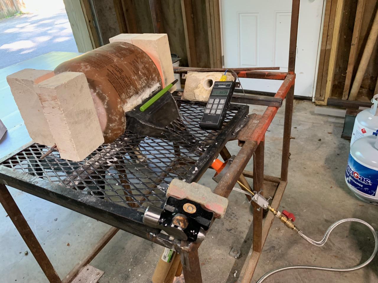

I rotated the forge a bit so that the burner enters at an upward angle, to help keep heat off the plastic inducer. It seems to work fine that way, as the mixing tube did not heat up at all during operation over a couple hours.
The ribbon nozzle certainly works but I'm not sure it's working as well as it could. I was seeing ~1700 ºF while running at ~7-8 psi. The flames were generally pretty short and there was a lot of secondary flame, so I guess rich. At times the flames lengthened out to how I've seen them before. I think my taped-together plenum is leaking so I need to work on that. I will probably just go ahead and weld it together.

I welded my plenum together, which seems to help it maintain a stronger flame (no leaks):
Here is the ~6.5 psi startup flame:
Once warm, a 10psi flame burns a bit off the block:
There were no issues running at ~2psi.
Oh, I'm curious about what I might expect for being able to get to welding temperature. My forge volume is ~300 in^3, and I'm using something like a 3/4" burner (the mixing tube is larger ID than a traditional 3/4" pipe). Any thoughts as to pressure I might have to run at the gas jet? I.e., is 10 psi typically enough for this sort of thing, or would you generally expect to go higher? I know each burner-forge setup is different so what my setup needs will be different from yours, but having some examples and ballpark ideas would really help.
You have a unique burner setup and a DIY forge.  I don't think there's any way we can accurately guess (or even ballpark with confidence) the psi you need for forge welding.  I've built a few forges and burners, but smaller than yours and I'm usually close to 20 psi for welding, but each combination was a little different from the others.
If you have forge welded before you should be able to read the visible signs of the steel and flux in the forge to know when it's hot enough (then note the psi you were running at the time for future reference).  If you have not forge welded previously then it would be a good idea to get with someone who has so they can point out to you exactly what you need to look for and help you avoid common pitfalls. Other than that it's reading books and/or watching videos and then trial and error.
Thanks. Knowing that your forge takes something like 20 psi is helpful; I didn't figure you would be able to tell me what I will need in my forge. I have never forge welded so that's (a big) part of the problem. I've only had my forge hot a few times. While I have a thermocouple, it seems to take a while to equalize in temperature and I'm not sure how much to trust it.
It would be super helpful to work with someone in person; I will try to get to a local meeting to make some contacts.
I'd use the thermocouple in a similar way to the psi on the regulator.   Rather than shoot for an absolute psi or temperature reading, note what both of those were when the conditions in your forge are appropriate for forge welding.  In other words use those indicators for repeatedly creating the correct conditions rather than be concerned about what the actual readings happen to be.
If your thermocouple reading is off by a few hundred degrees it doesn't matter as long as it is consistently off by the same margin. Once you know when the conditions are right then you know the correct temperature reading in your forge with your burner and your thermocouple.  That doesn't mean it will be accurate for anyone else's setup, but you should be confident that it's right for yours.
Good point, thanks. I put the thermocouple in because it seemed like it would possibly give useful info, so if it can help me repeat conditions that's great. I've been a little tentative to run more than 10 psi so far, but I will do so next time I fire it up and see how things go.
