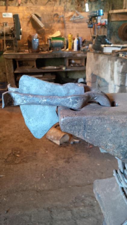

I find leaf spring fairly good, I upset the area for the eye, also I found a little spring clamp to hold it when punching came in really handy. Especially when it can hold the axe with the beard over the edge of the anvil.
I really like your little spring clamp. SWEET tool! Thanks for the pics.
