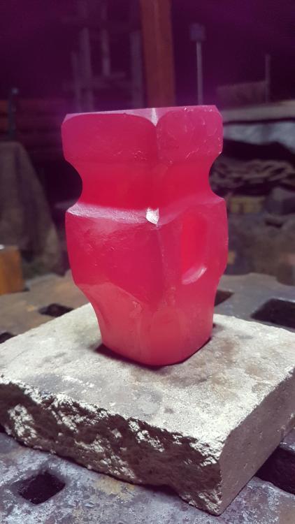

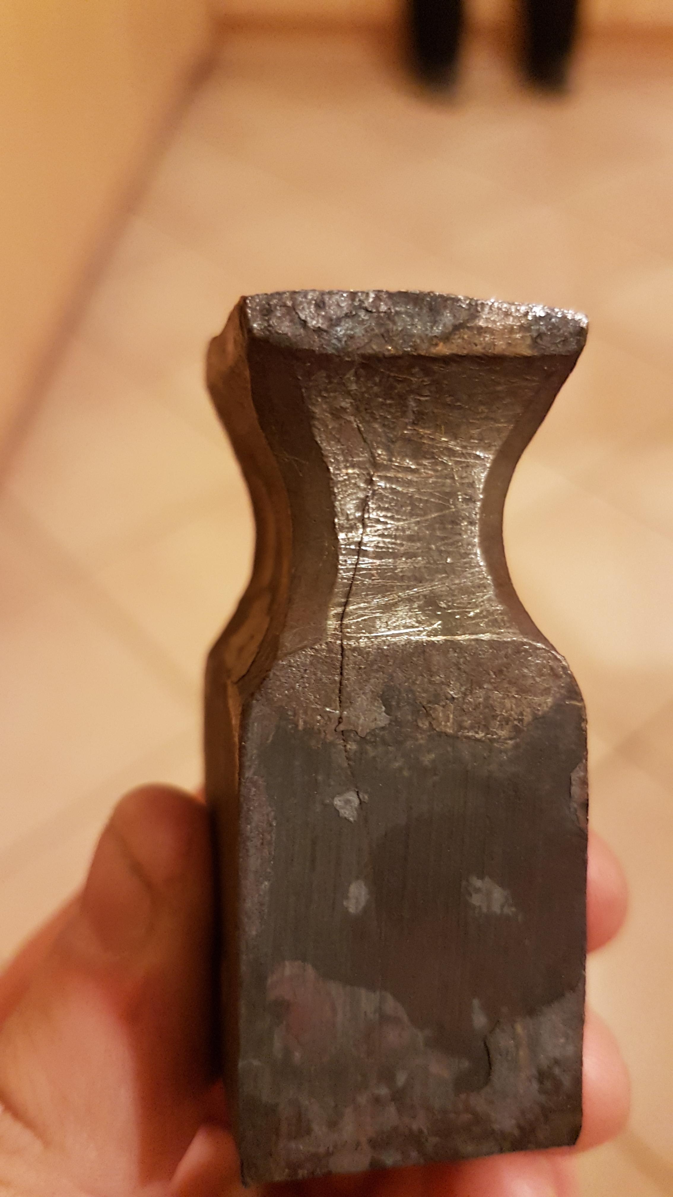

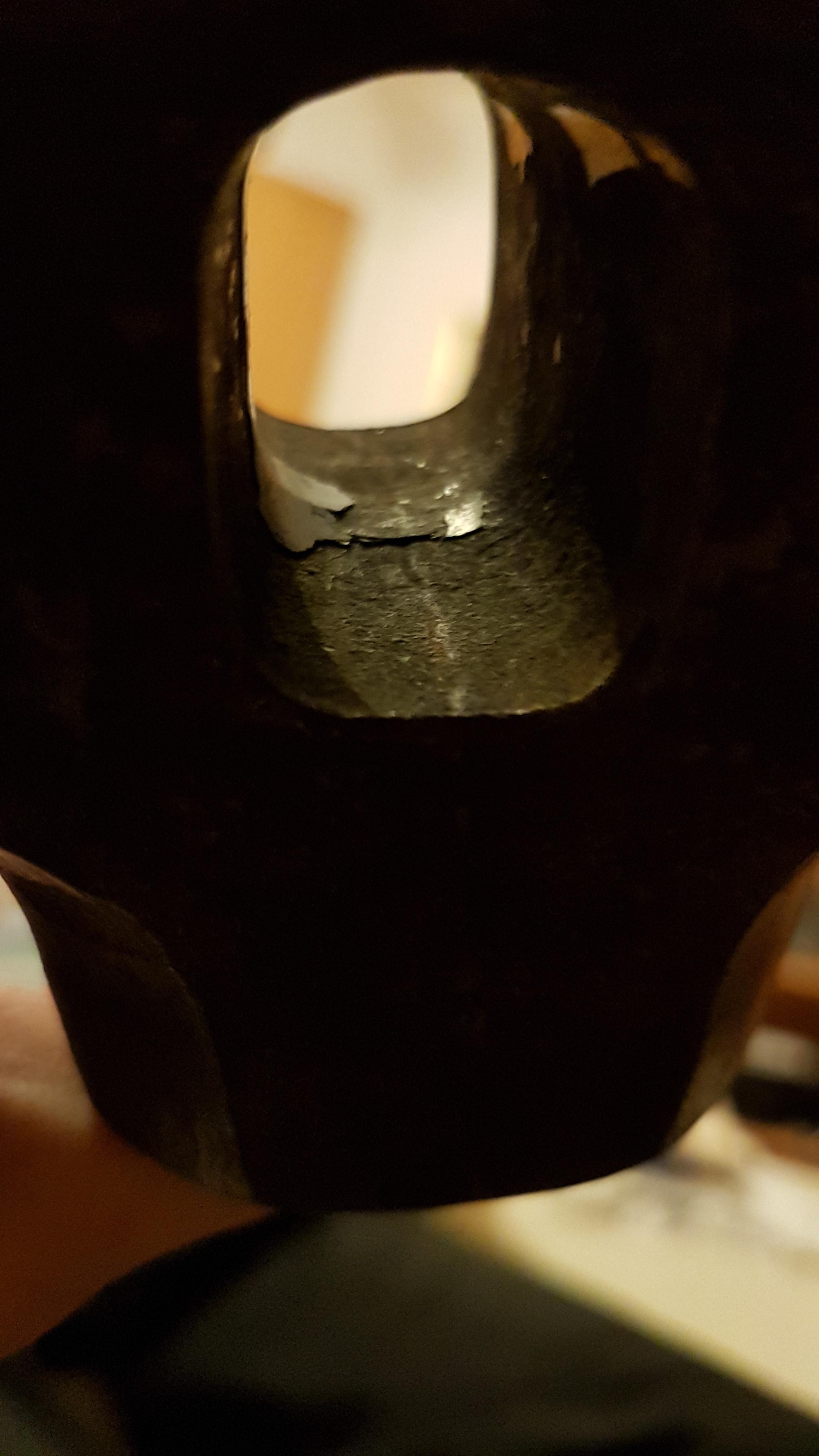

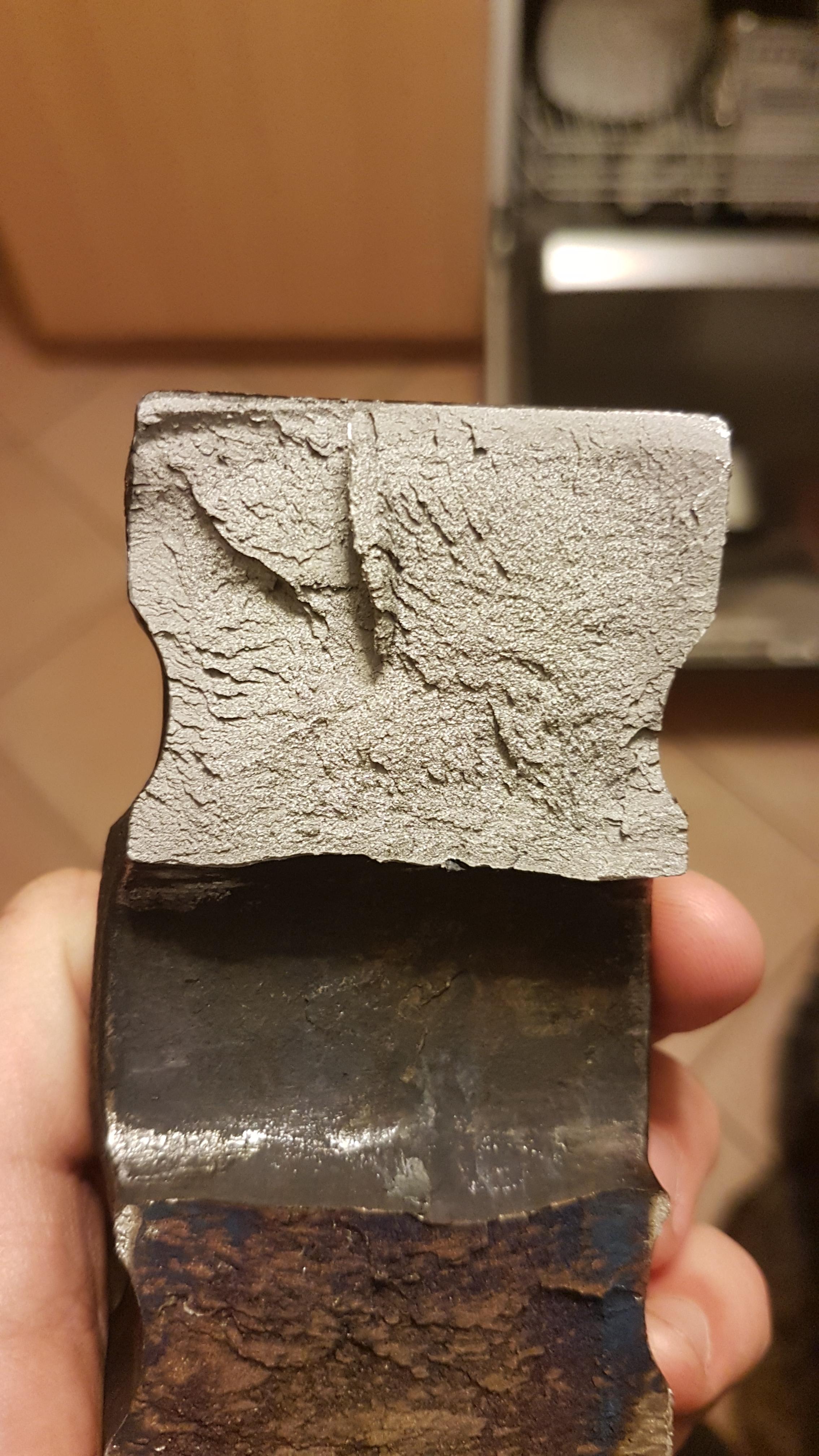

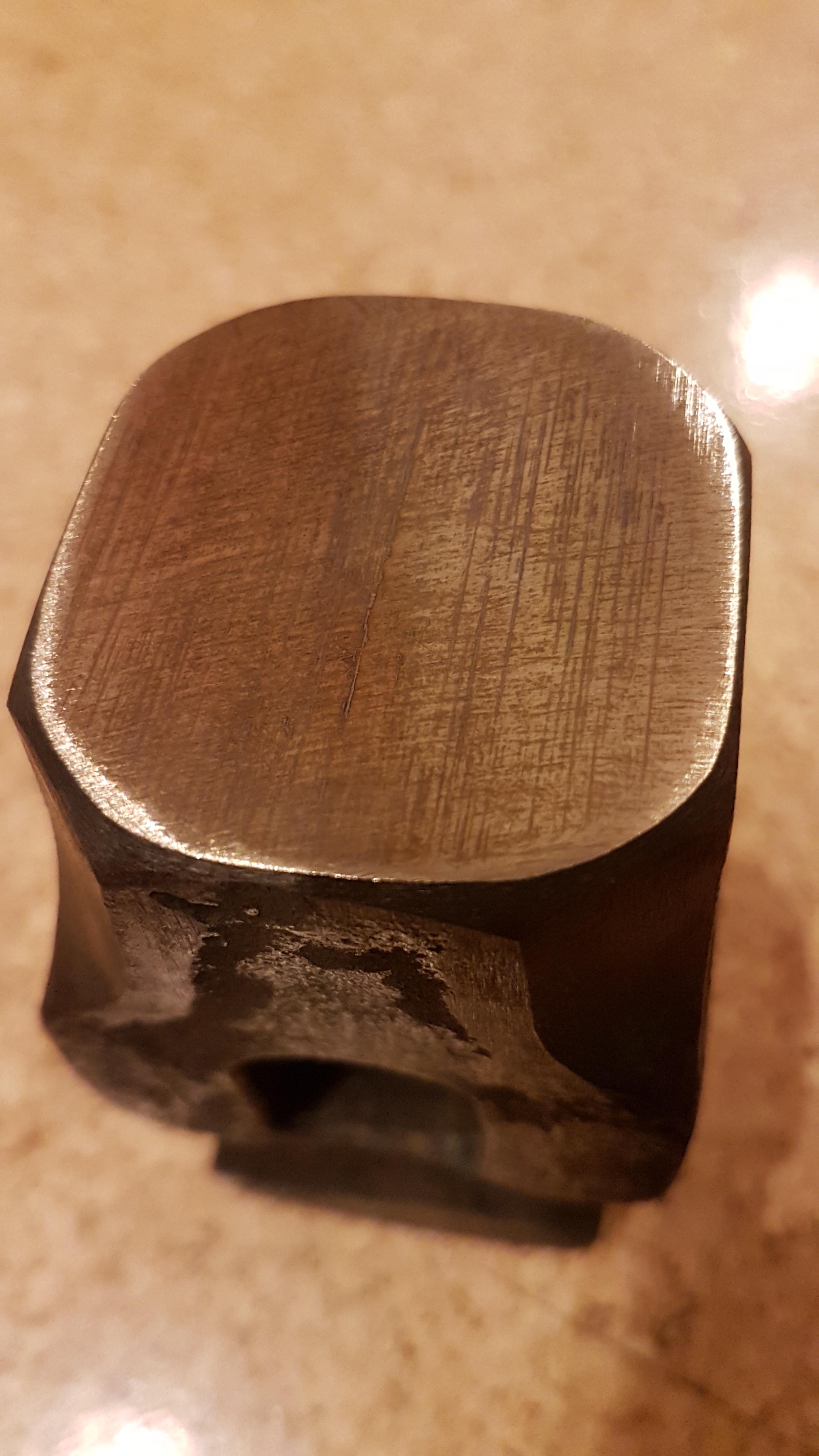

Cast and Forge Posted February 13, 2019 Share Posted February 13, 2019 Hey Forum, I think I forged about 12-15 hammers from 1045 yet and in the last months I have massive problems with them cracking during the quench. Picture 1-3 is the first hammer that cracked during the quench. I heard 3 times the horrific "ping" sound and here you go with a big crack right through the eye. Picture 4-5 is a rounding hammer that showed the same kind of crack as the first hammer. I heared no sound of cracking. I cracked it completely open to examine the grain and the crack itself. After this hammer cracked I assumed that I forged the steel too cold when drifting the eye. So I forged the next little 0.9 kg hammer a lot hotter. I will heat treat it the next week I think. What really confused me is the piece of steel in the last picture. I finished my guillotine tool today and tested it on this piece. Just a couple of heats and some hard hits with the hammer. After I finished I put the piece aside and shut down the forge. When I came back it wasnt red hot anymore but still hot (black heat). So I threw it in the water bucket to cool it down. After I looked at it I saw this big crack right through the fuller grove. Iam at a point now where I dont know what to do next. Nearly every piece of 1045 cracks (Iam glad the guillotine dies did not). I forge everything by hand so its really frustrating to see the hard work going to pieces in the quench. Any tips/suggestions? Those hammers are the first ones after changing from solid fuel to a gas forge. Can there be any connection to this? Iam thankful for every hint. Thanks Tim Quote Link to comment Share on other sites More sharing options...

Frosty Posted February 13, 2019 Share Posted February 13, 2019 Welcome aboard Tim, glad to have you. Yes, there is a big difference between solid fuel and gas forge heat times. Burning coke in the solid fuel fire is in contact with the work so heat is conducted directly where a gas forge heats almost exclusively by radiation. Yes, there are charts regarding soak times in minutes per inch or mm from surface to center. For example a 100 mm round bar would be calculated for 50 mm, surface to center. Yes? I'm sure someone will produce the charts, they've been around for hundreds of years. You allowed your hammer head to cool IN the shut down forge, yes? I'm betting only the outside of the hammer head was at black heat and the center was significantly hotter. When you cooled it water the outside cooled faster and shrunk while the inside was still expanded by temperature and couldn't be compressed. Something had to give and that was the thinner exterior. The last is just my thoughts and is NOT a hard fact. Frosty The Lucky. Quote Link to comment Share on other sites More sharing options...

Irondragon Forge ClayWorks Posted February 13, 2019 Share Posted February 13, 2019 If I remember from the 1045 data sheet about forging it says hold till temperature is uniform (or something like that). Quote Pre heat to 750 oC - 800 oC, then continue heating to 1100 oC - 1200 oC maximum, hold until temperature is uniform throughout the section and commence forging immediately.Do not forge below 850 oC Can't post a link to a commercial site. Finished forgings may be air cooled Quote Link to comment Share on other sites More sharing options...
Frosty Posted February 13, 2019 Share Posted February 13, 2019 You'll get your hammer heads right. 1045 is reasonably forgiving in heat treat. Might I suggest you experiment heat treating unforged hammer stock? Cut a piece or two of 1045 the size you use to forge hammer heads and experiment heat treating them. Once you get those consistently right experiment on ONE OR TWO forged hammer heads, the eye will make a difference in soak, quench and temper time. You are going to fit in here so very well. It's refreshing to talk to adults who ask a question and don't get upset having mistakes pointed out or even getting a little friendly yelling at. Oh, we LOVE pictures. Frosty The Lucky. Quote Link to comment Share on other sites More sharing options...

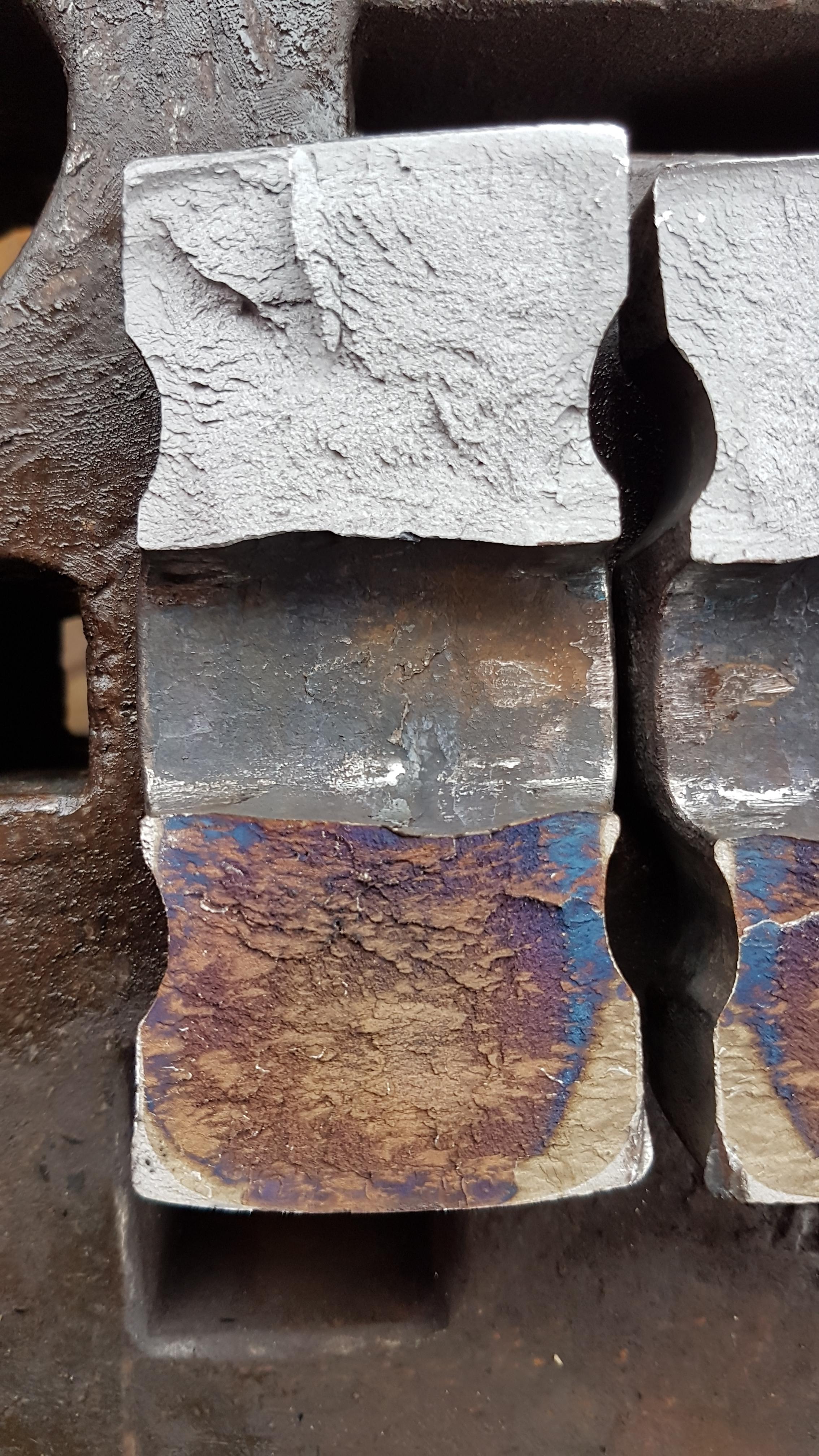

Chris Williams Posted May 23, 2019 Share Posted May 23, 2019 On 2/13/2019 at 2:27 PM, Cast and Forge said: Picture 4-5 is a rounding hammer that showed the same kind of crack as the first hammer. I heared no sound of cracking. I cracked it completely open to examine the grain and the crack itself. After this hammer cracked I assumed that I forged the steel too cold when drifting the eye. I just came across this thread. Do you notice the heat tint on the lower fracture of the hammer in pictures 4-5? It cracked almost all the way through (the non-tinted portion wasn't cracked yet) either while it was still hot and exposed to oxygen, or else it was heated after cracking. I think you may be correct about when it cracked. Quote Link to comment Share on other sites More sharing options...
