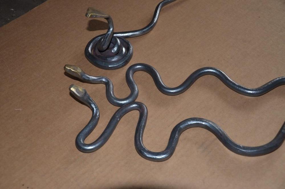

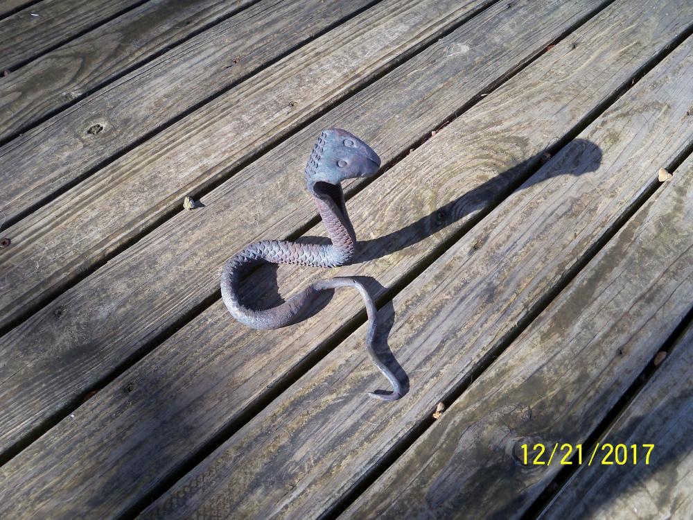

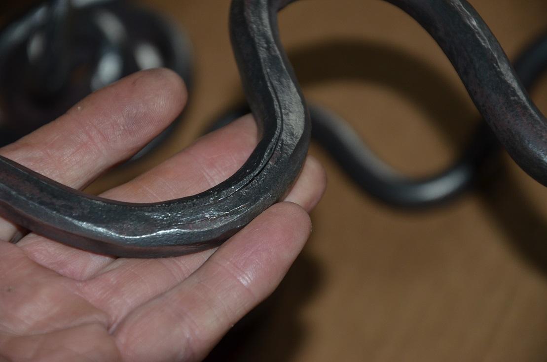

Found a couple of long 1/2 wrought iron bolts. I always have difficulty with wrought so thought it would be a challenge to forge a snake. Kept it really hot and managed OK with only a minimal amount of delaminating (Pic 1. I thought it may have been a fluke so forged a second one and it went well. So the real challenge was to forge a cobra without splitting open the hood. I wrecked one but the second go was OK. Wet season here so very few visitors to the forge - a chance to use demo time to try things that are not guaranteed to work!
Here are the three:

Nice snakes Aus.  I've only messed with WI a couple times and its a real challenge to remember how hot it has to be to successfully forge. The upside is when it starts to delam it welds back together fairly easily. My first go was a carving fork and one of the tine ends literally splintered at a medium orange heat. It welded back together easily enough but I had to work fork tines at sparking heat! They were smaller than wire, pitch fork times. They split out from the main body easily but HOLY MOLY it was A PITA! Fork turned out nice enough and served nicely to carve the roast pig, another attendee at the Shindig forged the carving knife from a spring. In less than half the time start to finish!

Well, you upset the end of the bar to give some mass, and then forge the head shape hammering back towards you. Using a ball pein hammer, widen out the bar just behind the head and then push the steel outwards on each side, trying to leave a ridge in the middle for the throat. I try not to overwork it, as I like the stretched scales across the back of the hood. (That's if you're using threaded rod, of course.)
And I always punch the eyes before forming the hood. Much easier that way.

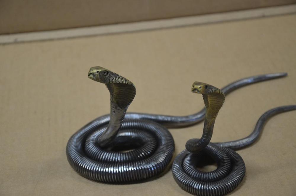

A couple of snakes I made a while ago when I was given some 32mm rebar. both are about 1500mm long and I made the flat one first as a "what can I do with this exercise". The wearable one was made next because my son wanted something he could wander around with and scare people. He (the snake) has had his picture taken with lots of people since.

I have done a couple of 32mm rebar snakes too, but what a pain it is drawing out the tail. Definitely power hammer country. I keep one on display near my forge all the time and sometimes visitors take a backward step.
The best one I made from 32mm was about 1200mm in length and it was stolen from an art exhibition.
