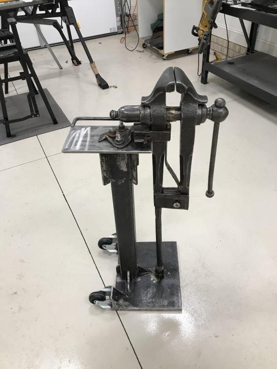

I made a vise stand for my post vise recently.  I don't want to bolt the vise stand to the floor because I like the ability to roll the vise outside to work on something or roll it out of the way if I'm not using it.  Lately, I have been working on trying to twist square bar and making picket baskets.  The problem is that the vise stand will walk a little or rotate if the force being used is anything but straight down.  I worked on removing any raised areas on the bottom and that helped a decent amount but, it still moves too much.  It's frustrating and a little nerve-wracking trying to chasing your vise while working with red hot metal.
I have attached a couple of images of my vise and stand.
Make the baseplate large enough to stand on and then stand on it when using it.

I have thought about this.  I would need to figure out a good way to increase the size of the base that I have.  I wonder if a fold up/down "standing" plate would be worth a try?

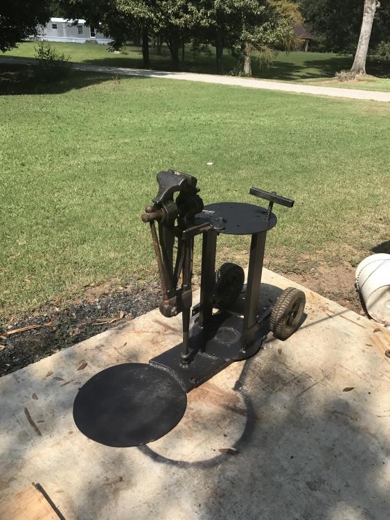

This is one of mine that is moveable, it works great for me

Lionel I like your vice and how you have made it movable, however I would tip that one in a heartbit because I need to work not only at the front of the vice but all around it. No good for me, great for you. We are all different.
