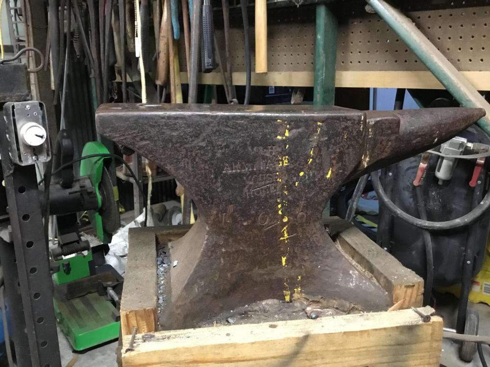

My mouse hole anvil was bought by my grandpa, went to my dad then to me . It was over a hundred years old before grandpa got it and I will most likely leave it to my grandson . It barely looks used but has much done on it.  With proper use it should last many lifetimes.
