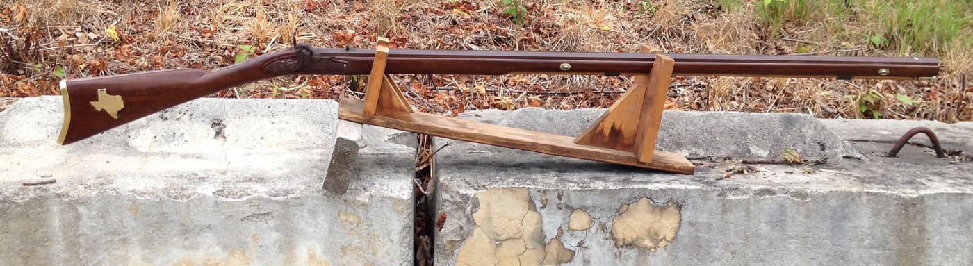

Also, I am sort of winging it as far as technique. I may be missing steps or shortcuts, or doing unnecessary work.  I am working solo, and do not have a mentor on this. I tend to set absurd goals for myself, then pursue them with fanatical determination until I succeed. My first real blacksmithing project was when I was in college, and spent a couple of years making a percussion rifle using Foxfire #5, with a small coal forge on the balcony of my dorm. (The fire department eventually got used to me).
Here is that rifle, if anyone is interested:
Thank you toadboy for the explanation! And for using metric. ;)
That rifle looks pretty nice! I actually have the fever dream of one day making such a rifle by myself. Unfortunatly, I would have to get a gun license which is expensive and usually hard to come by here.
