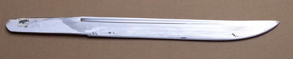

  10. I don't bruise easily, and I can use all the advice I can get. My idea was to cut the grooves, then do final thicknessing of the blade, to leave sharp boundaries on the grooves. I started sanding in some bad spots, but am now burnishing with the steel spike. I have not done any real work near the edge yet. I was afraid that my grooving work was going to be so disastrous that I would have to start over. I did practice grooving on a piece of steel, but it was softer than the blade I am working on. Also, I made the cutting bit out of HSS. I will take the time to make a carbide tipped bit next time. And I probably should gone ahead and put a decent handle on the tool. Thanks for the input.
  11. I made a sen, which worked surprisingly well. I also made a little holder with a reground drill bit as a cutting tool. I ended up making some mistakes, so now I am working on one wider groove instead of two. It is disappointing to stray away from accurately following my original goal, but this is my first time making my own steel, and I guess I can use this as practice for my next attempt at accurate historical replication. Here is the grooving tool, mostly made of stainless steel: After roughing out the grooves, I am using this little spike I made to smooth out the grooves: The biggest issue I have is that the bit in the grooving tool tends to skip a little unless it is kept super sharp. I am working from the muni down. My understanding is that I should leave at least 1mm flat on the edge before tempering. I have a pretty good thermostatically controlled kiln for the hardening process, so hopefully i can get the hamon process right without screwing up too badly.
  12. Here is the lump as of today: I am still working on basic geometry. It turns out to be not as thick as I had liked after removing hammer marks. The ones closer to the edge should be gone once I finish working that part of the knife. Or so I hope.
  13. I am now working on that, thanks. I was about half way to inventing something similar, but with a little carbide "tooth" to cut the grooves.
  14. So, I am trying to make a tanto, Kamakura period style. I have made the steel, and am closing in on the desired shape. I would like to put "hi" grooves on the sides, but have no idea whatever how to do this. Any help would be appreciated. Here is what I am trying to achieve:

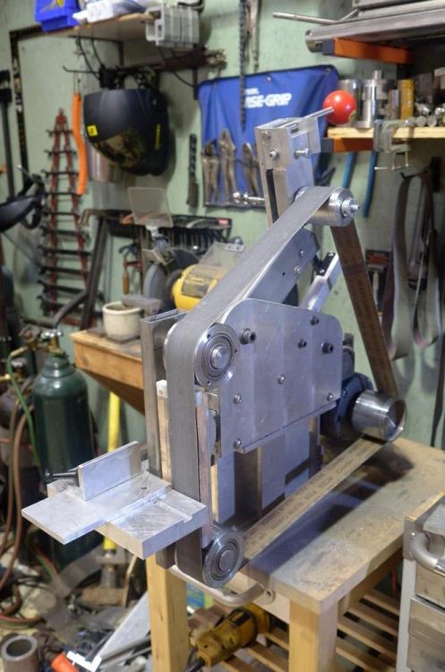

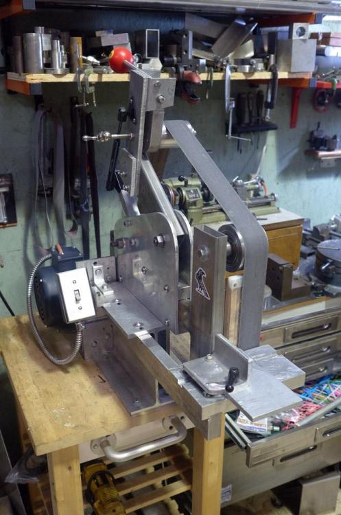

  18. Here are new images. The first one better illustrates the pivot point. The second shows the new table, which has yet to have the slot milled, and the bevel fixture I am working on.

  20. The little gas cylinder is pushing the tracking arm up. I tried several methods, and this one seems to work. The tracking arm rotates on the big bolt in the main chassis. The angle above that on the tracking arm is there to keep the tracking wheel 90 degrees from the drive wheel and the first "working" wheel. It seems to track best that way. Oh, the wheels are stainless steel except for the tracking wheel. About half of the sander is stainless. It is way heavier than it looks. Great catch the motor. I will stick a filter on the back The plan for hollow grinding is to replace the backing plate with a centered working wheel, and back the platen off via an adjustment screw. But I have not made that assembly yet. I am sort of thinking about the best radius to build for what I want to do.

  23. I made the wheels on my 16x40 lathe. I milled the slot, but have since replaced that table with a larger one. The slot was too close to the belt, and things were getting jammed.

  25. Made this with my son to do larger work with our new gas forge. Most of what is here was made from scrap I had on hand. The wheels were turned on the lathe, and it has a few changes since the images were taken, but it seems to run true Anyway, helpful suggestions or clever insults requested.
