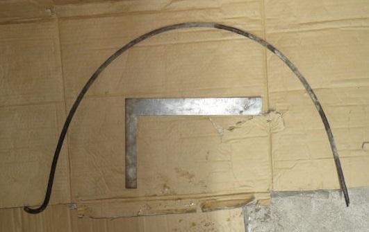

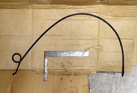

Don Shears Posted December 28, 2018 Share Posted December 28, 2018 I haven't used files for fire steels. Instead I use (horse drawn) dump rake tines for making both fire steels and small knives/letter openers. Junk yard steel chart lists them as 1090. Can draw decent sparks using chert after a quench in water from orange heat and no tempering. But having read dickb's post, go with the magnet test (more accurate then eye) and quench. Attached are a couple of images. The tines are 5/16 inch dia. Styles obviously differ with manufacturer. The square is 12 inches on the outside of the long arm. Link to comment Share on other sites More sharing options...
