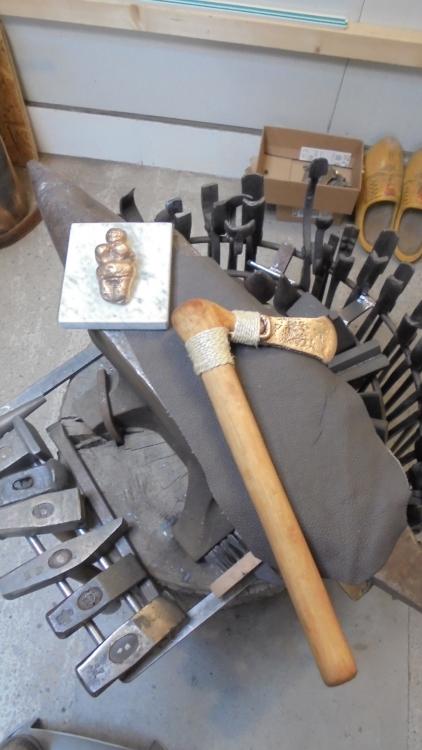

Hans Richter Posted June 19, 2018 Share Posted June 19, 2018 As long as the epoxy is hidden and not visible I will use it. Have problems with my heel axes to attach them to the wooden knot handles (shrinking). As long as I’m not able to extract (get) birch resin. Quote Link to comment Share on other sites More sharing options...

Cavpilot2k Posted June 20, 2018 Share Posted June 20, 2018 21 hours ago, Hans Richter said: As long as the epoxy is hidden and not visible I will use it. Have problems with my heel axes to attach them to the wooden knot handles (shrinking). As long as I’m not able to extract (get) birch resin. Quote trimmed You just happen to have a replica of the Venus of Willendorf on your anvil? lol Quote Link to comment Share on other sites More sharing options...
ThomasPowers Posted June 20, 2018 Share Posted June 20, 2018 You mean you don't?!?!?! How very odd We have folks here forging skulls, moai, elephants, fish, birds why not a *seriously* historic piece? (I remember if from a previous casting pic---but you don't need to work harden sculpture like a bronze blade or palstave) Quote Link to comment Share on other sites More sharing options...
