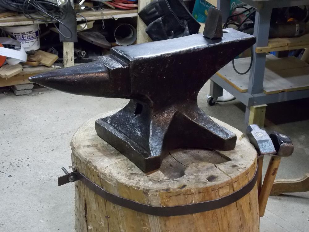

MC Hammer Posted June 6, 2018 Share Posted June 6, 2018 Get the heaviest anvil you can afford. I'm not sure a 100# anvil will cure your thumping as it's only 25 more pounds. 150 #er is a good size. My anvil situation went from a 75 # anvil to a 179 # anvil, so that was 100 pound addition. I also have a larger stump pictured below. Here's another picture that shows the old outline of the smaller anvil routered out on the top of the stump with the new anvil over it - see why the thump went away? Big difference in size! Quote Link to comment Share on other sites More sharing options...

MC Hammer Posted June 7, 2018 Share Posted June 7, 2018 Glen makes some good points. It sounds like money is an issue. What I did is came up with a budget for an anvil. If you have an absolute number as to how high you can go it will narrow things down. If you can afford a new anvil, that's the way to go but most can't. I think when you have a limited budget that you can buy more anvil for your money buying an old anvil. The one I pictured above cost me $300 but the equivalent pound anvil new would cost from $875 - $1,400. If I spent my $300 on a new anvil I'd have only been able to afford a 44# - 70# anvil on Centaur Forge. Sure, my anvil has some chipping on the edges and other cosmetic issues but it moves metal just fine. It's also a risk that my anvil could develop a problem like a cracked face plate or something, but still I'm only out $300. Yes your new anvil will last forever most likely if you have the money to go that route. It is a lifetime investment. Quote Link to comment Share on other sites More sharing options...
