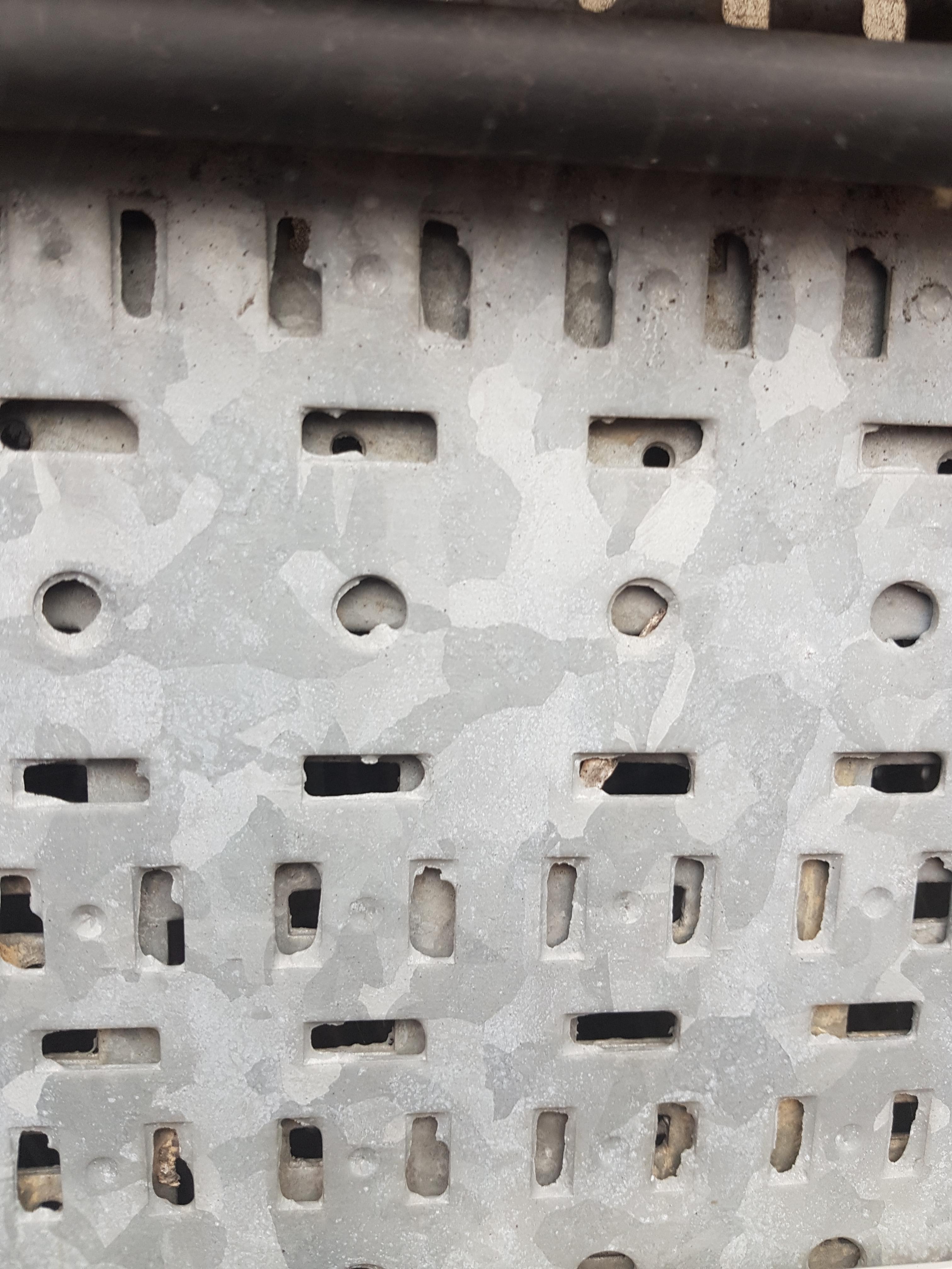

Tyler Cech Posted October 3, 2018 Author Share Posted October 3, 2018 Alright I’m back and I have finally created a forge, problem is the red cart I want able to use (I broke it) but I came across an old grill that was free at the end of my road. It’s filled with gravel as you can see and I used fire bricks rated for 2700 degrees Fahrenheit and a couple of red bricks for different spots. I decided todo this because I did not know how easy it would be to get hardened Clay out of a grill in case I wanted to change the design. My bellows is an old squirrel cage fan I pulled out of my barn. I rigged up a switch to the board it is screwed into to get airti the pipe so I can shut it off from the board. Blows through charcoal like crazy any better design? (I know similar answers are posted in other places in IFI which I have read just figured I would add this in) My anvil is not ideal but it did the trick for my first knife (knife looking object, a blank?) I haven’t hardened it or sharpened it I was gonna do that today but it was raining and there is no ideal space in my garage. Here are the pictures give me your suggestions in brick layout and over all design. I’ll hopefully get more and better pictures and videos in if needed thanks! 16FA6291-4FA2-4A1A-BFB1-DD567C83EED9.mov file Quote Link to comment Share on other sites More sharing options...

JHCC Posted October 4, 2018 Share Posted October 4, 2018 If that pipe is galvanized, get it out of your forge NOW. Zinc oxide fumes are REALLY bad for your health. Black iron pipe is definitely the way to go. You're headed in the right direction. Keep at it. Quote Link to comment Share on other sites More sharing options...
Tyler Cech Posted October 4, 2018 Author Share Posted October 4, 2018 (edited) How do you tell it steel is galvanized, I know what it means to have steel galvanized but how do you tell? Zinc is nasty stuff and I read some threads on IFI sounds like it’s not a good idea to use galvanized. Hopefully this picture will help you tell. Edited October 4, 2018 by Mod34 Excessive quoting removed. Please read the post on proper use of the quote feature. Quote Link to comment Share on other sites More sharing options...
Irondragon Forge ClayWorks Posted October 4, 2018 Share Posted October 4, 2018 It looks like it was once galvanized and has wear in spots. To be safe soak it in vinegar for a day or so then rinse it with baking soda & water to neutralize it. The zinc galvanization will be taken off. Quote Link to comment Share on other sites More sharing options...

Dax Hewitt Posted October 5, 2018 Share Posted October 5, 2018 Galve steel has a dull gray colour to it. It's quite distinctive if you know what you are looking it. Sheets of it like in the attached photo would typically have a pattern to it but pipes and smaller items don't tend to but the colour is a dead giveaway. Quote Link to comment Share on other sites More sharing options...
JHCC Posted October 5, 2018 Share Posted October 5, 2018 On a side note, the mottled pattern we see on galvanized steel is from the growth of zinc crystals as the melted coating cools. It's the same grain growth phenomenon that needs to be controlled in the heat treatment of steel, but larger and more visible. Quote Link to comment Share on other sites More sharing options...
