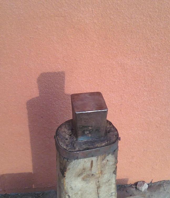

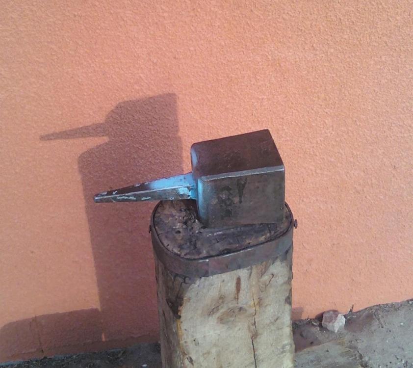

Question are you hunting for a blacksmith or for a blacksmith using early medieval tools materials and processes?  I don't know if your smithing research has advanced enough so that you have learned that the fuel the smiths generally used changed from real charcoal to coal in the High to Late Middle ages and the metal they forged changed with the move from the bloomery process to the indirect process to the Bessemer/Kelly process and subsequent processes.  So almost all modern blacksmiths do not work  anything like early medieval ones do. (What I am getting at is the differences between riding cross country in a Conestoga wagon pulled by Oxen from St Louis to Oregon and riding in a SUV on the Interstates; one teaches you a lot more about the original conditions than the other does...)
For example: here is a modern reproduction of an early medieval style anvil: Y1Kanvil1.thumb.jpg.b1c1b2a611888e39c401ab638223ad36.jpgY1Kanvil2.jpg..thumb.jpg.c4e903115e291b798db19aa5f5e5fccd.jpg
