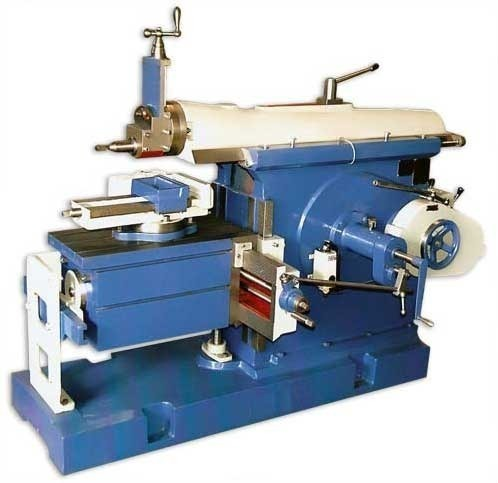

BIGGUNDOCTOR Posted May 9, 2018 Share Posted May 9, 2018 A shaper is great for large dovetails and the tooling is far less expensive then a dovetail cutter. See if someone in the area has one. Quote Link to comment Share on other sites More sharing options...

BIGGUNDOCTOR Posted May 28, 2018 Share Posted May 28, 2018 A 5mm endmil will have some flex and take awhile to mill that out. You said you have a shaper, that is the tool I would use. Much faster and it can hog a dovetail faster the the mill can. A custom carbide cutter would be very expensive and they are also very brittle. We used solid carbide custom cutters that we ground in house at the last shop I worked at. Quote Link to comment Share on other sites More sharing options...
MikeAlmogy Posted May 28, 2018 Author Share Posted May 28, 2018 Thanks. Not sure what shaper is, google show me machines similar to the one i got. I did bought this. https://www.ebay.com/itm/MZG-BAP300RC20-20-150-2T-CNC-Cutting-Shoulder-Right-Angle-Milling-Cutter-Shank/282761918601?ssPageName=STRK%3AMEBIDX%3AIT&_trksid=p2057872.m2749.l2649 The 5mm is just to finish things up. Quote Link to comment Share on other sites More sharing options...
BIGGUNDOCTOR Posted May 28, 2018 Share Posted May 28, 2018 A shaper is the machine I posted the picture of above in another reply. Quote Link to comment Share on other sites More sharing options...
ThomasPowers Posted May 28, 2018 Share Posted May 28, 2018 Wood shapers and metal shapers are completely different machines! So be careful when you go a looking...I found good pics with: metal shaper images and wood shaper images. Wood shaper spins a cutting bit, more like a router bit ; metal shaper uses a reciprocating bit, one more like a metal lathe bit. Quote Link to comment Share on other sites More sharing options...
