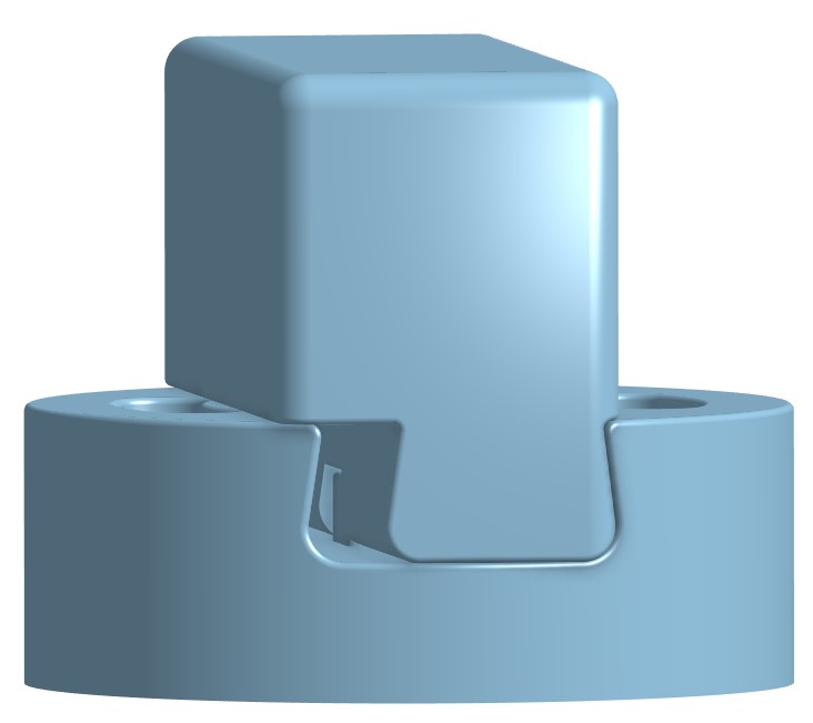

Thanks. Not sure what shaper is, google show me machines similar to the one i got. I did bought this. https://www.ebay.com/itm/MZG-BAP300RC20-20-150-2T-CNC-Cutting-Shoulder-Right-Angle-Milling-Cutter-Shank/282761918601?ssPageName=STRK%3AMEBIDX%3AIT&_trksid=p2057872.m2749.l2649 The 5mm is just to finish things up.

Thanks :-) i do not have to use a costume cutter since i can tilt my mill head to the desire angle and simply use a 5mm round tip strait cutter. Anyway, my shop is under construction at the moment so it will take some time for me to start this project (unless i will be impatience). I need to do some testing before using my high carbon steel.

all my dies will have the same size of dovetail. To be honest, still not sure if it is the right solution for me, depend on my milling skills and equipment.

Thanks, but wouldn't be easier and more accurate to have one side as a fixed plane?

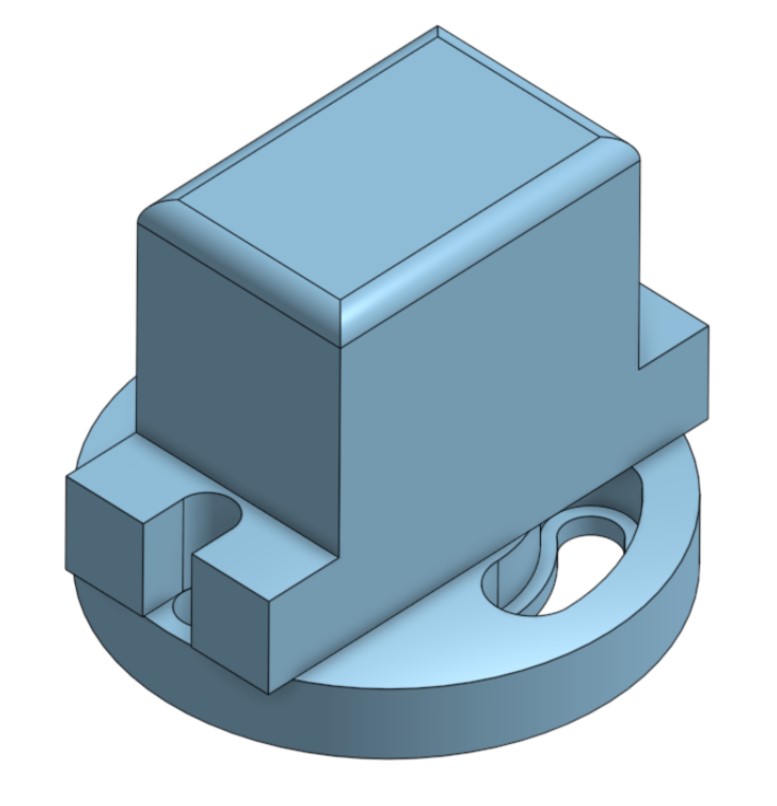

Ok so the current design is like that: https://cad.onshape.com/documents/51d01ae92d7a3e5cd68f072f/w/06030eb301b2a85f5e94cc35/e/541a3603b80252226048a305 What do you think? it has 10mm wedge.

It will have tooling of it's own but i do like the idea of unify tooling or at least concepts. not sure it is the right word. Anyway, for now it looks like dovetail won. I just need to figure out the angles and technique to actually do it. I thought that i got the right machinery to do it (I got Schaublin 13 mill) and i need a 5mm cutter to do the final angle cut. I also need to know the angle of the dovetail but in worst case i will use 10 degree angle. Thanks, Mike

yes sure studs. Well i'm not sure yet what to do. still thinking of it. The whole idea is to unify my die for power hammer and hydraulic press (which i did not built yet). The power hammer is small. about max 20kg. The press however is the biggest i can build, hopefully 50 metric tons.

I got one. I have a mill. The question now is if to do dovetail or bolts like i posted earlier.

Ok so do you think this design is better? no dovetail, bolts only. however the option to rotate the die is limited

Hi all. Here is my design for my power hammer (Ron Kenyon simple air hammer with Larry Zoeller modifications) die. At the moment it is just the base but i run into a little problem/dilemma. https://cad.onshape.com/documents/e3c54a90c5026613737eea49/w/3c2b0ea84d0f4dc883b1228e/e/9e5e7e7e4e0c0513d97797a9 The problem is with the dovetail. Currently i'm using a 50mm diameter, 20mm~ height, 60 degree, dovetail cutter. However, it's angle is way more steep then the angle i see on other power hammers die and bases (ram and anvil). It is very easy to use the dovetail i got since i only have to use one tool to do it and it is pretty fair and simple. However, i'm not sure that it is the right thing to do. How can i cut the base and die dovetail? i do not see any specific tool to do it. The die itself is relatively easy and in the "worst" case i can do it in two parts, one for the dovetail and other for the head itself with the die design. But the base is hard. I can tilt the head of the mill to cut an angle but i will have residual marking and grooves on the base of the dovetail, which i think is not very good. Any idea? Thanks, Mike
