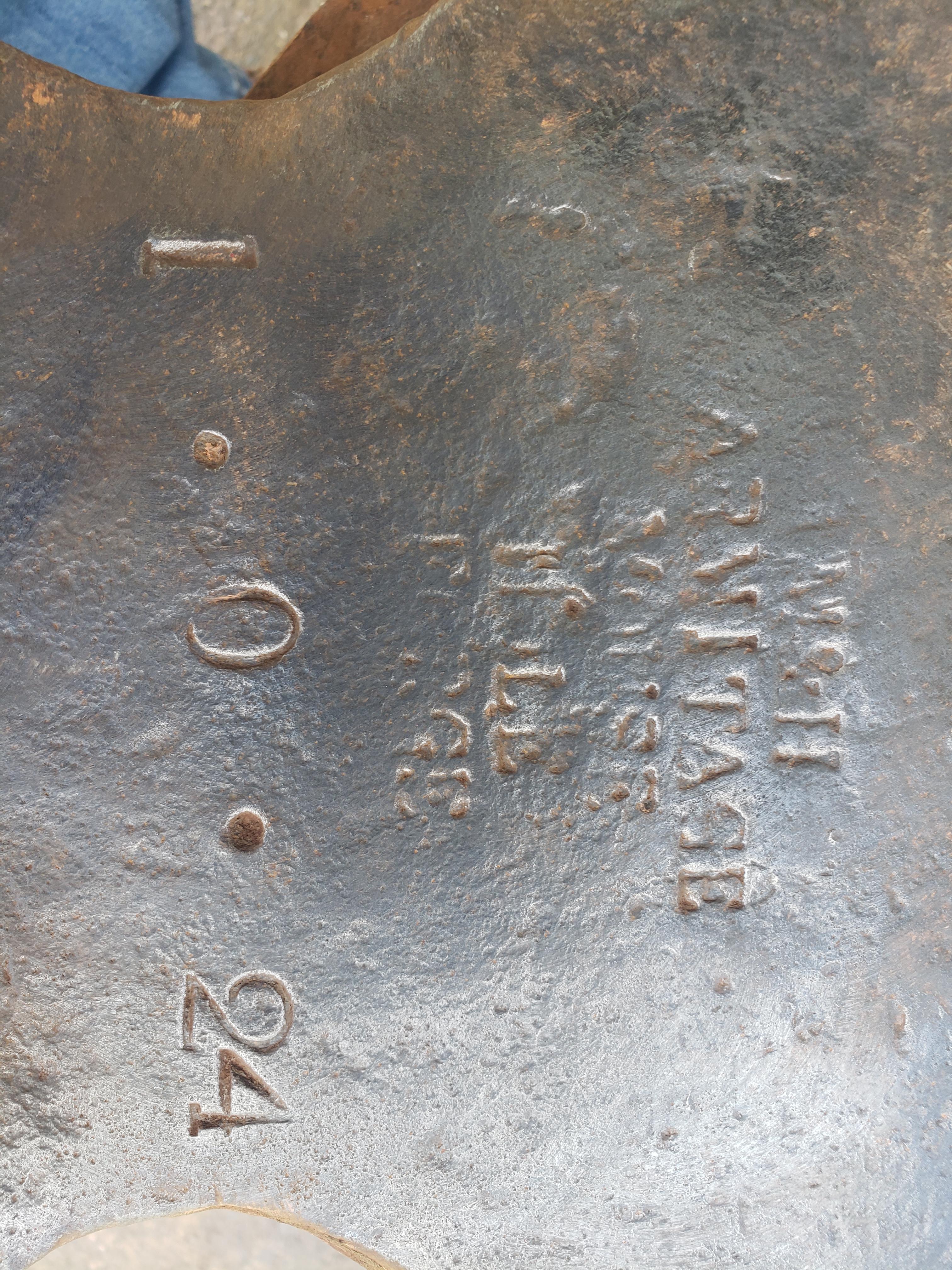

I was gifted this Armitage anvil last weekend. The top face is pretty beat up, but I'll try using it and see how it does. Also had a hardy tool shank stuck in it that I punched out after letting it sit overnight with penetrating oil. Markings appear to me to be M&H .... Armitage.... Mouse .....1-0-16 -- so 128 lbs?
I don't have access to the Mousehole book - can anyone give me an approximate age guess?

If the stamping reads, "M&H Armitage Mouse Hole", these anvil were made from about 1820 to 1835.
Mr. Postman records at least 12 different variations of maker marks on Mouse Hole anvils.
Consider also that Mousehole started adding pritchel holes around 1830. If there's a slight bulging around the hole on the underside of the anvil, then it was punched as part of the manufacturing process; that means your anvil is roughly 1830-1835. If there is no bulging, then the anvil was probably retrofitted with a drilled pritchel hole and is probably 1820-830.
Still a good bit of useful life in that anvil if it isn't delaminating further on the faceplate. Yes, use it as is.

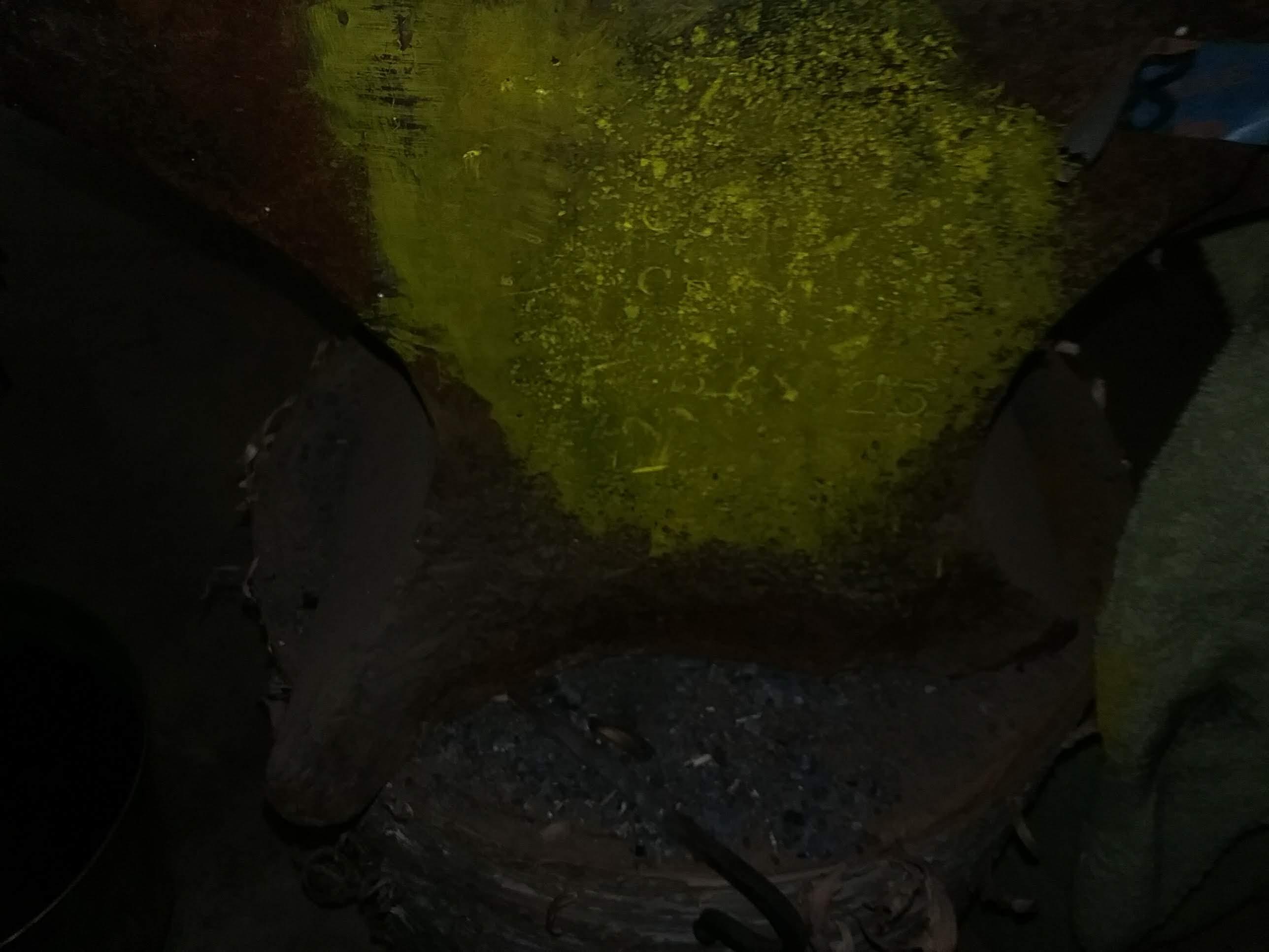

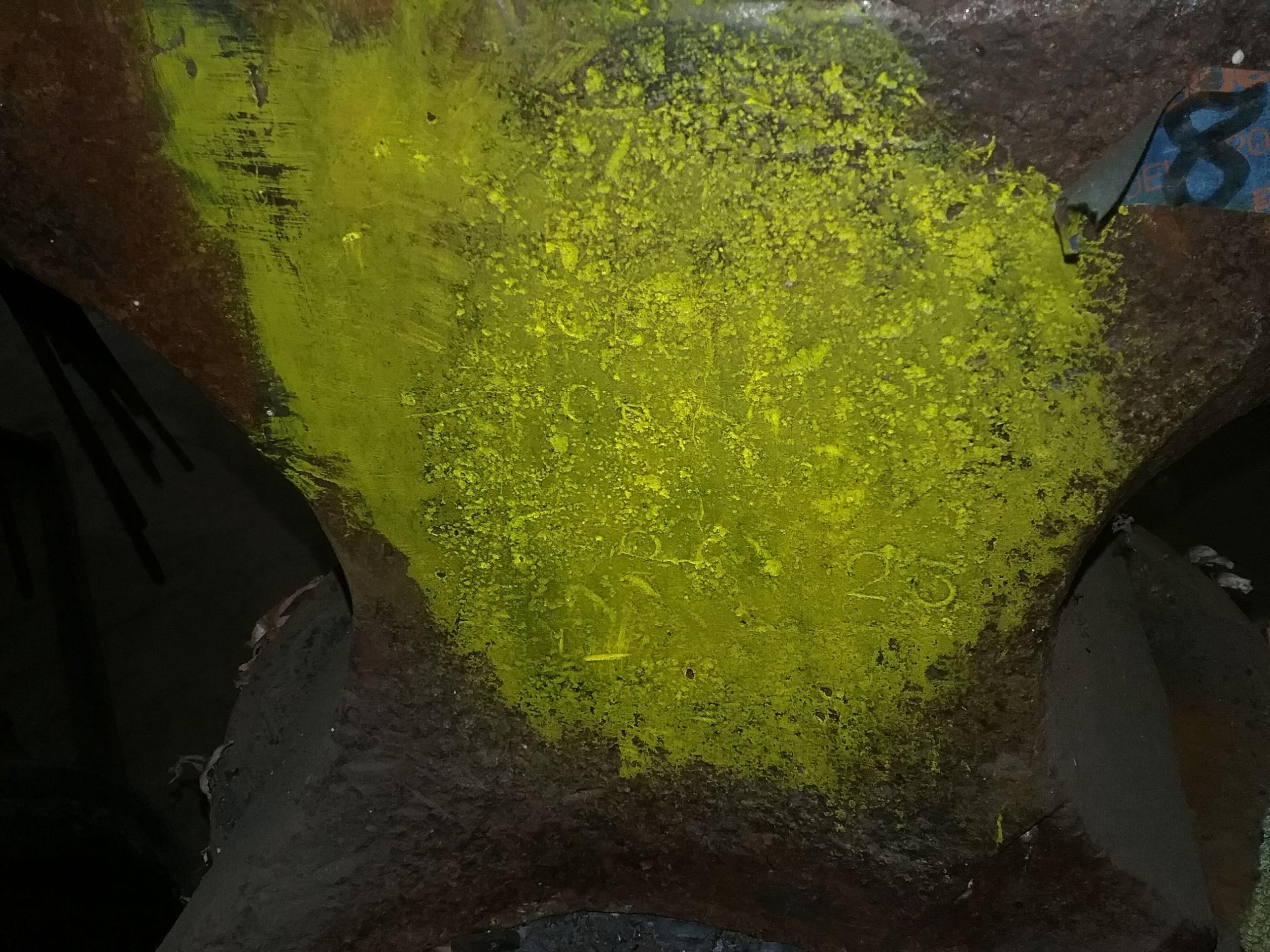

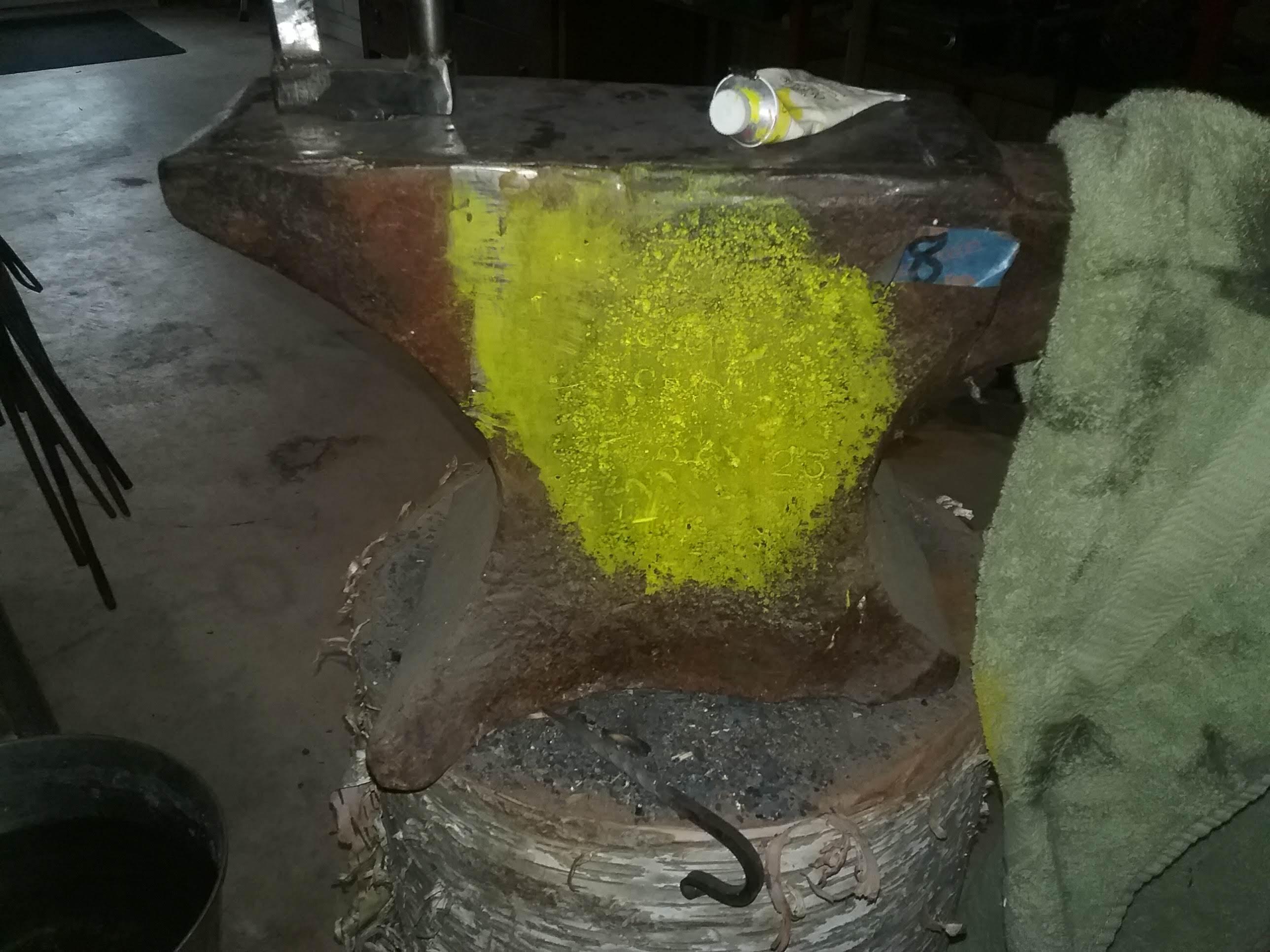

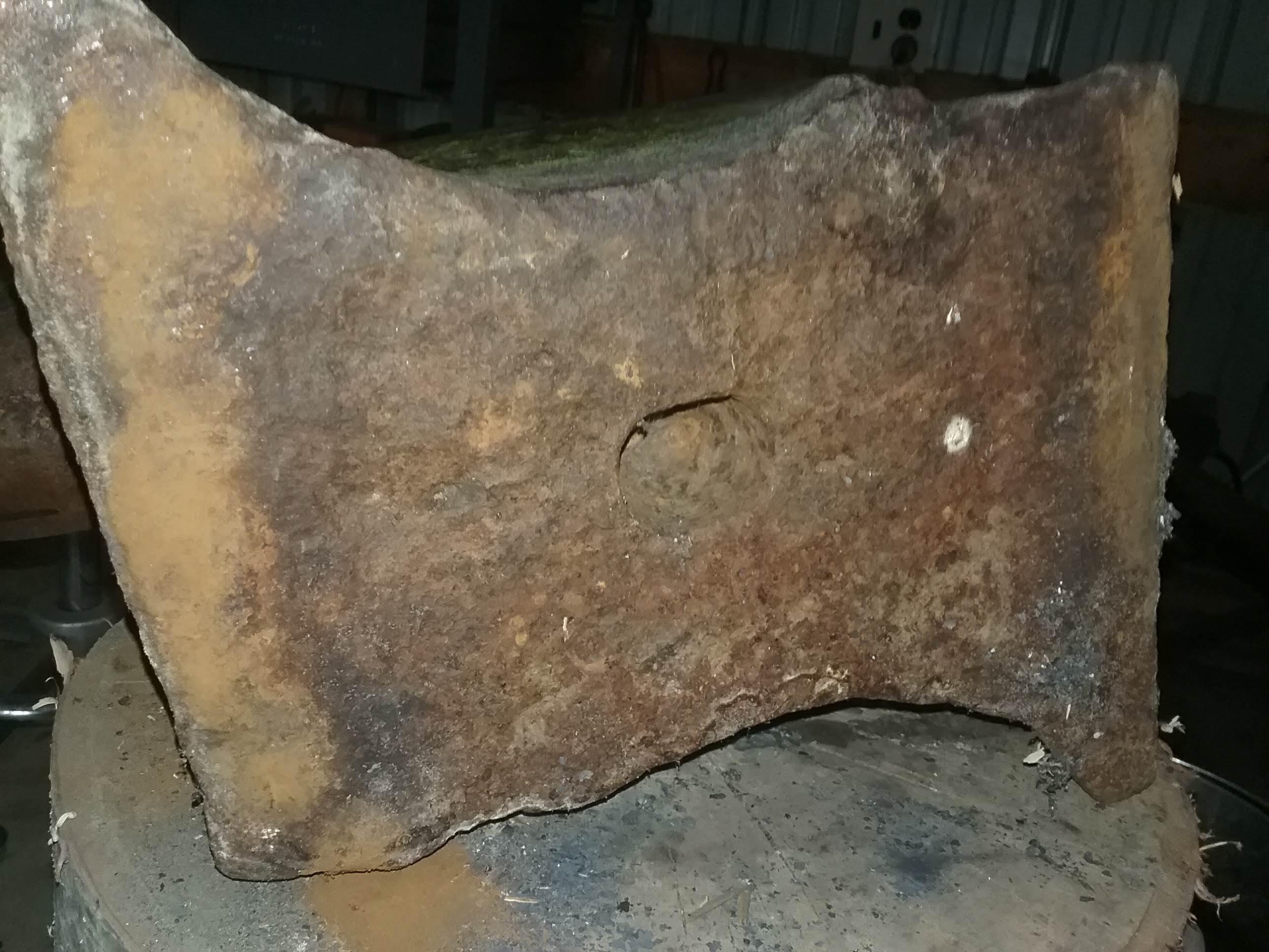

I have what I believe is a mouse hole anvil, it was found in pieces and I put it back together and it is a great anvil with good ring /rebound. I have been using it for years and just discovered some markings and would like any info I can find on it. I have used many anvils and this is a good one just a little ugly'
Welcome aboard Metal 1905, glad to have you. If you'll put your general location in the header you might be surprised how many members live within visiting distance.
If you wipe the yellow stuff off surface it'll make stamped characters and features like  LOGO stand out. Right now it's blending everything together too much to read well. Oblique lighting when you shoot pictures will help make textures stand out better as well. That's light from a low angle to one side. Direct lighting like a flash reflect straight back and glare out details of texture.
What's that old lady weigh? From what I can see the face looks to be in good condition with only minor chipping on the edges. Can't see the horn through the rag though. Mounting it on a birch block looks very Alaskan, it's about our only hardwood of any size.
I'm in the north branch part of Mich, the hardy hole end was broke off and most of the horn missing, the only parts I couldn't put back on was the two missing feet. If you blow up the pictures you will see the little bit of marks, so much pitting I removed the yellow a little at a time but no luck. I can see from the pictures the stone weight (Some of it) and two or three letters, she is 178 lbs set on a bath scale.

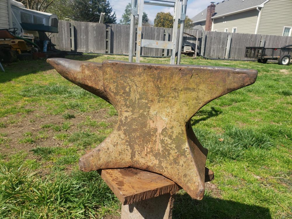

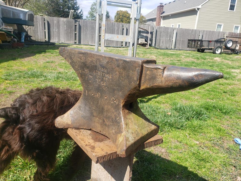

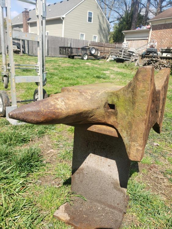

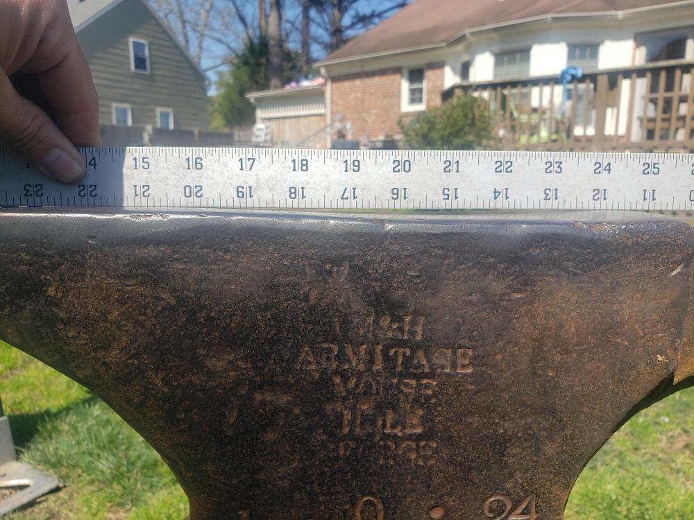

Good day, new to the site and hobby, been reading about it for years. Ran across this Mouse Hole this morning. I think it is a good purchase but wanted to run it by you guys. For what I have read and watched it seems to be in really good condition. It has what I think to be good rebound.
What is the percentage rebound when doing the ball bearing test?  You don't need to guess; it's an objective number!
That type of anvil should have a ring when tapped.  Does it?
How thick is the face plate? Any signs of grinding or welding on it?
Stamped weight is 136 pounds.
Not knowing the price and the location makes it hard to tell if it's a good purchase or not.
I have a 136# mousehole also, not as good shape as yours looks, but it works great. If the rebound is good you have an excellent anvil. Remember not to grind the face, just take a wire brush to it and give it a coat of BLO (boiled linseed oil) Check the rebound with a ball bearing dropped in front of a ruler from 10" to get % of rebound.
The face seems to be about 5/16 thick, the ring is deafening,  no grinding or welding and the belly (?) Is only about 1/16".
I am in Virginia Beach area and paid $400 for it.
I unfortunately can't find my ball bearing.
The scale weight is 132#20200319_134129.thumb.jpg.a5b99b85088c857357b9b834817cebb9.jpg
US$3 a pound.  Well within tolerance and actually on the "good deal" side of things.   Well Done!
