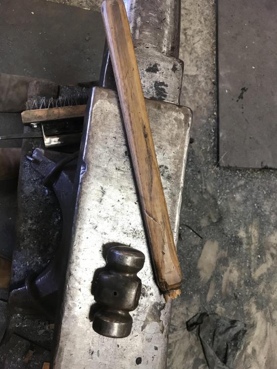

Ranchmanben Posted April 11, 2018 Share Posted April 11, 2018 Always scary when your hammer head comes off on your back swing. Quote Link to comment Share on other sites More sharing options...
JHCC Posted April 11, 2018 Share Posted April 11, 2018 Or on the downswing. Quote Link to comment Share on other sites More sharing options...
Ranchmanben Posted April 11, 2018 Share Posted April 11, 2018 22 hours ago, JHCC said: Or on the downswing. Ha! Good times. I went full rabbit this time. I was in the middle of drifting a hole and, uncharacteristicly, completely froze up not knowing where it was going to come down. Landed a few feet behind me. So when do we show off our new handles? Quote Link to comment Share on other sites More sharing options...

jlpservicesinc Posted April 11, 2018 Share Posted April 11, 2018 JHCC and Rancherman, while those are very nice looking hammers.. I keep seeing the same problem with the forging and handle fitting.. In a previous post someone showed a handle snapped at the head.. (Rancherman) This type of failure on a new handle is simply because the hole is to small And/or the fitting of the handle leaves that sharp demarcation between the handle and head.. Completely remove the wood to form a straight and flexible shaft below the head or make the hole in the hammer larger to accept the handle with no obtuse handle angle.. The area of the handle leading into the head has to be spread over a longer gradient.. With this type of design the head/handle will fail prematurely.. There is a ratio of punched hole size in hammer heads to handle diameter.. It became a common sense thing over the years, but it seems it has never been mentioned in any of the information I have seen on any of the BB or AS videos.. No offense to anybody but the ratio for maximum life in the hammer to handle IIRC is like 1.7.. I can't remember the exact ratio but for some reason this comes up as the first guess.. Might be 1.2-1.7.. Quote Link to comment Share on other sites More sharing options...
JHCC Posted April 11, 2018 Share Posted April 11, 2018 The square shoulder on the original handle was definitely a problem, and that’s been eliminated on the new. While I like the looks of the swelling below the hammer head, thinning that part out to distribute the stresses makes sense. I’m away on a business trip for the next couple of days, but I’ll take another look when I get home. Quote Link to comment Share on other sites More sharing options...
Marc1 Posted April 11, 2018 Share Posted April 11, 2018 Am I seeing things or are both eyes in those hammers too small? Oh ... I see ... didn't read the answer above. Short of forging the hammer again, (bad idea) an air driven die grinder would take good care of opening that eye up. Quote Link to comment Share on other sites More sharing options...
JHCC Posted April 11, 2018 Share Posted April 11, 2018 Mine's certainly on the small side. If thinning the handle doesn't help, I'll have to think about what to do next. Reforging the head would be possible, I suppose, but maybe enlarging the hole with a die grinder or filing (which would presumably necessitate annealing before and rehardening after) would work. Quote Link to comment Share on other sites More sharing options...
jlpservicesinc Posted April 11, 2018 Share Posted April 11, 2018 Die grinders work great either with a stone (hardened steel) or a burr for unhardened eyes.. I don't want to be nit picky but I always leave my eyes soft.. I only harden both ends.. FYI, there is a ratio for the part receiving the handle and there is also a ratio for where the wedge or top side of the handle.. This might be where I'm getting the 1.2 from.. It's been many years since I was involved with this and I will be at some point doing a Hammer making video and it will explain it in depth.. But for the time being here is a picture.. The ratios were based on my preferred hammer handle cross section.. Today I prefer a more evenly lengthed handle than the bulbous handles with lots of curves.. A full tapered handle works as well. Retangular with hard edges removed.. The french and swedish hammers are here to show what i definitely do NOT like.. Icky.. My 4lbs you can see the handle to head transition is nearly straight.. And then my 2lbs which the handle is nearly 30 years old and loose but has yet to come off.. LOL.. I am not a fan of having a Does foot or any foot on my hammer handles.. I can feel where the ends are by size and if my hands are that tired that I can grip the hammer, I just grab a smaller hammer.. The monster straight peen which I use in the Hinge series is nearly straight with no taper.. And lastly.. The taper at the top of the head if you get much above the 1.2 ratio the wood has a hard time expanding enough to fill the void leading to loose handles.. It's a mistake I made on the 2lbs hammer so handles while they don't break loosen up very quickly.. Every hammer I have ever bought I have redressed the eyes on.. There is also a side taper which is slightly less than front to back taper.. I also experiemented with Depth of taper and about 50% of head depth is about correct.. for a sq cross section like the regular hammers.. The squashed center sections are done that way to increase the amount of handle contact with the wood thus offering more support for the heads.. This 50% ratio for from bottom to top then increases from the bottom to 60 or even 70% up maintaining that 1.2-1.7 ratio.. This increases the amount of hammer handle surface area and transition to be made longer and stronger for a given handle size.. Quote Link to comment Share on other sites More sharing options...
Ranchmanben Posted April 11, 2018 Share Posted April 11, 2018 I’ve noticed that most farrier style rounding hammers, my go to, have smallish hammer eyes. Not sure why that is. This two pound is my primary hammer. I got 4ish years out of this handle and accidently backed over it with a tracked skid steer once about 6 months ago. It might be unacceble for some but I’m pleased with the time I got out of that handle. Quote Link to comment Share on other sites More sharing options...
