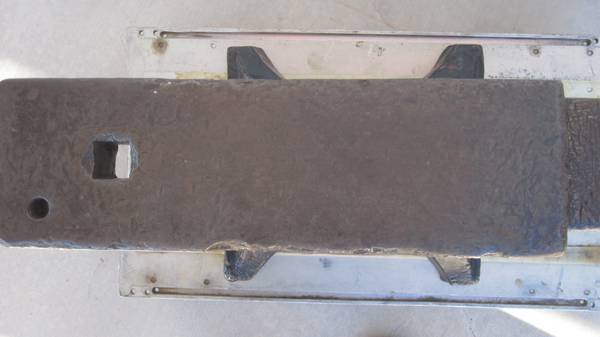

Black bear 89 Posted April 10, 2018 Share Posted April 10, 2018 Found a hey budden 235 pound Anvil in my area asking price is 1600 have not looked at it in person but seems to be in good condition is this a fair price and is the tool steel separating from the wrought iron a concern when it’s tooled from the waist up? Quote Link to comment Share on other sites More sharing options...

Black bear 89 Posted April 10, 2018 Author Share Posted April 10, 2018 I’m in Arizona and this is the first time I’ve ever seen the genuine article in my area aside from the rebound test is there anything else I should look for ? Quote Link to comment Share on other sites More sharing options...
Daswulf Posted April 10, 2018 Share Posted April 10, 2018 That looks like a wrought iron body with just a steel faceplate. I have a Hay Budden with the full steel above the waist. That's not one. You will usually see a weld around the waist usually ground down but evident and no signs of a face plate. So what do you mean by separating steel from the wrought? That's a major concern and I'd pass. I'd pass at that price alone anywhere around my area of the world. Quote Link to comment Share on other sites More sharing options...

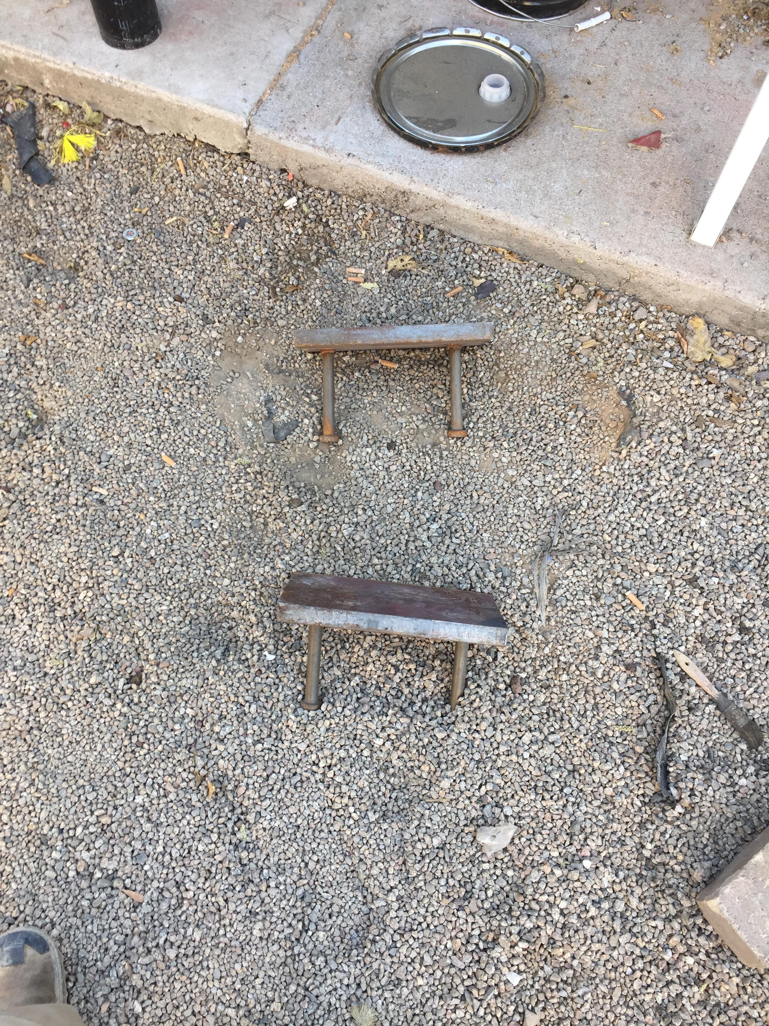

Black bear 89 Posted April 10, 2018 Author Share Posted April 10, 2018 Well I do have these 12 x 8 x 1” in beds I was going to set in 2 12 x8x8 masonry columns and this old POS but I’ve always been limited and really want to start some bigger projects just built my first real forage And I’m eager to undertake some larger projects Quote Link to comment Share on other sites More sharing options...

Black bear 89 Posted April 10, 2018 Author Share Posted April 10, 2018 41 minutes ago, Daswulf said: That looks like a wrought iron body with just a steel faceplate. I have a Hay Budden with the full steel above the waist. That's not one. You will usually see a weld around the waist usually ground down but evident and no signs of a face plate. So what do you mean by separating steel from the wrought? That's a major concern and I'd pass. I'd pass at that price alone anywhere around my area of the world. Well I have no experience in identifying these kinds of things but it appeared to me that there was a textured change at The waist which I thought was where the wrought iron was forage welded to the steel 45 minutes ago, ThomasPowers said: So any luck when you asked around the Arizona Artist Blacksmith Association? I am not a member don’t you have to pay dues or buy a membership? 27 minutes ago, ThomasPowers said: Stop by and I'll tell you how to get to a scrapyard selling large chunks for 20 US cents a pound. (up to a 40000 pound piece of a scrapped navel gun!) Or you could ask the local smiths where you can find something big to hammer on. Where are you located? Quote Link to comment Share on other sites More sharing options...

Daswulf Posted April 10, 2018 Share Posted April 10, 2018 1 hour ago, Black bear 89 said: Well I have no experience in identifying these kinds of things but it appeared to me that there was a textured change at The waist which I thought was where the wrought iron was forage welded to the steel We do and that's why I mentioned it. Yeah there is a bit of a changeover there but it's not the typical weld you will see with one welded at the waist. And if it were showing something like that (with a faceplate And weld at the waist) is showing Id be very skeptical, as in it broke at the waist and was welded back together. ( I have seen it) We are trying to help you out, not beat you up. 46 minutes ago, JHCC said: 1 hour ago, Black bear 89 said: Where are you located? If you look right under his profile picture, you'll see his location Actually on my mobile version it doesn't show. But, if you click their name it shows up in their profile if added. An anvil was listed, and asked about , today in my area. $1075 for a 270lb Hay Budden in better "looking" shape then this one( since I don't know about the ring and rebound of either). Hah, I could buy that one, ship it to you and still turn a profit. ( but I won't) keep looking. Head to a scrap yard, milling shop, fab shop.... And see what else you can find cheap. Or buy new or keep looking. That price is way too high. My max is $2. Lb. my reasonable side says a Max of $4.lb in great shape or you are better off buying new, if you need it. Quote Link to comment Share on other sites More sharing options...

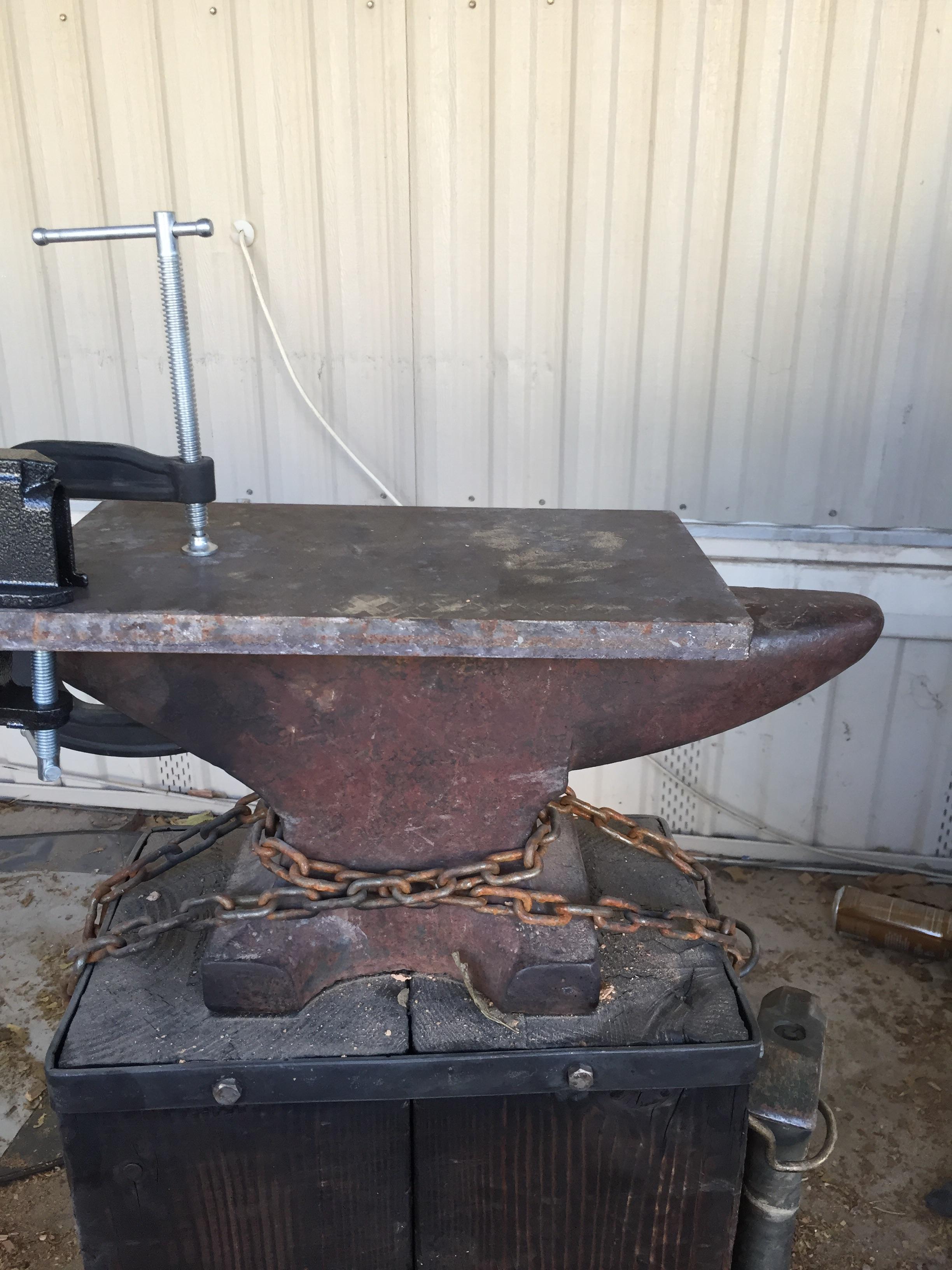

Frosty Posted April 10, 2018 Share Posted April 10, 2018 Just laying a steel plate on a cast iron Anvil Shaped Object (ASO) will actually make it a worse anvil. The face must be solidly coupled (welded to) the anvil's body or a huge % of the energy delivered by the hammer gets absorbed in the transition. Too much for that anvil for sure. Frosty The Lucky. Quote Link to comment Share on other sites More sharing options...

jlpservicesinc Posted April 15, 2018 Share Posted April 15, 2018 From the pic it looks like a 2nd gen.. Anvils and pricing becomes how much is it worth to you.. 1600.00 is brand new anvil territory.. 275 Peddinghaus/Rigid delivered to your door is possible for that kind of coin.. As mentioned there are a lot of avenues out there.. With London pattern anvils there is such a thing of the anvil being to large to work on certain sized pieces and this means have to make large hardie tools to get that smaller work surface.. Double horn anvils offer 2 to 4X the work surfaces depending on which model you get.. side shelf, upsetting block, conical horn, vs smooth horn.. Etc etc.. Quote Link to comment Share on other sites More sharing options...
