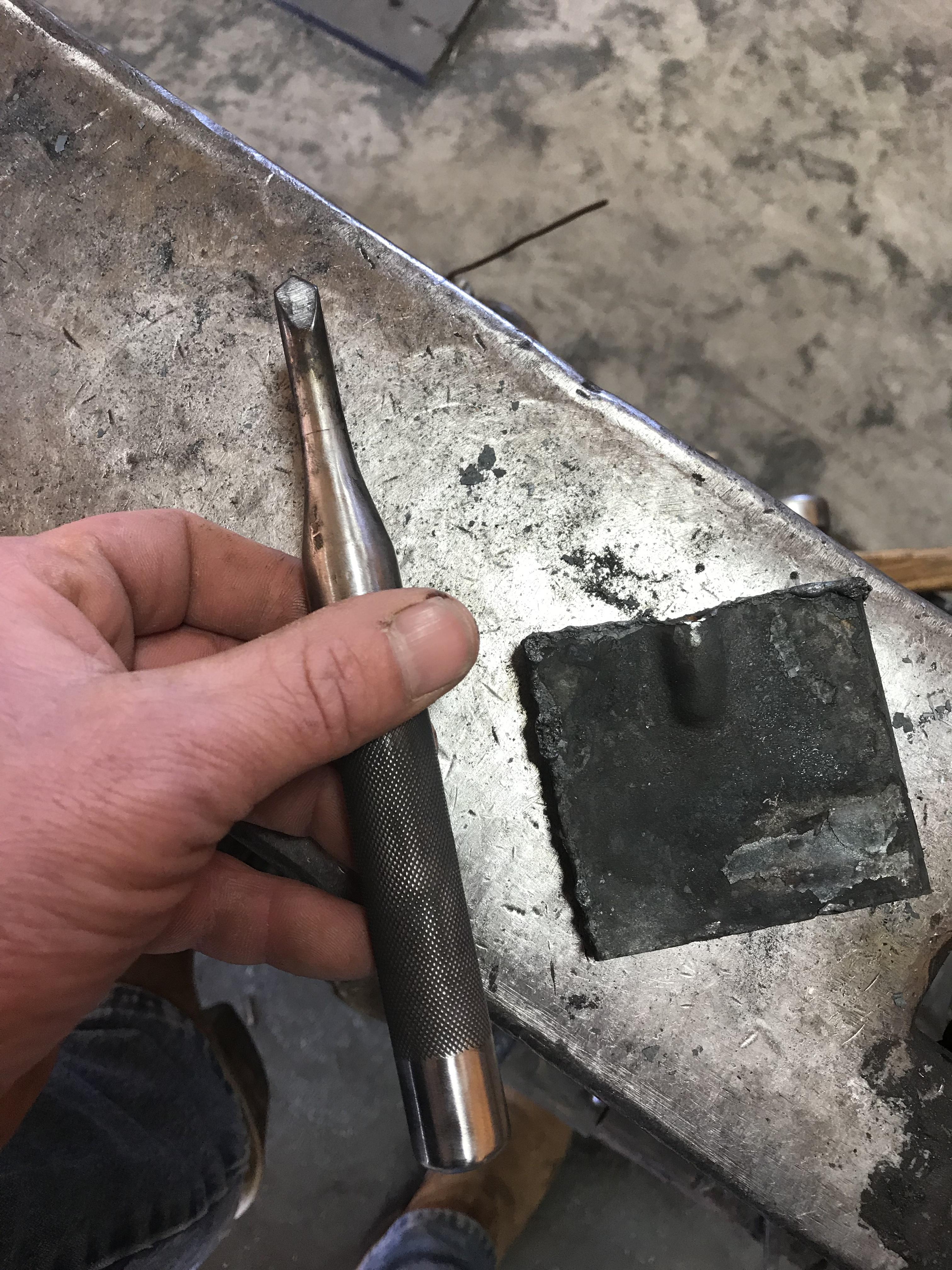

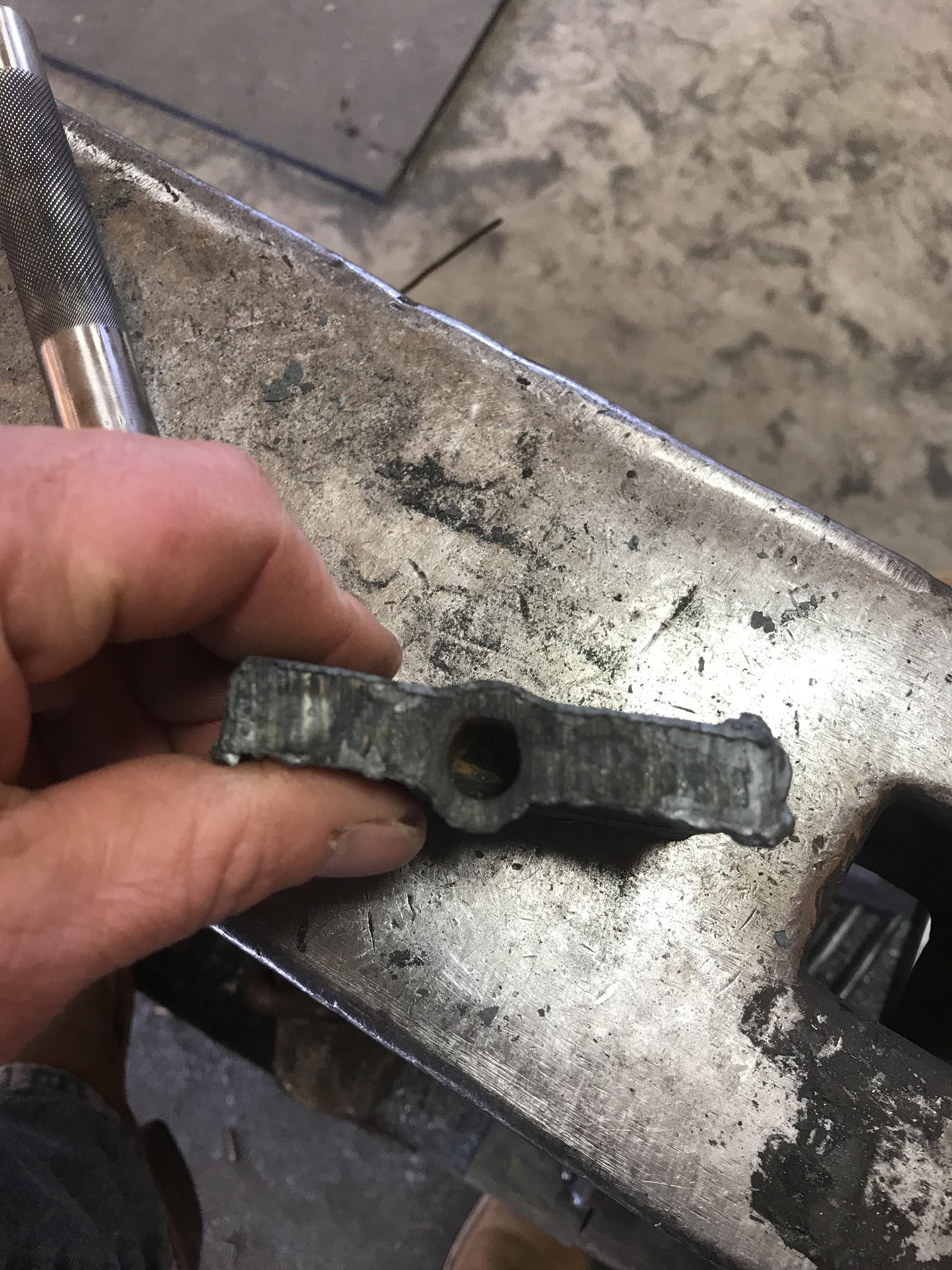

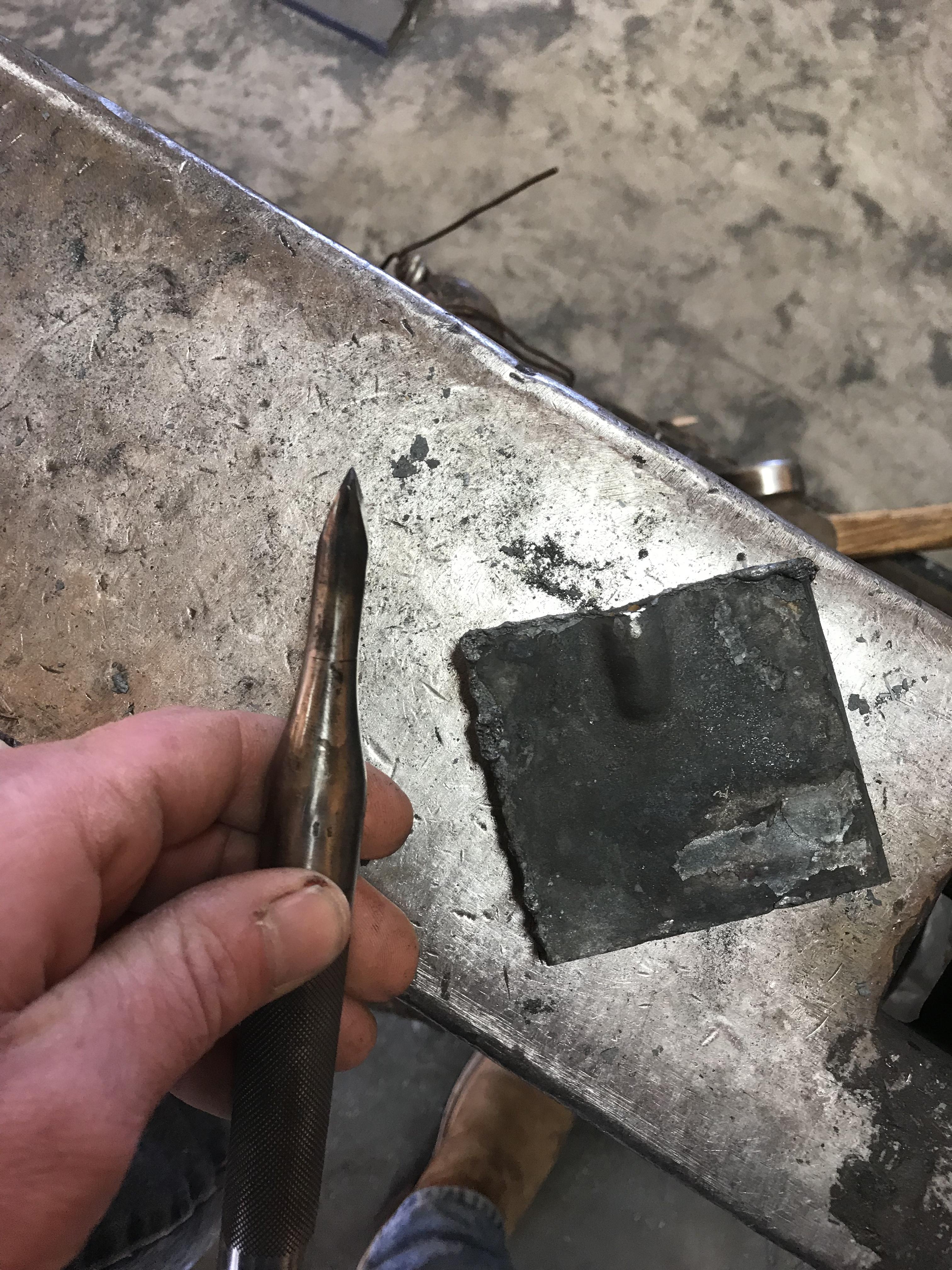

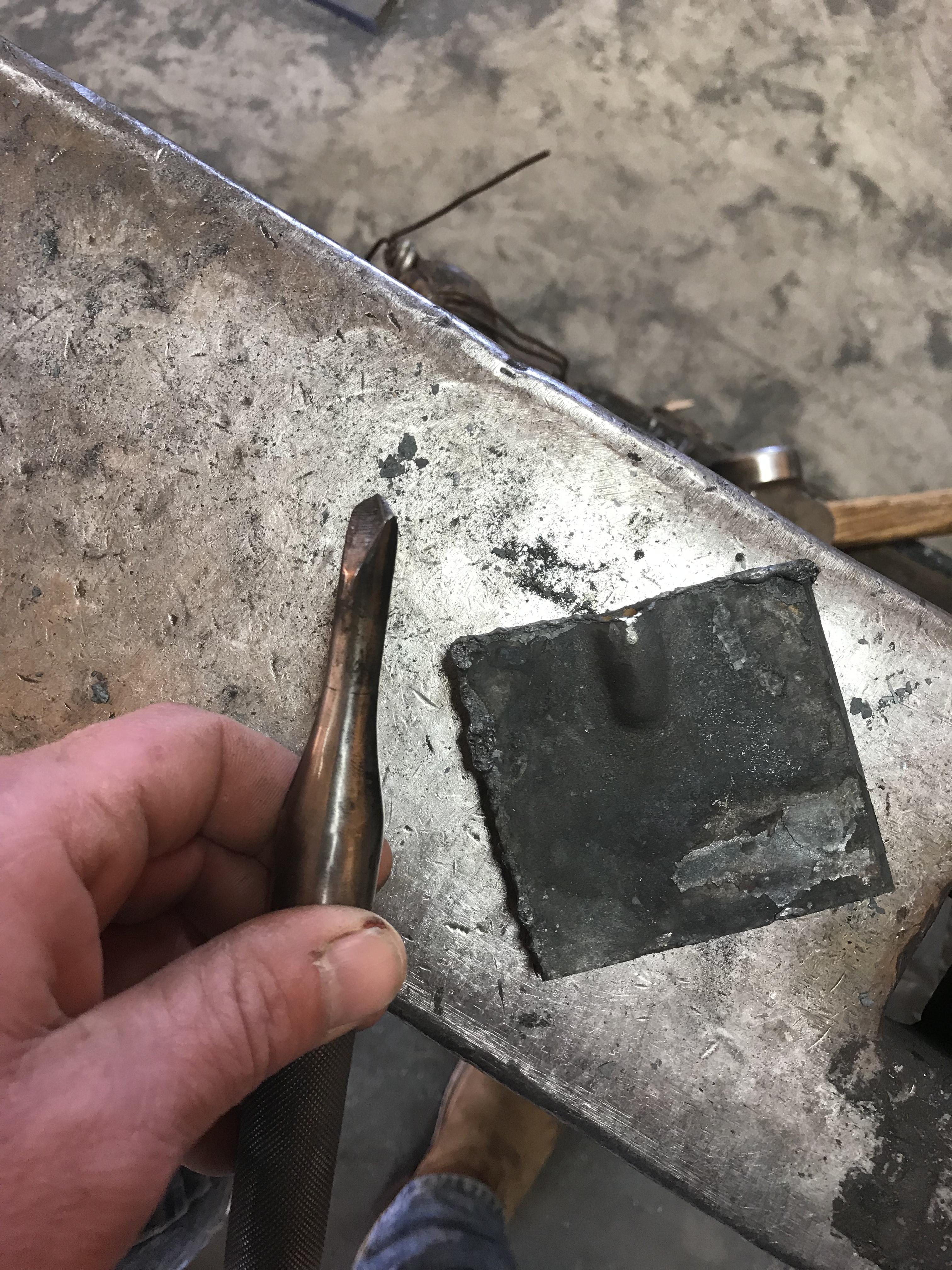

Ranchmanben Posted January 26, 2018 Author Share Posted January 26, 2018 Update time. I asked a friend of mine, who’s more handy with a lathe than I, to make me a punch out of S7. It worked out exactly how I wanted. Here’s the first trial run. I got a little off center but i know how to prevent that in the future. Quote Link to comment Share on other sites More sharing options...
