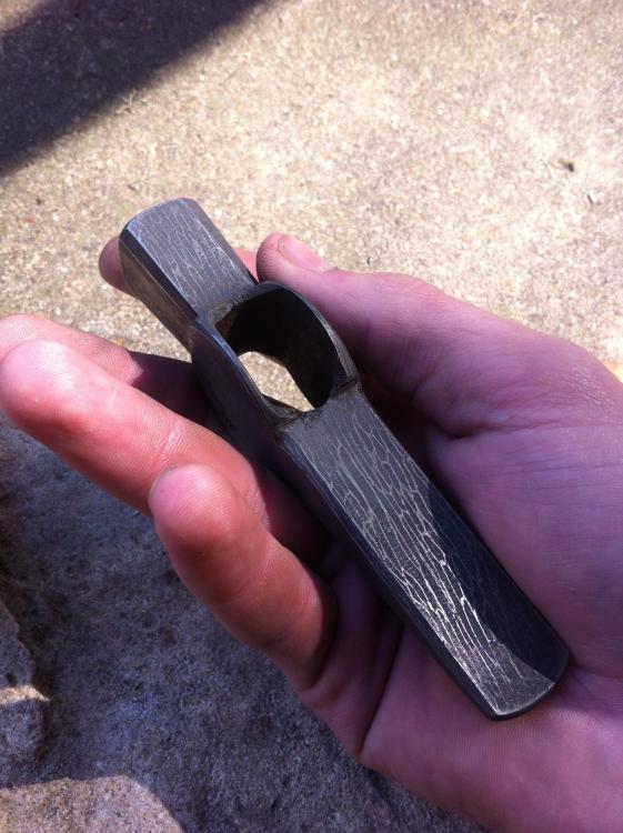

Mark Ling Posted November 26, 2017 Share Posted November 26, 2017 Hey ya'll, I'm not a wood worker, and it may really show through this post, but how would Black Walnut work for hammer handles? I tried looking this up, and all I could find was people asking for axe handles, and the overall response was no, that it is too brittle. But, axe handles are 3 times longer than hammer handles, and have a curve to them, and so you really do need a good wood for axe handles. But, what about for small lets say 1lb and smaller hammer handles, about a foot long or so? I was wanting to know because I recently finished a Damascus steel hammer (ok, I'll say pattern welded) that weighs less than a lb, and I thought a black walnut handle wood compliment it nicely. I would just use it for small hammers 1lb or so, jewelry sized hammers, I wouldn't use it on 3lb or something that large for sure. The pieces I have are straight grain, so they check out in that department. So what do ya'll think? Littleblacksmith Quote Link to comment Share on other sites More sharing options...

JHCC Posted November 26, 2017 Share Posted November 26, 2017 For the same reason that we don’t make cold chisels from RR spikes: the material is unsuitable, and the effort put in will be wasted. I agree with @Gergely about Osage orange for both looks and function. I disagree with @C-1ToolSteel, though: flamed maple (aka curly maple or tiger maple) would be a hair on the brittle side, and the busy grain pattern would distract from the Damascus pattern. A more subtle grain pattern will let the steel stand out by comparison. Quote Link to comment Share on other sites More sharing options...

Mark Ling Posted November 26, 2017 Author Share Posted November 26, 2017 Thanks for the input ya'll. If this was going to be my hammer, I would try a walnut handle, but this is going in an auction, so I want a handle that isn't really likely to break. Any Ideas on a wood that is "fancy" that would go well with the head? is there a dark wood that would work? Osage orange I know starts a greenish almost yellow, and then goes darker , I wonder if I could find someone selling a straight grain piece suitable for a hammer handle. Littleblacksmith Quote Link to comment Share on other sites More sharing options...
JHCC Posted November 26, 2017 Share Posted November 26, 2017 Ash can be stained to a nice dark color with vinegar that’s had rusty nails left to soak in it. I’ve used the vinegar from de-rusting a wrought iron hammer head. Quote Link to comment Share on other sites More sharing options...
