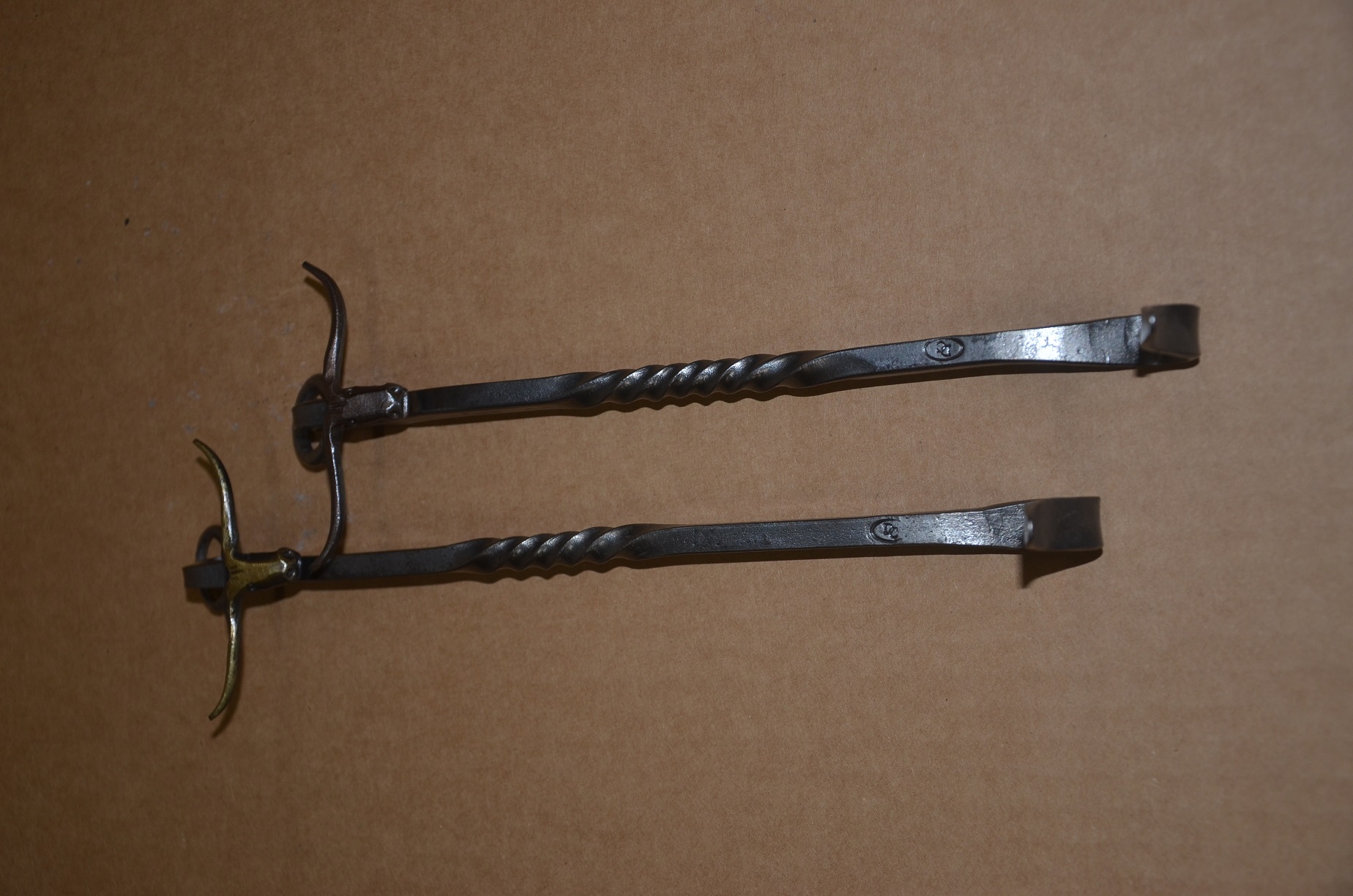

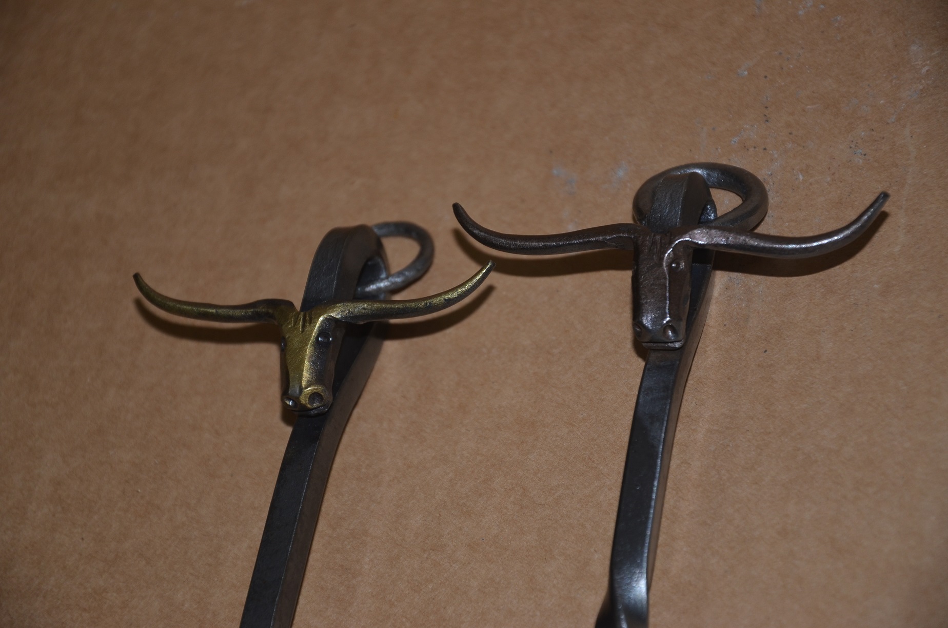

Brass is commonly used to burnish hot steel, but what about copper? My son has recently returned from Canada and I asked him to bring back a brass snowboard brush. He found one at Whistler and brought it home, but I discover that it's copper not brass. Today I made two billy lifters with long horn bulls on the top. One I burnished in the usual way with brass and the other with the copper brush. The copper is much darker and more subtle than the brassy finish. I thought it would impart more of an orange colour. Anyone else used copper, or any other metal, to put a finish on hot steel??

It is hard to estimate the best temp to get brass to take. I usually heat the metal to a really dark cherry red and clamp it in the vice. Give it a really good (not nearly good) brush with a wire brush to remove all the scale. It has to shine - bare metal. Then a swipe with the brass brush and observe what happens. If it quickly turns brownish/purple and then vanishes it's too hot. Try the smaller parts first (eg horns on a bull, the tip of a leaf) as they will get to the right temp before the main mass. Keep testing until the brass takes with a strong colour and then quench. It will still sizzle in the quench tub.
With the copper, I tried it at all temps from red down and got nowhere - just a very dark brown, weathered copper look. I prefer the brass.

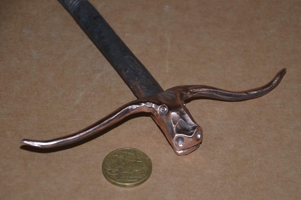

I saw Little Blacksmith's copper leaf and was inspired. Found a copper bolt in the scrap and thought it would make a good long horn. Very different from forging steel. Anyway, it worked pretty well and I didn't need to struggle for a bright copper finish! It's about 120mm tip to tip.

Really like that bull aus! glad I inspired you, cool that someone like me had an effect on someone experienced as you, cool! yup, copper is much different than steel, limited working temps, got to be careful not to melt it, was surprised the horns survived and didn't melt good job! Forged aluminum, If you haven't than I recommend trying it out, it is really easy to move, literally like moving clay, but you can work it colder. Just heat it up till it is hot enough to make wood smoke, then forge. It is a joy to forge.

Thanks LB; I must try aluminium (or aloominum as you say!) sometime. Yes the copper was touchy and there was frequent dipping of the horns to ensure they didn't melt. I found a nice piece of 12mm brass rod about 400 long, so that's the next experiment - a long horn bull camp oven lifter with that. I'll post a pic if it works. If it doesn't I'll keep quiet. :unsure:

Aus, that's an impressive copper bull.

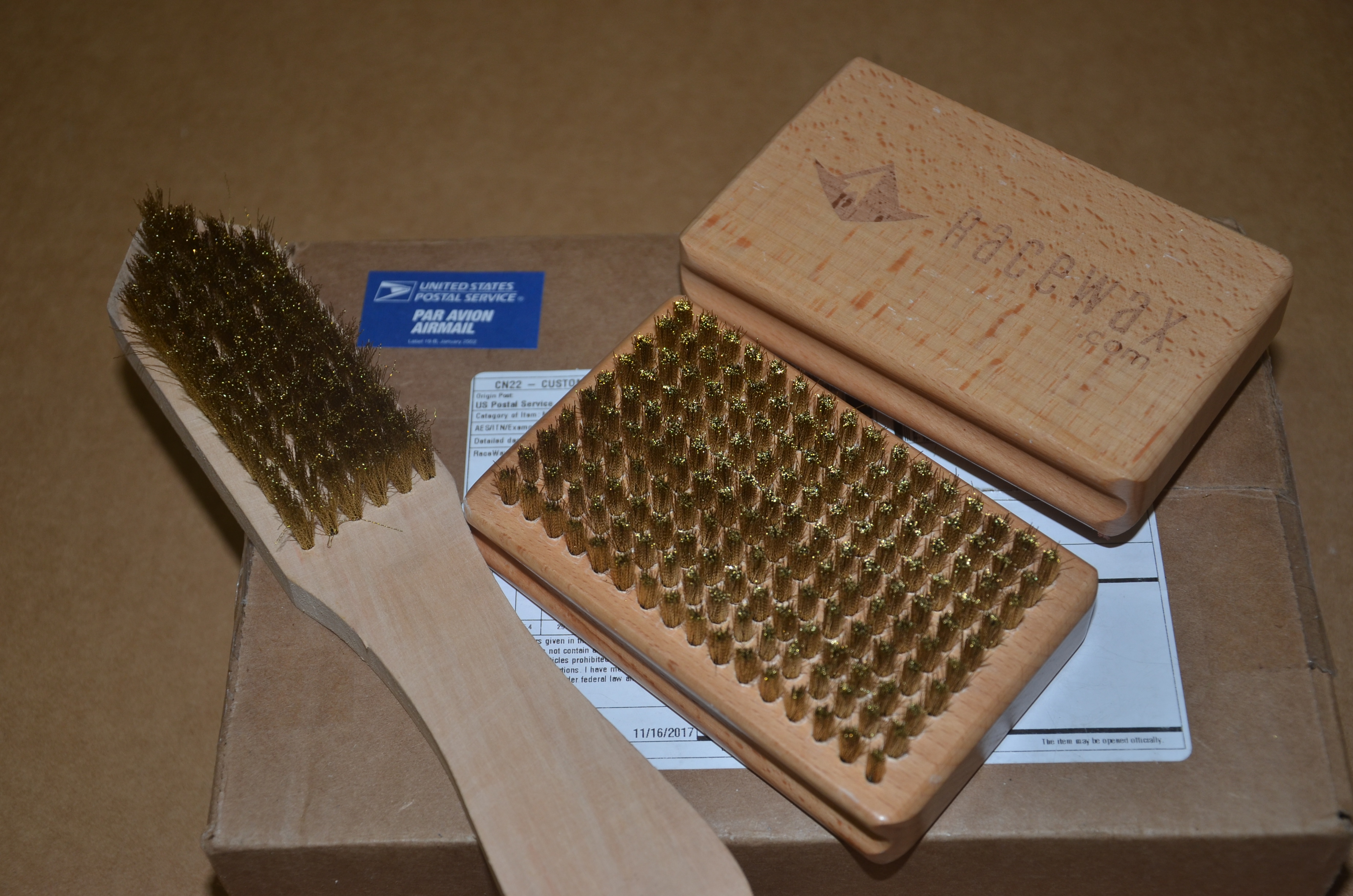

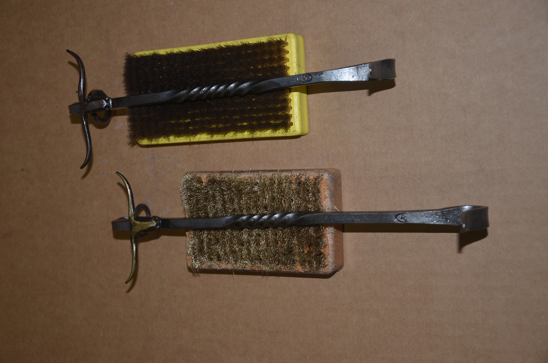

These arrived in the mail today. One el cheapo thing from Hong Kong which I don't think will be much use for burnishing. The other two are from a company called Race Wax in Massa chusetts. They were pretty expensive (+ freight of course) but they do look to be of superior quality. I'll give one a try at tomorrow's demo.

Brush it at a black heat and about the same heat as a hot oil finish.
Finish depends on how much you apply. A light skiff picks up just the highlights. Get it on and it can look like solid brass.
I like doing a hot oil finish after brushing. It turns a beautiful antique darkish look. The brass is on the highlights and the lows are hot oil dark.
