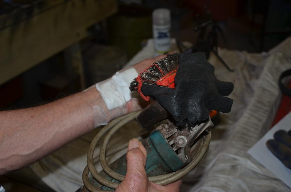

Mate of mine called round yesterday. Hand badly damaged from a wayward angle grinder fitted with an aggressive wire cup brush. It kicked (as they do) and caught the edge of his glove pulling his hand into the wire. Not fun. The glove is still tangled up in it.

Aus, was tha side handle on that grinder?
Many times people take them off to reach into tighter spaces. Removing the handle makes the tool Much more hard to control and Much more dangerous. Sometimes you just need the right tool for the job and die grinders with smaller wire wheels are better for tighter spaces.
Yes, it did have a side handle fitted but it was on the right hand side. You can see the hole for the fitting on the left side is blocked off. The operator is right handed, so you can see he was using the tool in an unnatural position for him. That was a contributing factor to the incident. You need total control over a tool like that.  I'm right-handed and I would need the side handle on the left.
