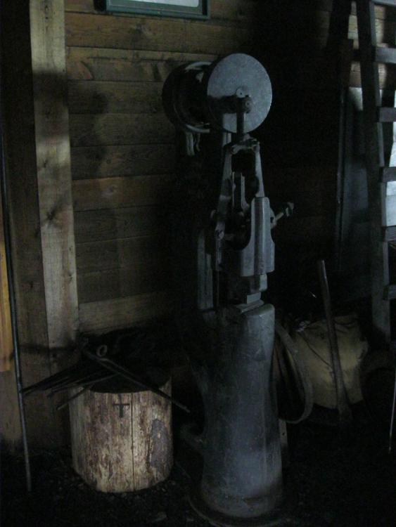

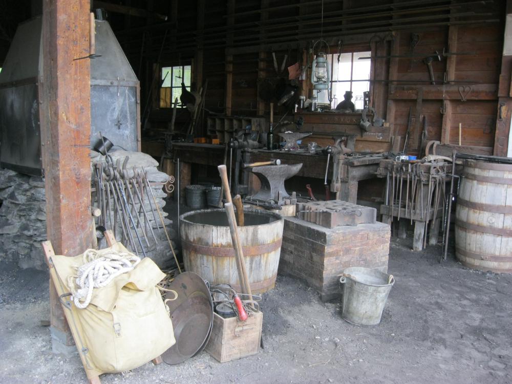

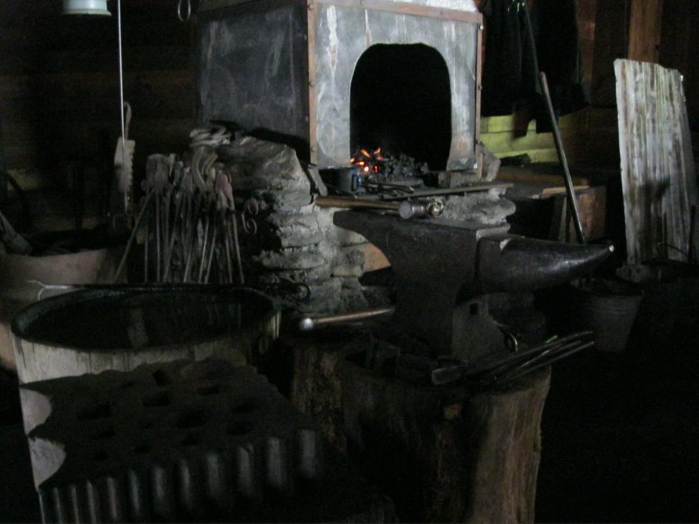

   I'm going to post pictures here every so often, from the shop I work at. These pictures are a little dark because the big front doors were closed.

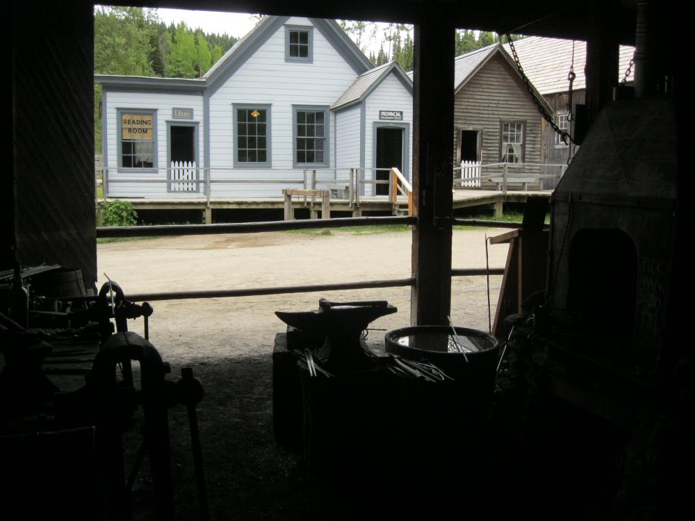

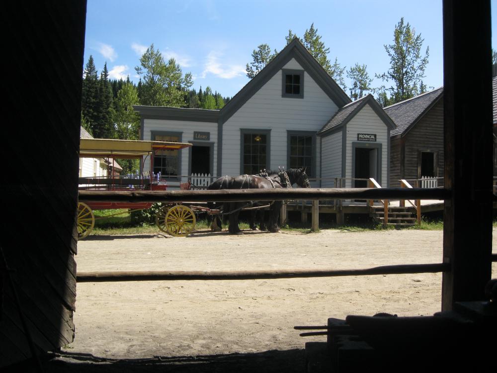

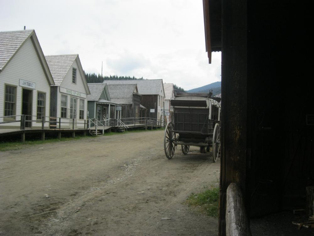

   This is my view all day from inside the shop. There are usually horses and a wagon tied up in front of the government office across the street. Also, just above the pillar in the center of the doorway is a swallow nest with chicks in it.

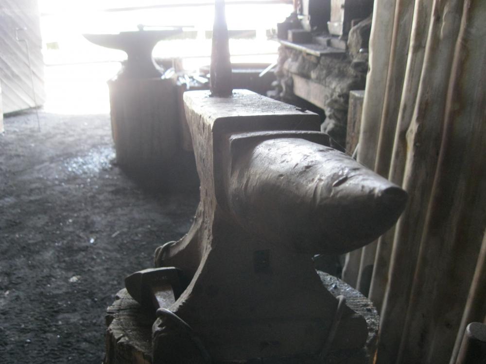

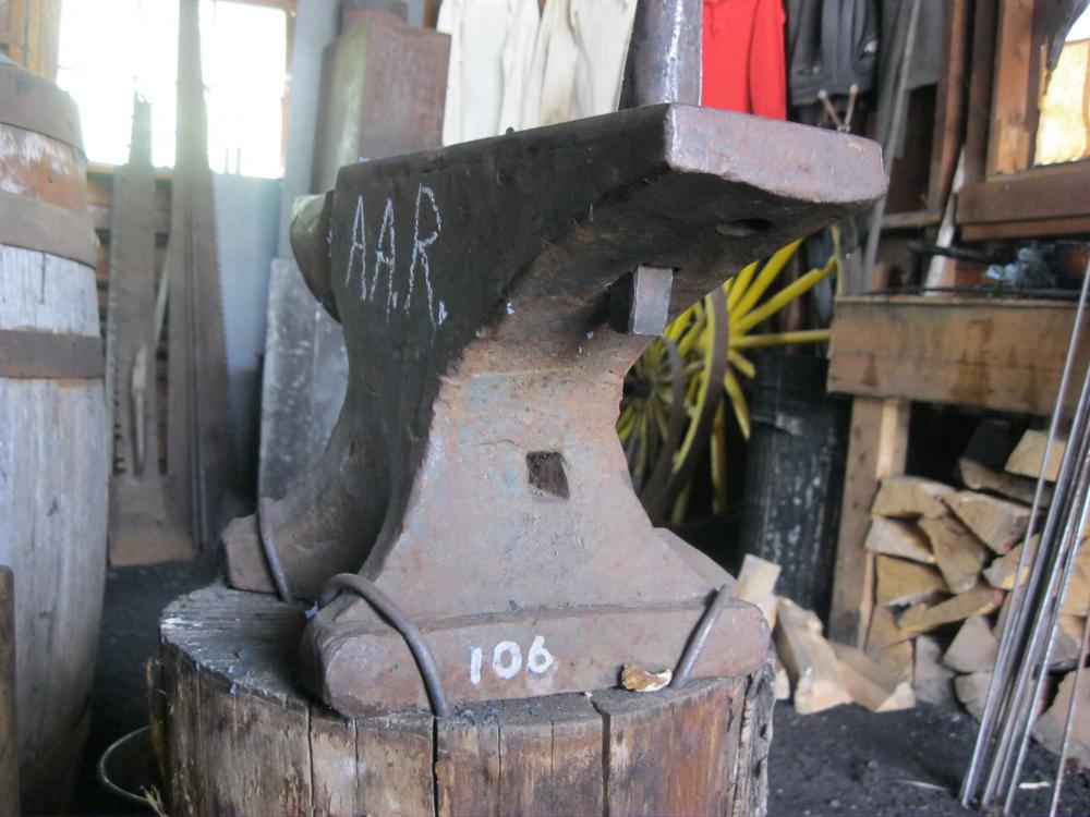

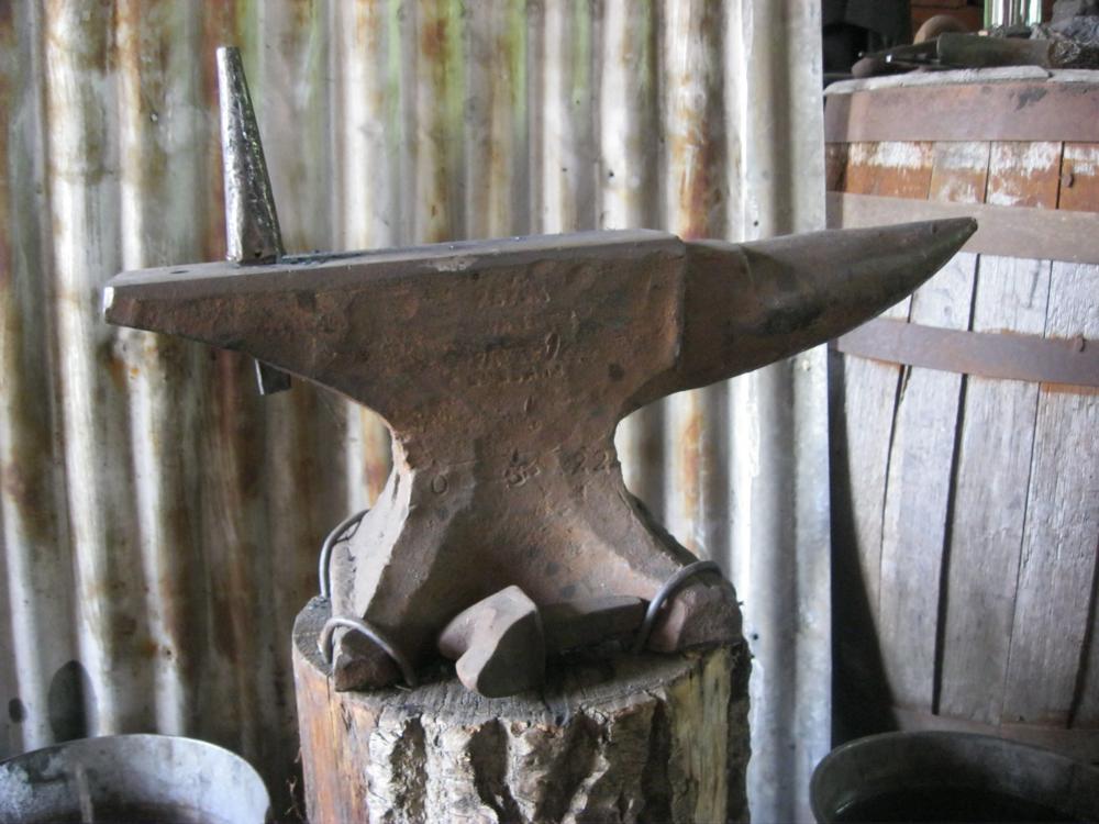

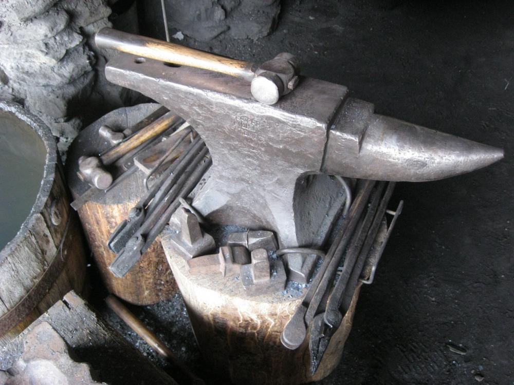

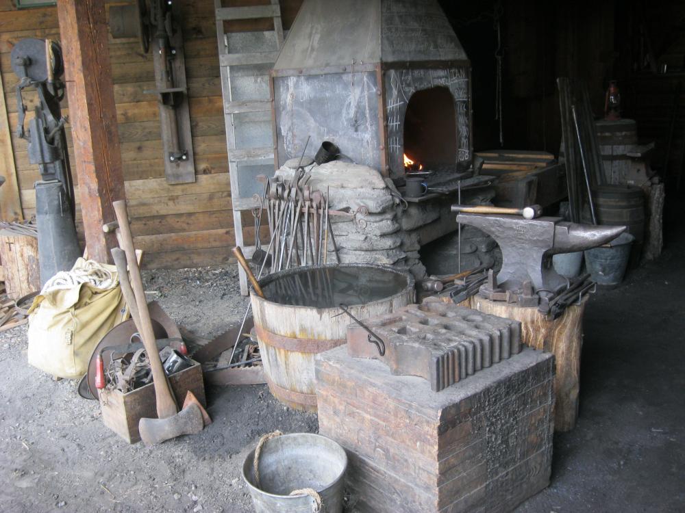

   I recently put the swage back on it's proper block that was occupied by the anvil. I then dug an 18 inch hole to insert a log into the floor for the anvil. Made four large u nails? to hold it down. When I'm hitting something really hard I've had visitors tell me they can feel the hammer strikes in their feet. Mission accomplished.

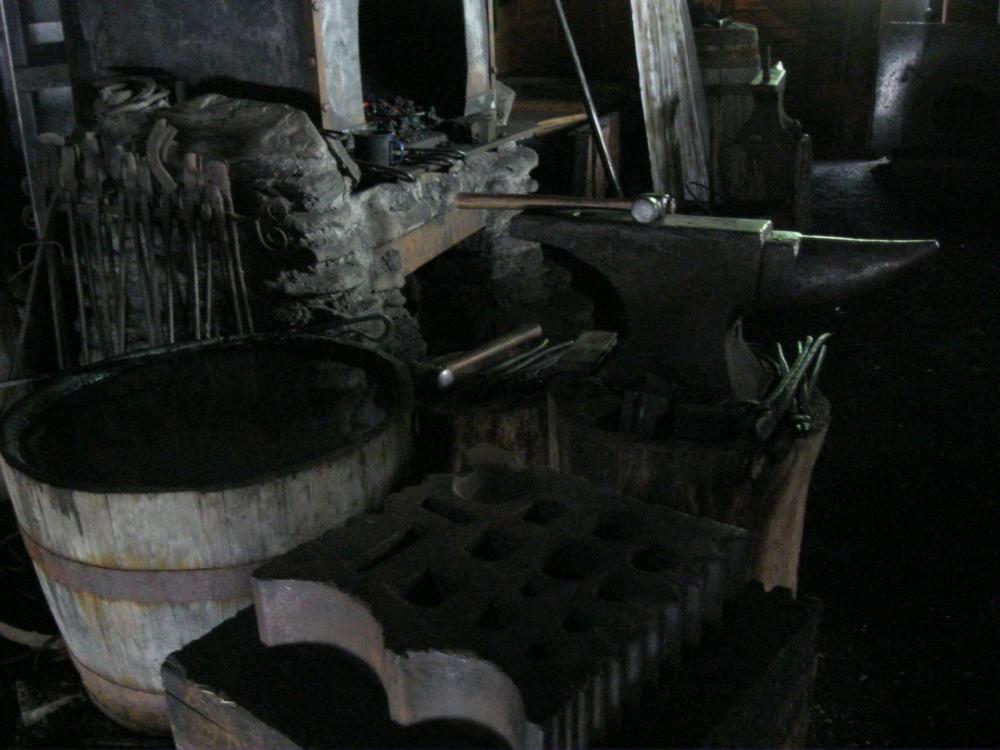

   A few pictures of my 106 lb Peter Wright.
That sure looks like a nice place to have a shop, I really like the view. Living history town, village, etc.?
The U shaped nails are called ."staples."
I'm sure you've noticed how the pic looking down the horn of your anvil came out. That's because of the bright light coming in the door from behind. That's called "back light" and no camera has a human brain to filter and adjust the picture, cameras just record our mistakes. Most of learning photography is learning what the camera is going to record rather than what YOU see. Next time you want to get a shot under those conditions wait for early evening and use a flash. If the subject is shiny cover the flash with a single ply of tissue paper to diffuse the light or reflections off the highlights will wash out the detail. OR drag it outside on a cloudy day, near perfect diffuse lighting conditions for shooting shiny glittery stuff.
That looks a nice place to work, I assume a pioneer village?  I did the same thing re staples to hold my anvil still on a wandoo stump.

Yeah, I'm not much of a photographer Frosty. Thanks for the tips.

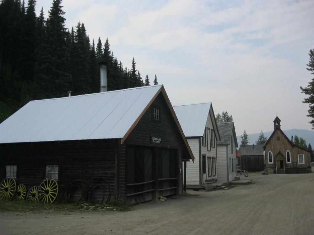

The shop is in Barkerville, an old gold rush town built in the early 1860's, in the Cariboo Mountains. It was one of the biggest gold strikes in the world. The entire town and area was made into a museum in 1958. We get 50 to 60 thousand visitors each summer.

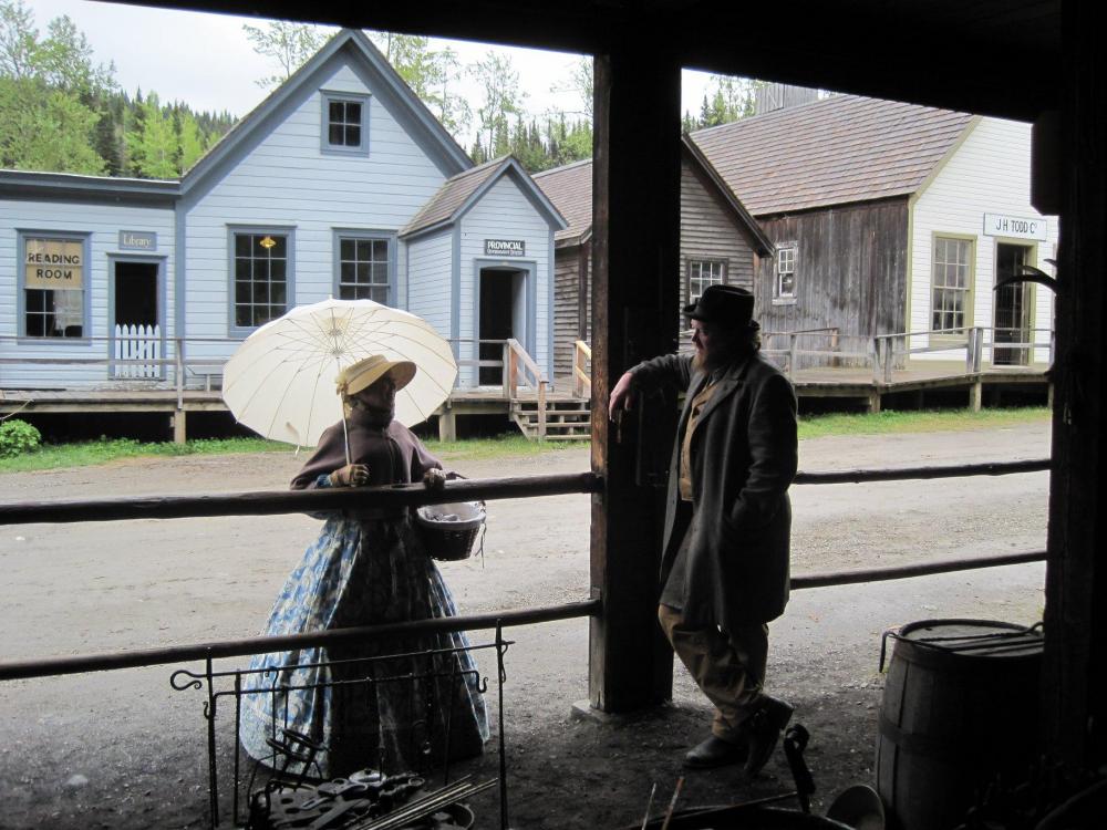

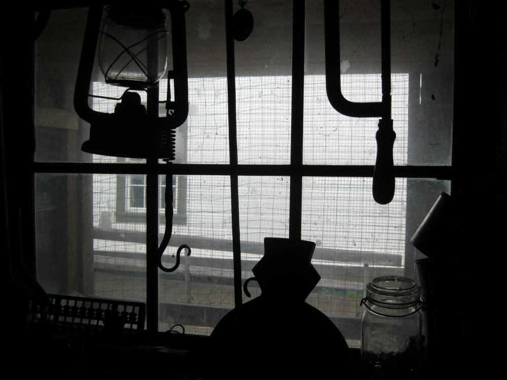

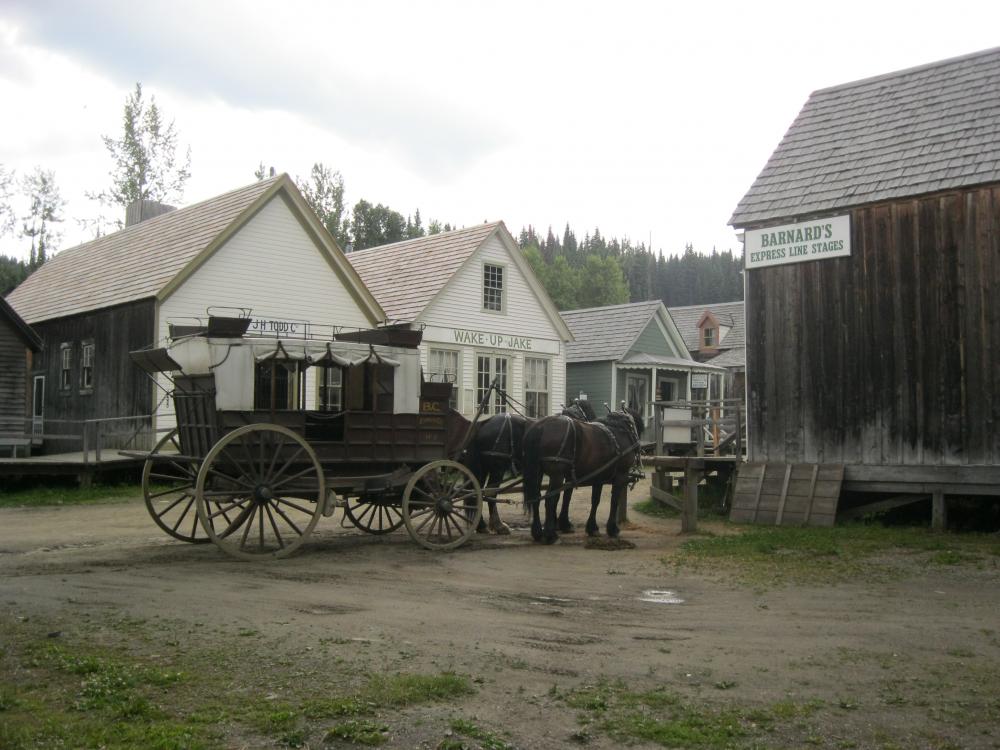

Horses! The third picture is the view from behind the shop, looking out at the main street.
Jealousy is green. I know !

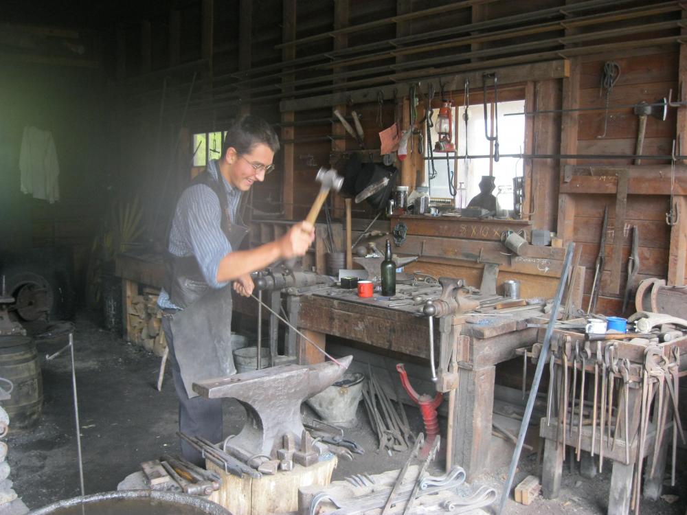

A few more recent pictures. The drill is now mounted on the wall instead of the post in the center of the shop. Cleaned up a lot of the mess and old scrap metal.
I also have a local kid ( family friend ) coming in for two mornings a week, and he is doing very well. He's only 14, and he is almost as big as I am. He is used to building log homes with his father, not playing video games in his spare time.

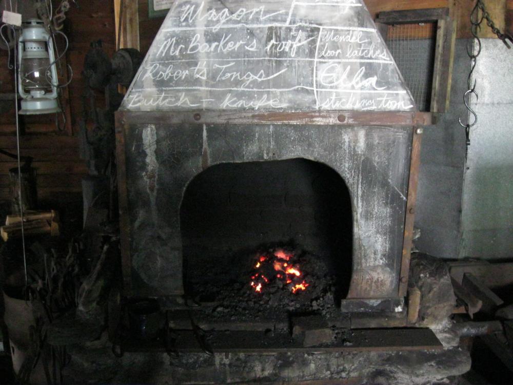

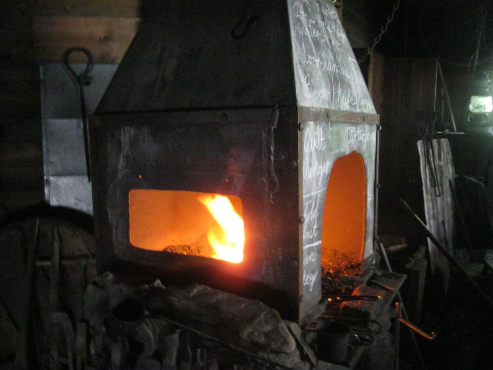

I cut a hole in the side of the hood so the visitors can see the fire. Even while I was pumping the bellows, some people would still ask if I was using gas.

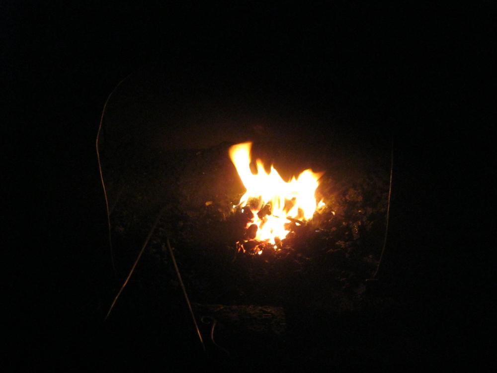

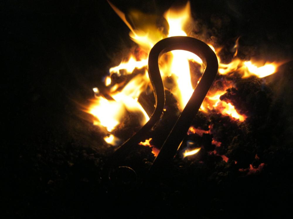

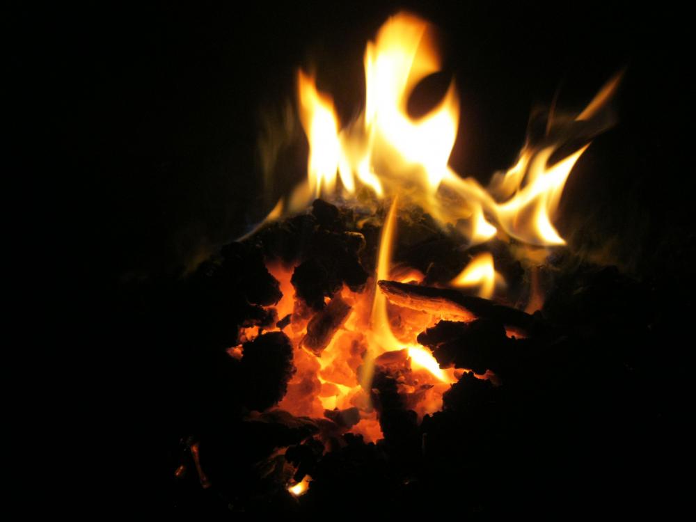

An image of a nice coal fire with a little kindling mixed in.
Same fire.

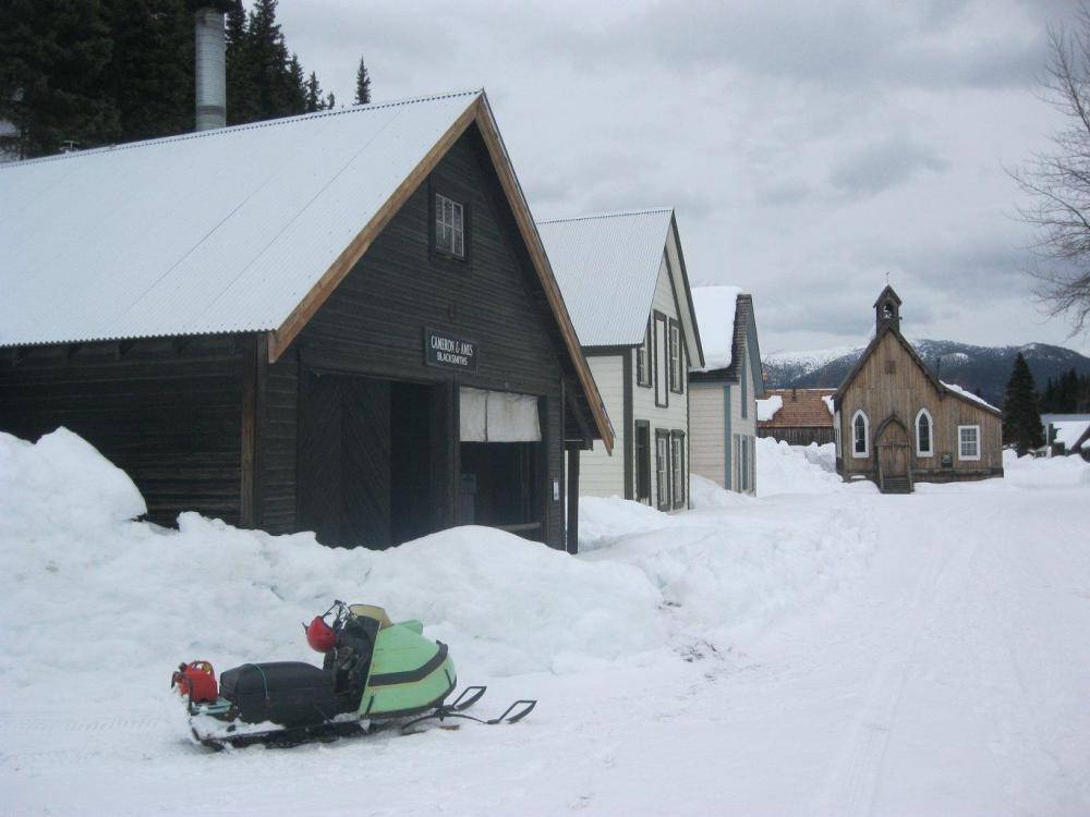

 If it's not too cold I ride my snowmobile to Barkerville and play around in the shop.

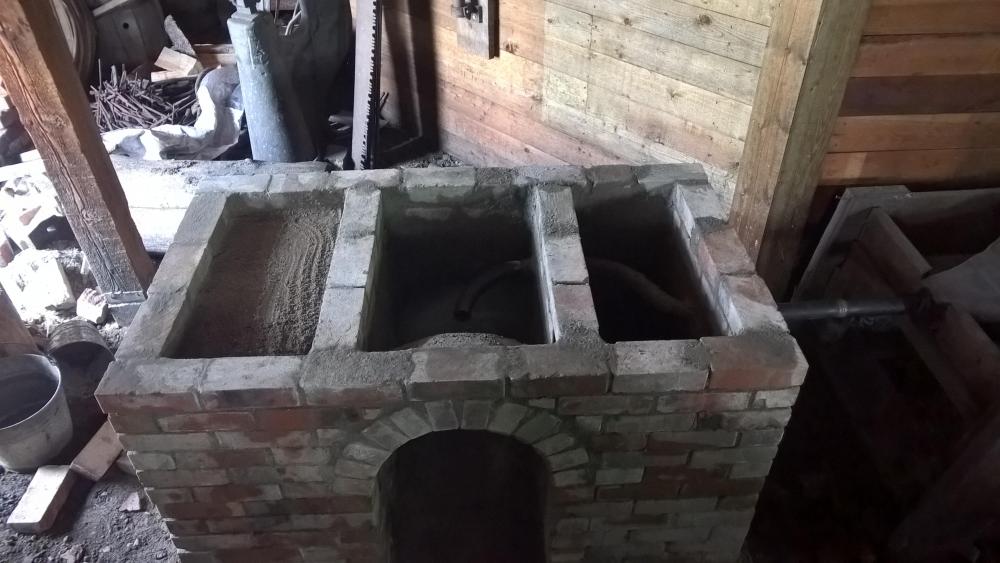

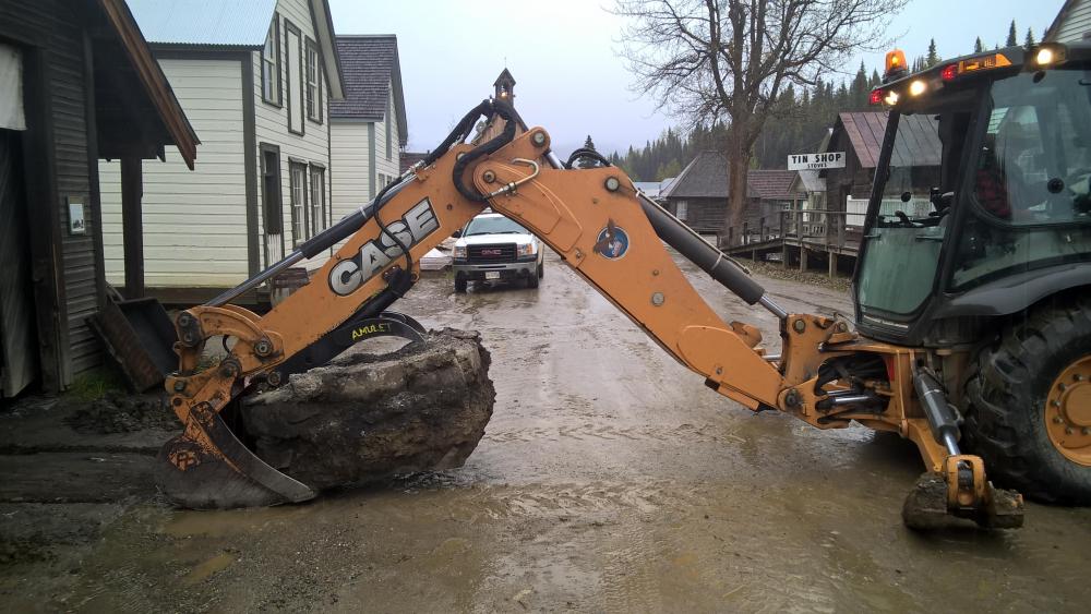

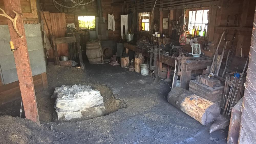

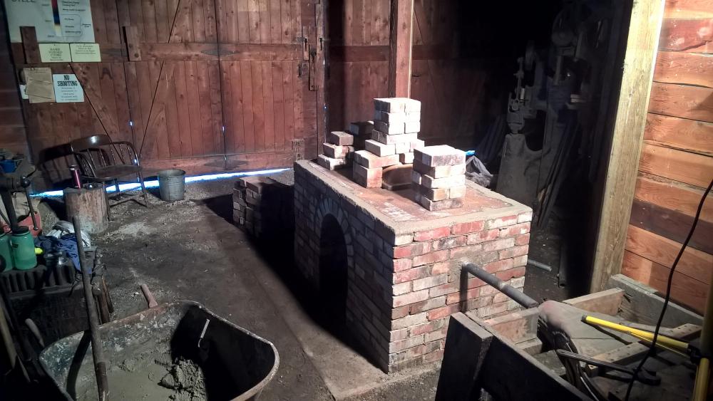

With the down time because of covid, and snow ripping the chimneys off, we decided to build a new forge at the shop. It took a couple of days to destroy the old one and remove the remaining section of chimney.
Bye bye.

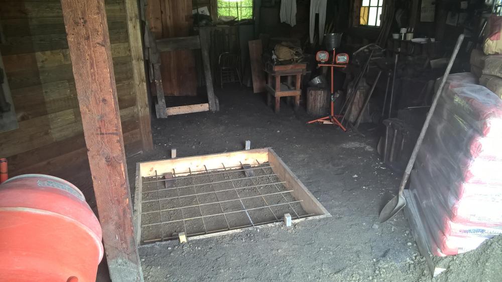

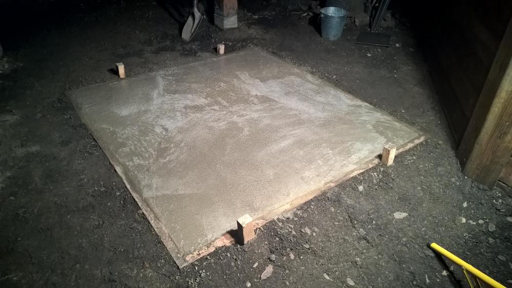

I poured a 5' x 5' x 9" concrete pad.

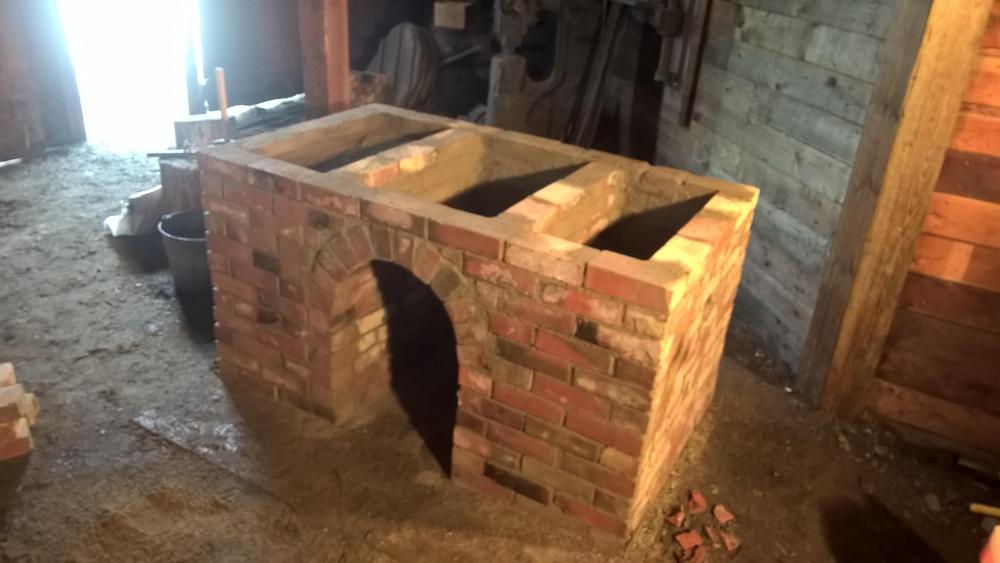

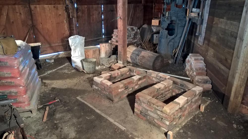

Start of the brickwork.

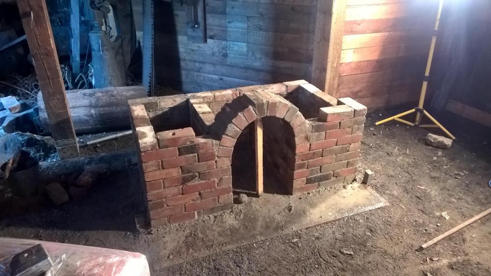

Getting taller.

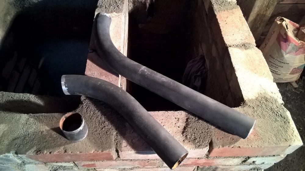

Ready for the air pipe.
I welded up some pieces of a bedframe from the dump.
I had a friend cut out the steel top with a torch. It is 55" x 30".
