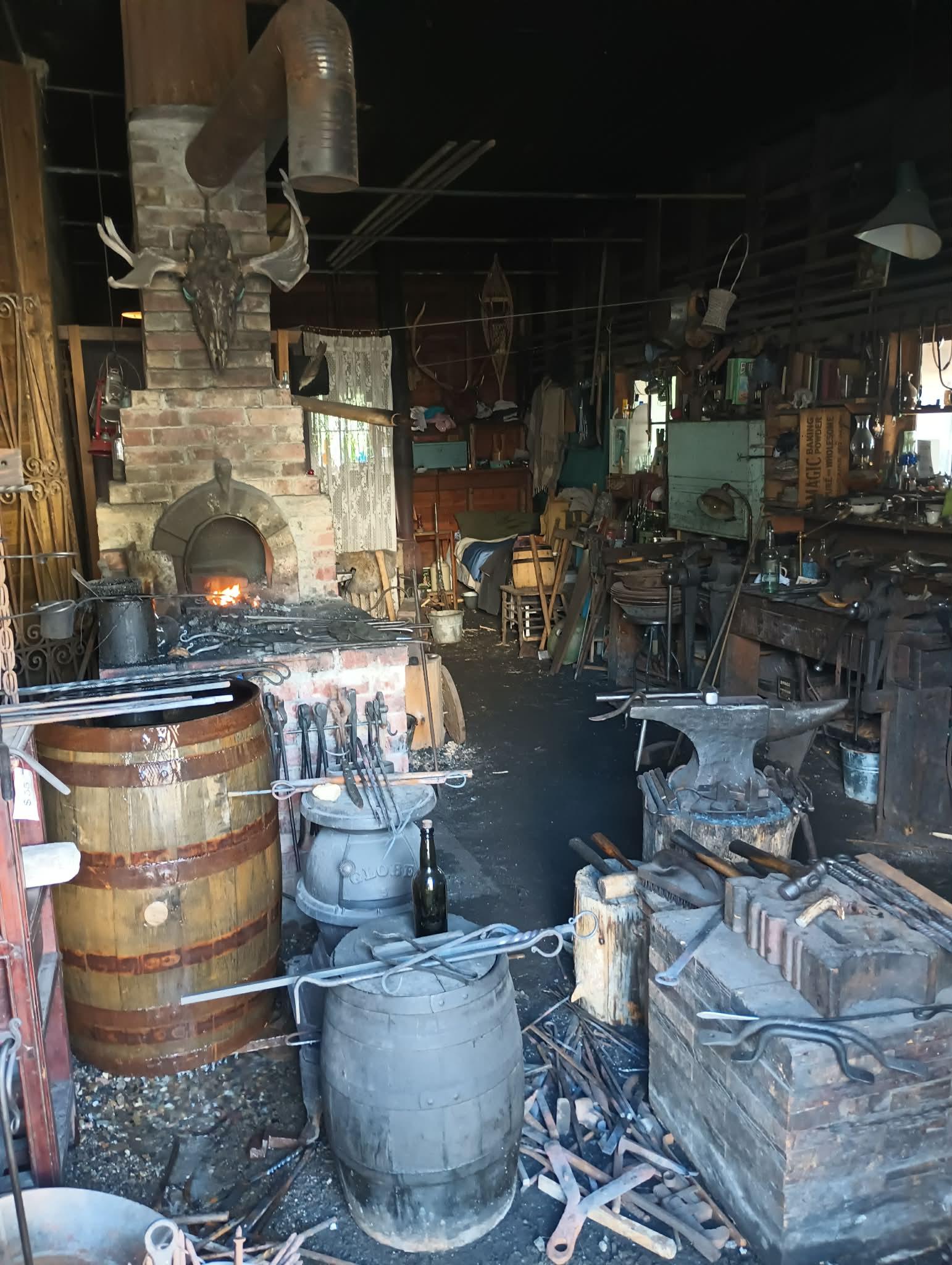

Hey everyone. So sorry it's been so long since I have posted. Life gets in the way some times, and I have been struggling with my mental health. I have just recently (at 45 years old) been diagnosed with autism and adhd. I'm doing great now and will be posting more. If you are struggling with mental health yourself, please reach out to somebody. Things seem so much worse than they are when you are in a depressive state, but loved ones and professionals are there to help you. Hey Berrle. I had a lot of fun working with Dan. He's a good guy and very energetic! I do get paid and it is a very good wage. Barkerville and my boss are very good to me. I get laid off in the winter but still work two days a week. People order things on Barkerville's website and I will come to make those, and also just try to build up stock. I also come in to work on my own stuff. Coming in to the shop in the winter is very satisfying, and lets me work in a more relaxed atmosphere. Here are a few pictures of the new forge, which we named Geordi. My boss Mr. Hankin and I at the shop. -

Thanks swede. There won't be a bucket. Ash will just dump onto ground / concrete. I've been lusting after a brick forge for a while now. It's finally happening. The top is now finished. I ordered this fire pot from Thak Ironworks in Ontario. Great place to deal with. It's also made in Ontario. -

The hood is in the dump. It was rusted beyond repair. I am building a side draft brick chimney, with a tiny little hood over the opening. -

With the down time because of covid, and snow ripping the chimneys off, we decided to build a new forge at the shop. It took a couple of days to destroy the old one and remove the remaining section of chimney. Bye bye. I poured a 5' x 5' x 9" concrete pad. Start of the brickwork. Getting taller. Ready for the air pipe. I welded up some pieces of a bedframe from the dump. -

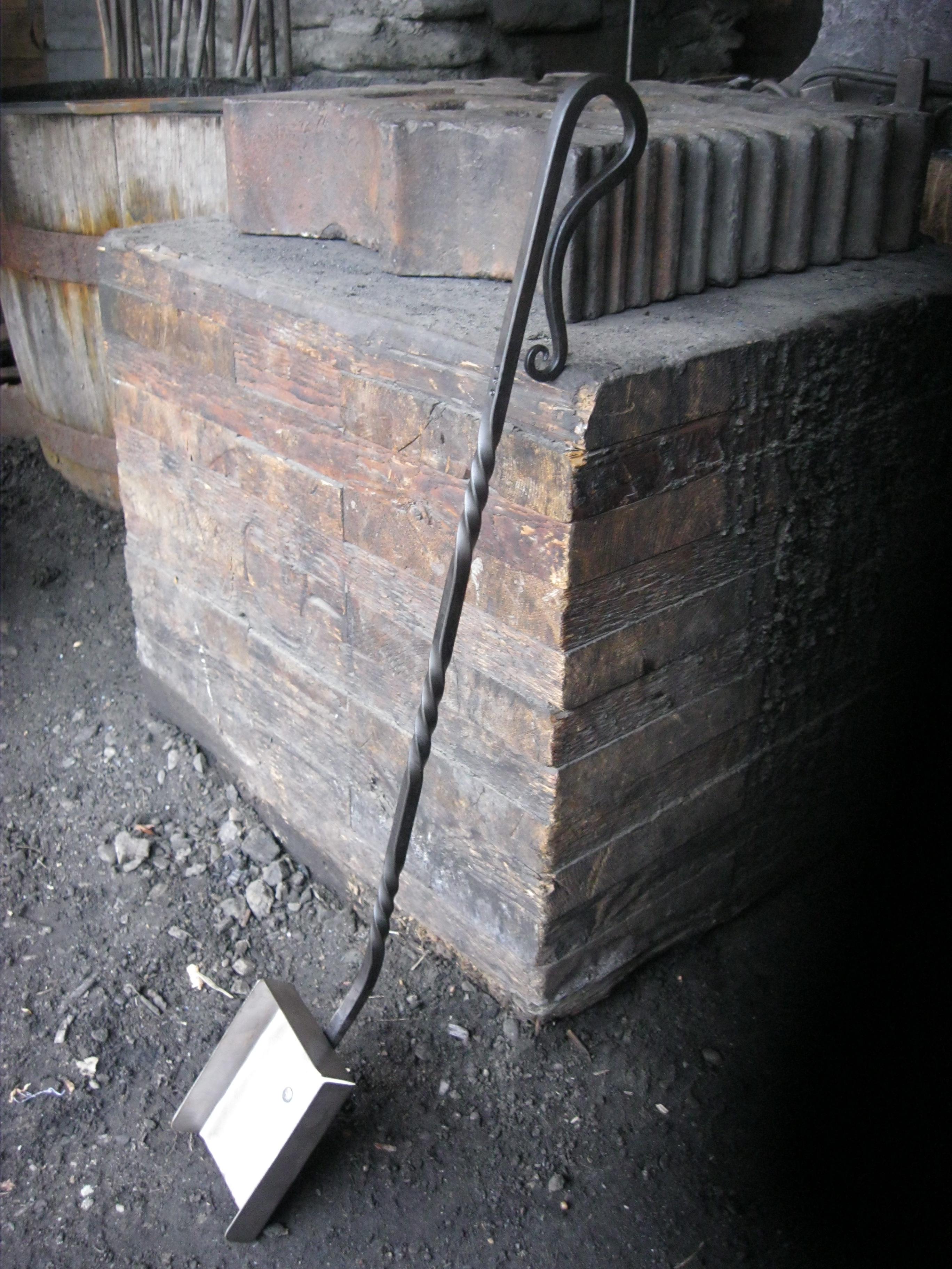

My first ash shovel for a friends wood stove.
O'connell replied to O'connell's topic in Member Projects
Thanks for the compliment Frosty. I thought about the corner thing, but was trying to do this one quick. The stainless is pretty thick and strong. I used two rivets to attach the shovel to the bar. I will definitely rivet the corners on the next one. It looks much better. -

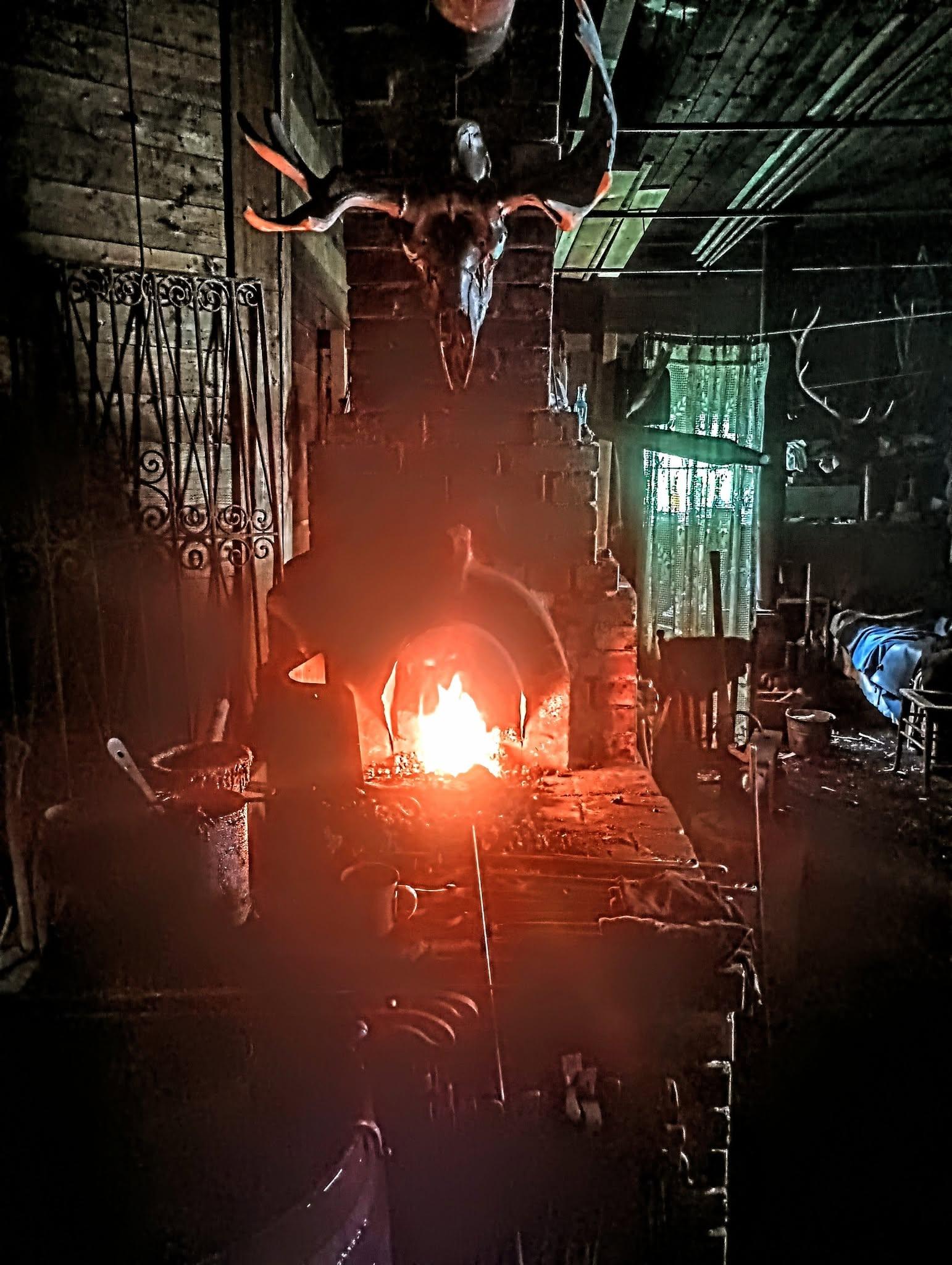

I cut a hole in the side of the hood so the visitors can see the fire. Even while I was pumping the bellows, some people would still ask if I was using gas. The swallows built their nest right above the forge this year. I put a piece of 3/8 bar up there for a perch. Then they went back to the old nest later in the summer for their second batch. An image of a nice coal fire with a little kindling mixed in. Same fire. -
