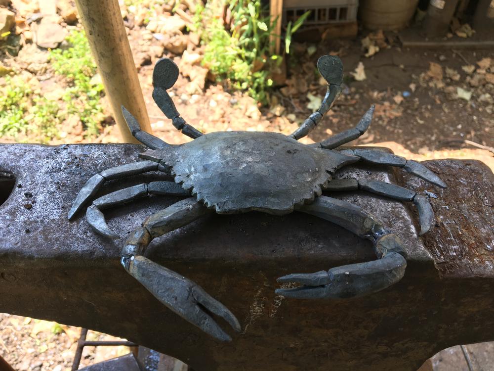

Hello all. Does anyone have an idea on how to clean of the white flash left on steel by stick welding? Obviously a brush works, but it's in an area I can't reach. Thanks!
There are pretty inexpensive sand blasters out there but compressors are not so inexpensive if you don't have one already.
your question is very general, but depending on the circumstances, a sand blaster or pressure washer?
That might be the way. I was kind of hoping there's a spray or something that would dissolve it, but I do have an airbrush-sized blaster that could reach. It's a small area on a sculpture. Why didn't I think of that? Thank you!

If it's a small sculpture maybe a dip in vinegar or diluted muriatic acid then neutralized in baking soda and water. I haven't tried that for That purpose but use it to remove galvanizing before welding parts.  You would want to dry it quickly and coat it immediately with oil or whatever your final finish would be.
But sand blasting seems the safest bet for just a spot.
It's not galvanized. It was from stick rods. Lots of white flash that was hard to clean off the underbelly of this little guy. It's almost finished. I'll post more pics soon.
Oh wow. That's a very nice looking crab.

Thank you. Around here, slag is what forms over the weld and has to be chipped off. I was referring to the white powdery coating that often surrounds a weld and is still there once the slag is chipped away. It can be brushed off, but it's hard to get to sometimes.
