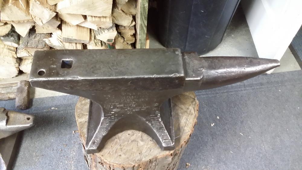

After a long search, I finally found an anvil. It is a Peter Wright marked 1-2-2 so I believe it is supposed to be 170 lbs. The actual weight on a digital scale was just over 164 lbs. The face is very flat, it has a great ring, and the rebound was around 90%. It has hammer marks, but I can live with that.
I did an online search to see if I could determine the age but I came up empty. If anyone has a good estimate,  I would greatly appreciate it!

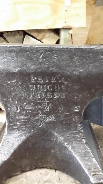

Does anyone know the significance of the stamp on the foot? Google didn't help. Thanks.
No one really knows what those marks signify. Richard Postman suspects they are inspectors marks. Yours is the coolest one I've seen.

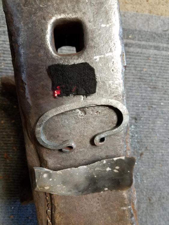

Thank you very much. I couldn't wait to try it out, so I made an attempt at forging my first flint and steel fire steel. It is not perfect, but I was happy with it and throws sparks like crazy! It is sitting on top of a beat up anvil that has been on loan to me until I could find one of my own,
