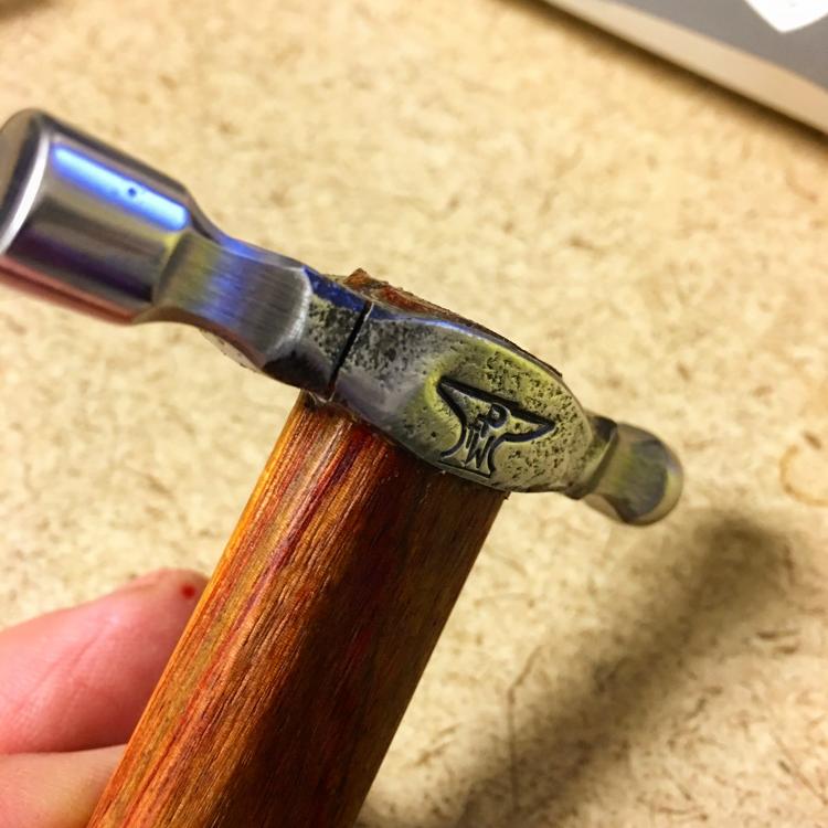

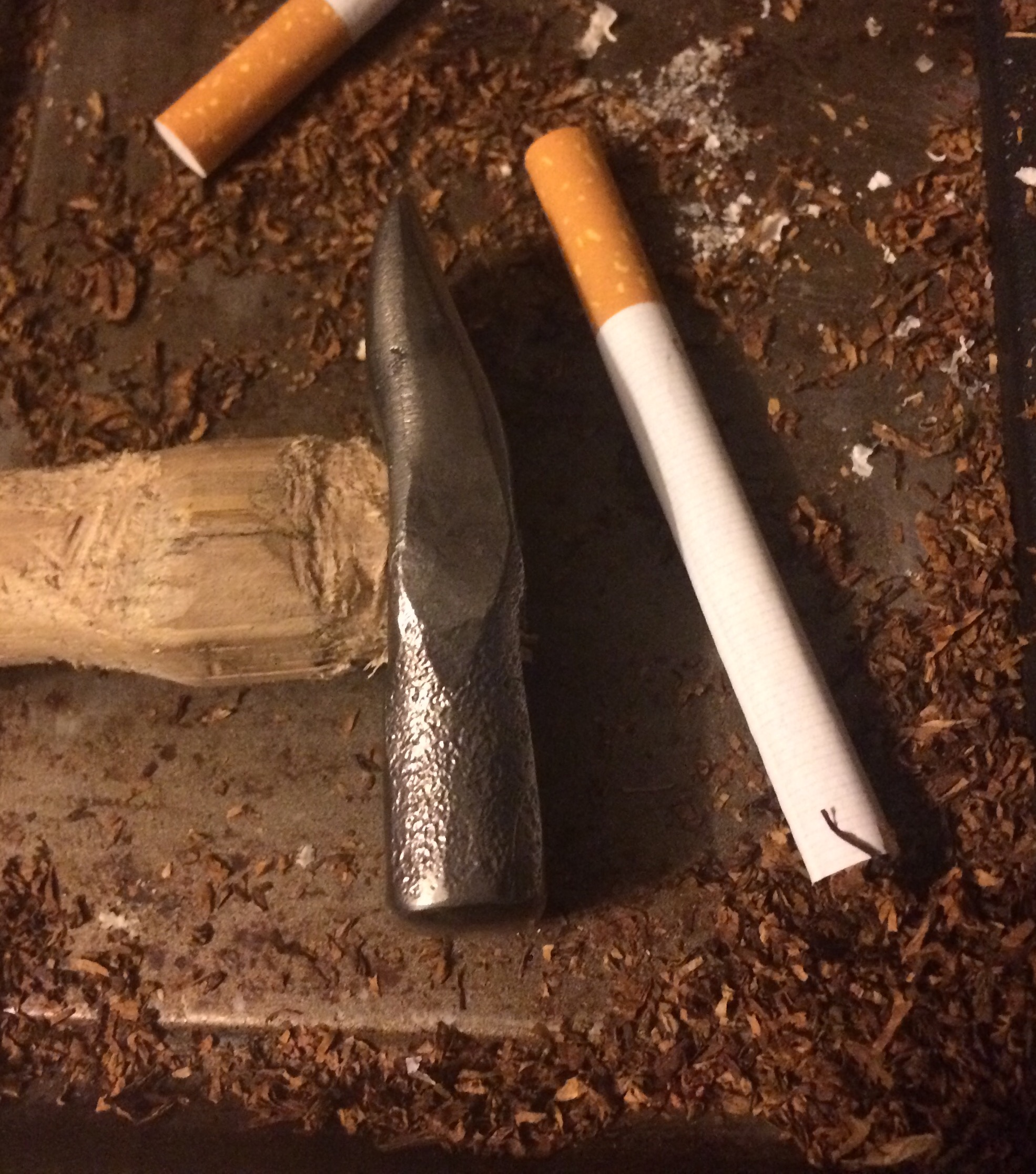

Derek Melton Posted April 12, 2017 Author Share Posted April 12, 2017 I agree, larger stock forged down on the ends would work better, I was just curious as to how one would turn out, somewhat as a novelty, from such small round bar. I was really pleased with it. Until it broke. This was my first attempt at the tiny hammer. Being 5160, I just heat treated it as I always had, heated to critical, quenched in oil, tempered at 400. The grain structure of the steel where It broke looked just like a file, kinda creamy and fine. I think it was just too brittle and my temper didn't work out. I worked on a new slit/drift combo for the 3/8 round bar last night. It worked well, I really appreciate the suggestions from Alan Evans regarding the proper diameter of the drift in relation to the stock. I'm going to make the same kind of tiny hammer, this time I'll keep the eye a little smaller and I'll only heat treat the working faces, not the eye material. Quote Link to comment Share on other sites More sharing options...

ThomasPowers Posted April 12, 2017 Share Posted April 12, 2017 400 degF? That's more a knifeblade temper range and not an impact tool temper range! 400 degC? (752 degF) would be kinda hot for an impact tool of that alloy... Quote Link to comment Share on other sites More sharing options...
Derek Melton Posted April 12, 2017 Author Share Posted April 12, 2017 6 minutes ago, ThomasPowers said: 400 degF? That's more a knifeblade temper range and not an impact tool temper range! 400 degC? (752 degF) would be kinda hot for an impact tool of that alloy... Yeah, 99% of my experience with 5160 has been with knives. I've made some punches and hand held drifts/fullers with it but I usually temper those by color. What would you suggest for a temper? Just bring it to a straw and quench or pop in an oven for a particular time/temp? Quote Link to comment Share on other sites More sharing options...

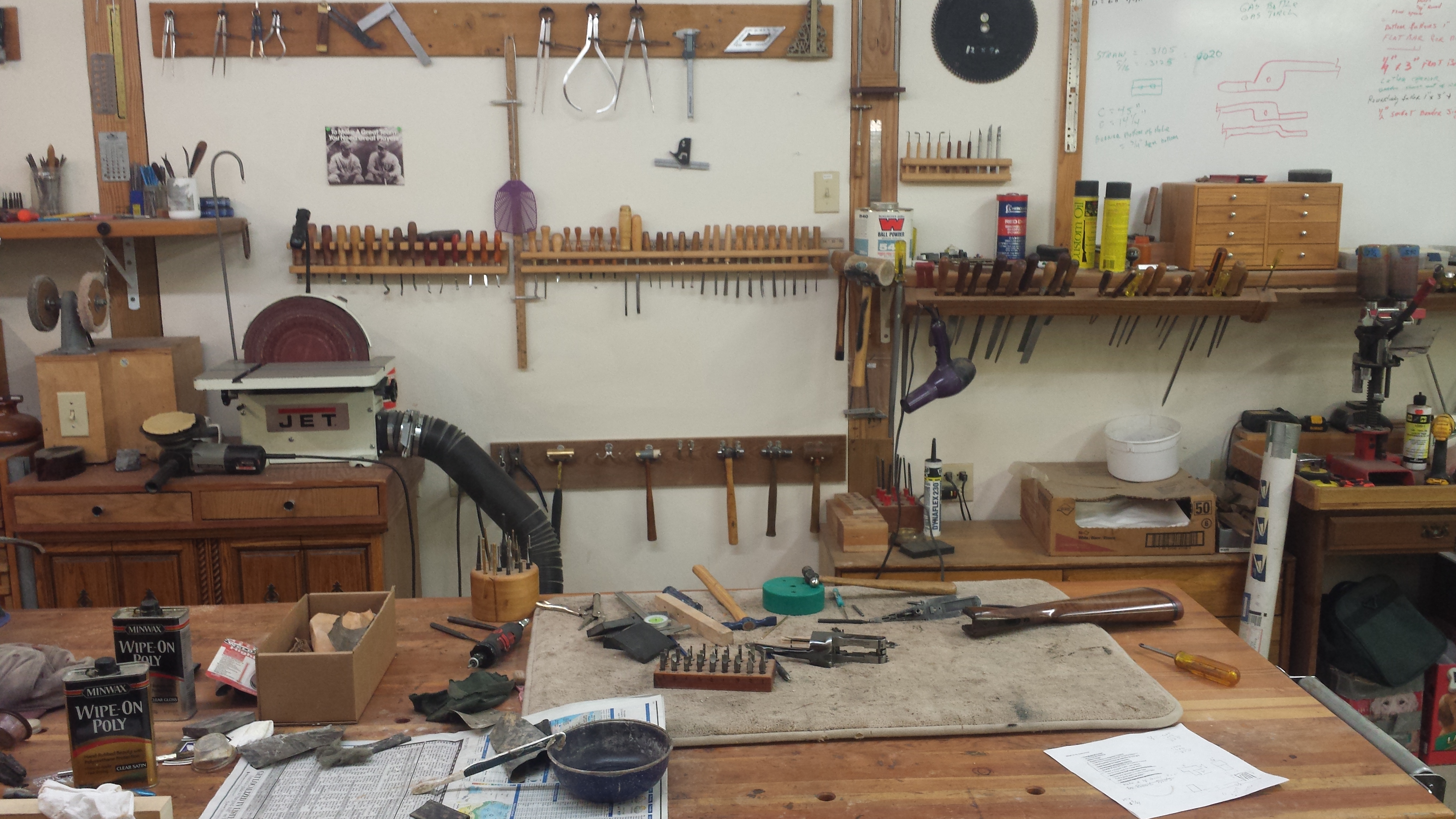

stockmaker Posted April 12, 2017 Share Posted April 12, 2017 Nice little hammer Derek. Having the right hammer for the job is not only important in blacksmithing, but in other endeavors as well. The right little hammer is as important to me as the right chisel or file. I have wondered lately if there is a market them at craft shows? A picture of my workbench this morning. Quote Link to comment Share on other sites More sharing options...
Derek Melton Posted April 12, 2017 Author Share Posted April 12, 2017 17 minutes ago, Derek Melton said: Yeah, 99% of my experience with 5160 has been with knives. I've made some punches and hand held drifts/fullers with it but I usually temper those by color. What would you suggest for a temper? Just bring it to a straw and quench or pop in an oven for a particular time/temp? I probably answered my own question there, I probably should just heat treat the working faces, temper by color as I do with other 5160 hand tools. Once I get the next hammer finished, I'll test it on the anvil too and I'll know if my process is working or not. =) Quote Link to comment Share on other sites More sharing options...
ThomasPowers Posted April 12, 2017 Share Posted April 12, 2017 If you need an extremely hard face then straw would work; but you should be drawing the body back to say a blue; Otherwise I would draw to peacock or even blue depending on requirements Quote Link to comment Share on other sites More sharing options...

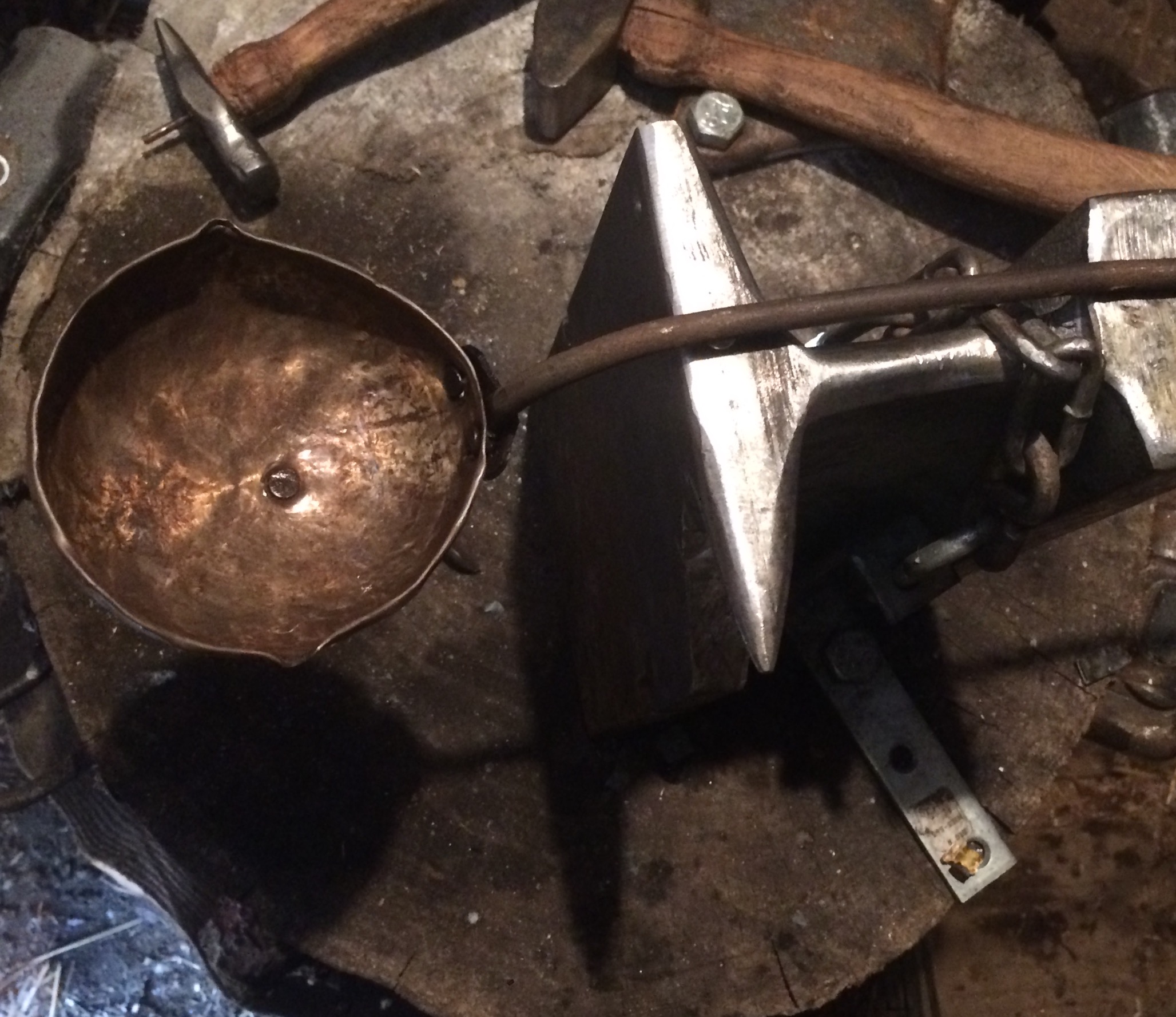

Jasent Posted April 13, 2017 Share Posted April 13, 2017 Tagging along. I've made one small hammer sofar. Used it to pound out this SS shop ladle. Plans for many more. Ps grain does not go side to side this are saw tracks Quote Link to comment Share on other sites More sharing options...
