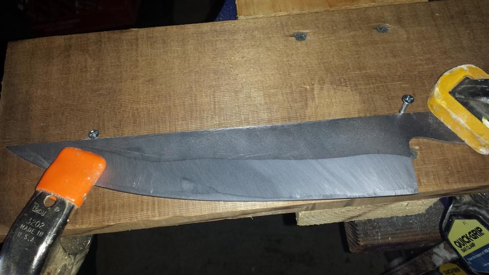

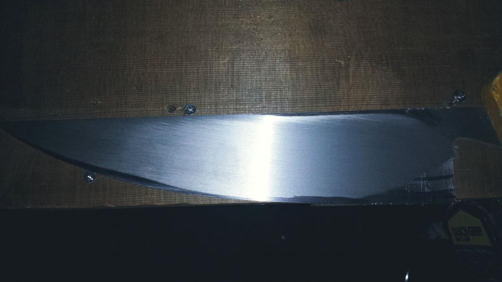

Hey ya'll. Im working on a knife for a chef friend of mine. I have the shape finished and now I am wondering if I should do a partial grind or a full edge to spine grind. The knife is a smidge deeper than 2 inches and the thickness is .110 inches. He works in a professional setting but I still worry that if I make it a full grind there would be a possiblility that the knife could chip since the angle of the grind would be very low. Not sure what to think.
I am working with files, not a belt grinder, so slower material removal.

Most knives are differentially tempered. The spine is softer than the cutting edge.
Check the stickies on the knife maker's heading on this site. Better yet the site sells an excellent knife making book called "Introduction To Knife Making" The author is  Mr. Steve Sells, a highly knowlegable and experienced practitioner of knife making. I own a copy and regularly consult, it myself. It is reasonably priced too.

Ok, I have taken a lot of time to do more research and I have asked my friend how he wants it, and he said flat grind from spine to edge, which seems to be a general consensus. That is what I will do then.
On the note of heat treating and quenching. Clearly you all can tell that I have limited experience with those two subject matters. Since that is the case, maybe I ought to outsource those processes to a professional company? I thought about Tru Grit, (if I shouldn't be posting names of companies I'll remove it) or some other company. I figure that if a company touts their services as professional(namely, that they sell the service) then they must be able to do it well enough for most purposes.
Any thoughts? I think I would rather spend 30-60$ on a service than to ruin several knives of steel that I can't properly handle without much practice.(from what I can tell it seems to be the thoughts of most experienced knifemakers anyway)
