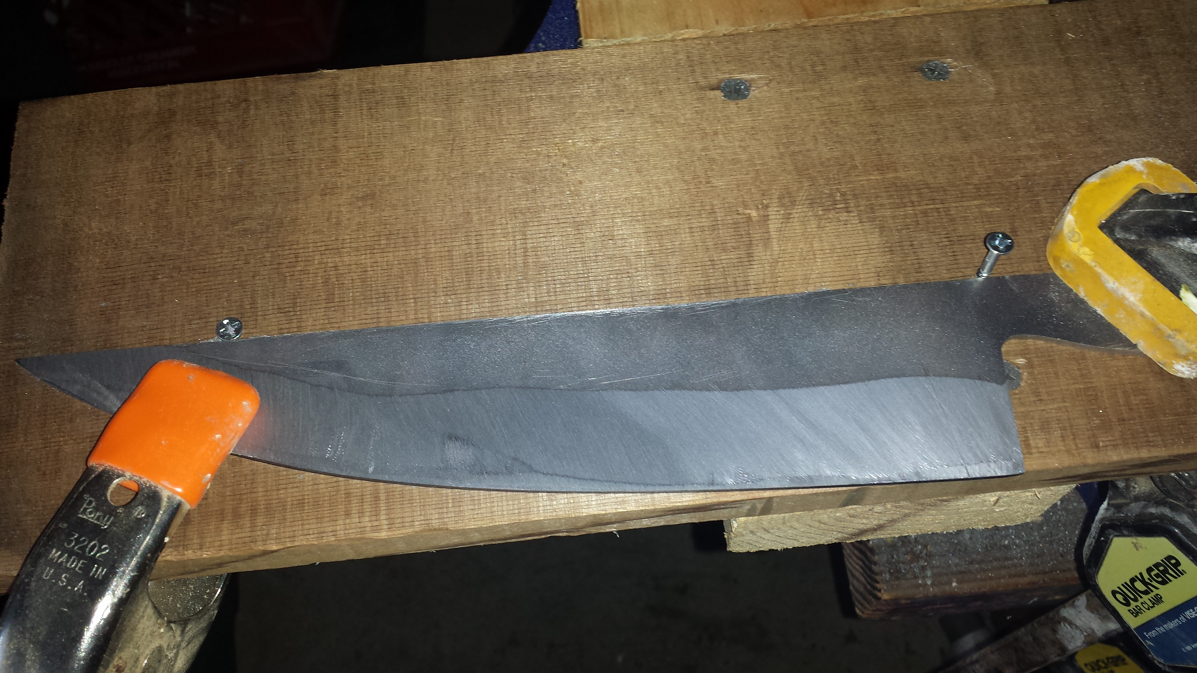

  18. I was using a jig. I tilted the file to get the depth and found out it was too much.

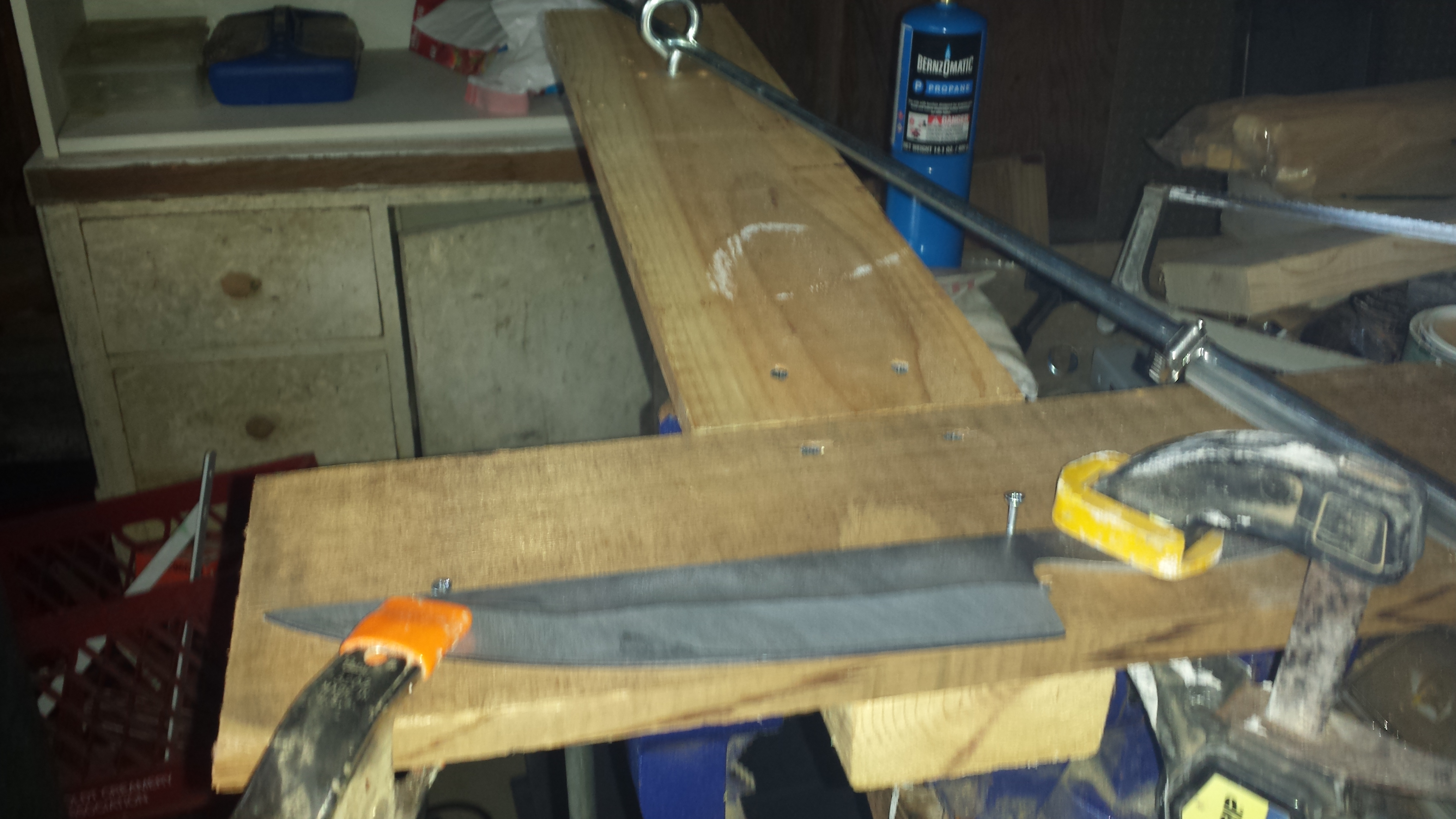

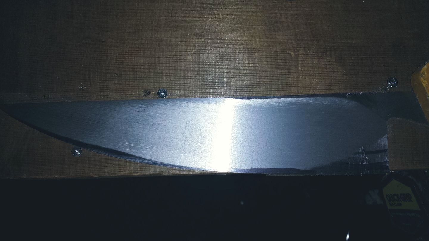

  19. bevels. Not quite satisfied with the first side i did and the thickness at the edge is a bit thick, but i would rather have it thick than thin. Bout a dime in thickness and there is a gouge at the riccaso in the first picture from me being over zealous making sure that i got it down to thickness.

  21. After much filing! Still not done... lol
