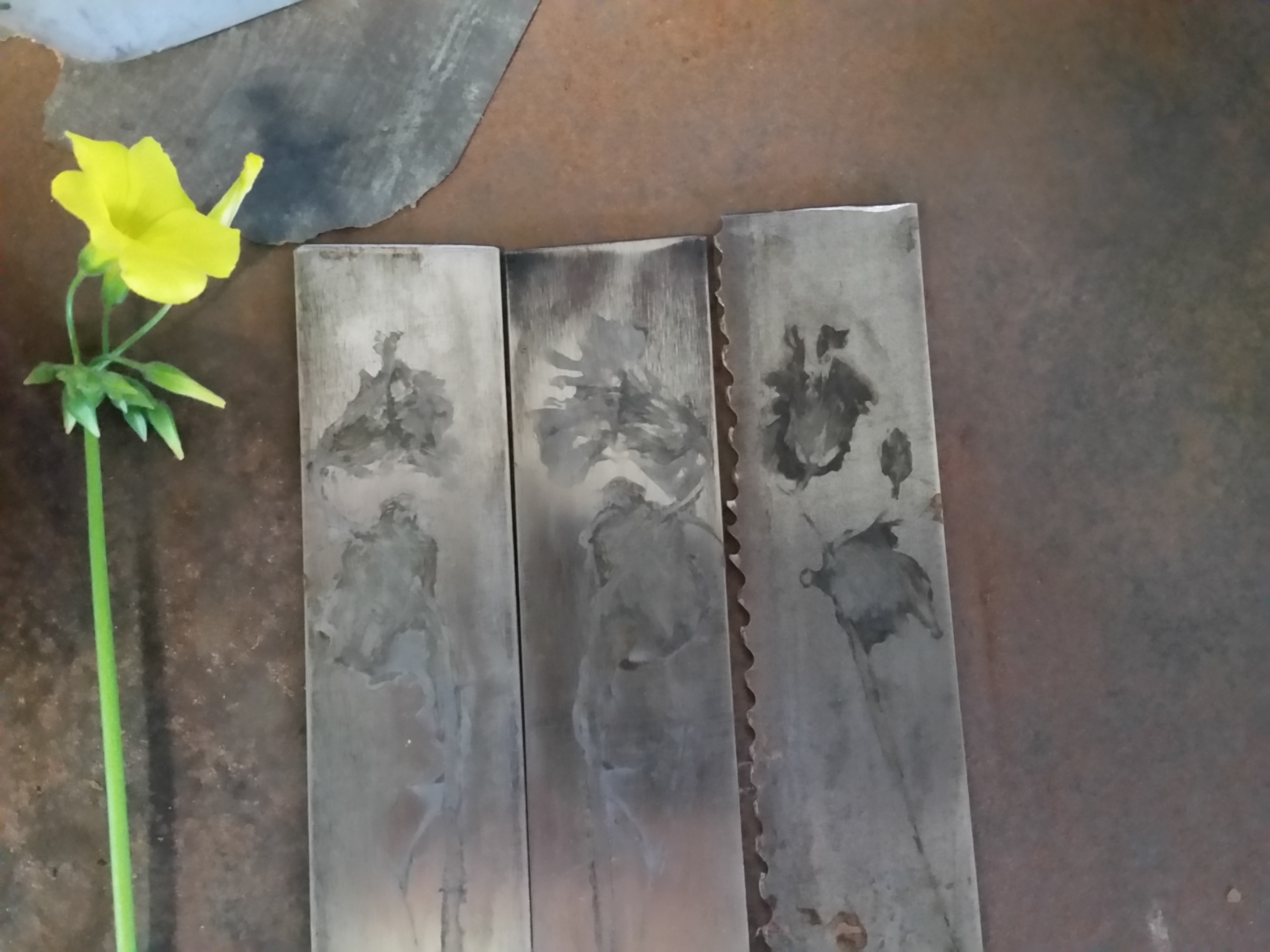

Anachronist58 Posted March 8, 2017 Share Posted March 8, 2017 Every now and then I shun my endless responsibilities, and do something fun, on a whim. Does anyone care to comment on what is happening, based upon the empirical evidence shown in these photos? The particular species of plant is key. Cheers, Robert Taylor Link to comment Share on other sites More sharing options...
tonyw Posted March 8, 2017 Share Posted March 8, 2017 Interesting. Is the pressed flower shape etched into the steel then? Link to comment Share on other sites More sharing options...
Andrew Martin Posted March 9, 2017 Share Posted March 9, 2017 3 hours ago, Anachronist58 said: The particular species of plant is key. Is that gray-green wood-sorrel? At least I think that's the name of what I'm thinking of. Occasionally I see a clump or two of that around here. Link to comment Share on other sites More sharing options...
Tubalcain2 Posted March 9, 2017 Share Posted March 9, 2017 if i'm seeing right you used the natural acids in a sorrel-like species of plant to etch the outline into a piece of steel by pressing it. am I close? Link to comment Share on other sites More sharing options...
Anachronist58 Posted March 9, 2017 Author Share Posted March 9, 2017 6 hours ago, tonyw said: Interesting. Is the pressed flower shape etched into the steel then? Yes 4 hours ago, Andrew Martin said: Is that gray-green wood-sorrel? At least I think that's the name of what I'm thinking of. Occasionally I see a clump or two of that around here. That's a wood sorrel. 3 hours ago, Tubalcain2 said: if i'm seeing right you used the natural acids in a sorrel-like species of plant to etch the outline into a piece of steel by pressing it. am I close? Yes. But it gets a bit more interesting. Link to comment Share on other sites More sharing options...
Anachronist58 Posted March 9, 2017 Author Share Posted March 9, 2017 So, the Latin name for this plant reveals its significance to some very specific metallurgical uses. Link to comment Share on other sites More sharing options...
JHCC Posted March 9, 2017 Share Posted March 9, 2017 1 hour ago, Anachronist58 said: So, the Latin name for this plant reveals its significance to some very specific metallurgical uses. Genus oxalis, from which we get oxalic acid, used in rust removal. Link to comment Share on other sites More sharing options...

Frosty Posted March 10, 2017 Share Posted March 10, 2017 Plants that aren't dead and dry are still photosynthesizing sunlight and are transpiring water. Laying on the steel means the steel is a natural condenser so what ever interesting chemicals the plant concentrates or manufactures is carried to the steel and both are subjected to constant moisture so long as there is light. Here's a tip for your survival skill kit. Putting a couple few green plants in a clear plastic bottle keeps them live and working. The water they transpire will collect in the bottle till the plants die. It's as pure as distilled. Not a lot but good for a little lip wetting every now and then. It takes a lot of lush plants and bottles to keep you hydrated in the desert. Why yes plants breath! Frosty The Lucky. Link to comment Share on other sites More sharing options...
AnBello Posted March 10, 2017 Share Posted March 10, 2017 5 hours ago, JHCC said: Genus oxalis, from which we get oxalic acid, used in rust removal. Also, "Acetosella". Acetic Acid, Vinegar, must mean something, right? Link to comment Share on other sites More sharing options...

Anachronist58 Posted March 10, 2017 Author Share Posted March 10, 2017 Andres Bello, I believe you are referring to the wood sorrel, 'Oxalis Acetosella'? Link to comment Share on other sites More sharing options...
Jack-O-Lantern Posted March 10, 2017 Share Posted March 10, 2017 This is awesome. Do a mural on sheet metal. Try cutting strips of the stem for a higher concentration. Or just for laying out patterns or anything else you can think of. How long was the flower pressed on for? Or was it just laid on the metal? Link to comment Share on other sites More sharing options...
AnBello Posted March 10, 2017 Share Posted March 10, 2017 10 hours ago, Anachronist58 said: Andres Bello, I believe you are referring to the wood sorrel, 'Oxalis Acetosella'? Yes, that was what I was referring to. It makes me think that the name might have been given because of certain properties. Not because vinegar content, but because of similar properties/corrosivity. After all, the word Acetic is strangely familiar to Acid... After that thought sparked, I went and looked for the etymology, and yes, Acetic is directly related to acid. Disclaimer: I certainly don't know the plant, since it lives in a completely different continent from me Link to comment Share on other sites More sharing options...
Anachronist58 Posted March 10, 2017 Author Share Posted March 10, 2017 Thanks all for your input! 17 hours ago, Frosty said: 21 hours ago, JHCC said: Genus oxalis, from which we get oxalic acid, used in rust removal. Thanks Frosty, I can hear Mrs Taylor now - "Robert! Your 2 liter bottles full of rotting plants are exploding in the driveway!" Seriously though, thanks for the stimulus. Yes, JHCC, and as a special etchant for detecting carbide precipitation in certain stainless steels. 14 hours ago, SLAG said: Oxalic acid is poisonous. Vinegar is unpleasant, but not poisonous. The etymology of Oxalis Acetosella would take some time to run down, if it could be traced to its origin at all. My species is O. Pes Caprae, Oxalis from the Greek/Latin, sour/sharp; Pes Caprae: foot (of) goat. With 900+ species of Oxalis, one could spend a lifetime investigating why Og named this one this, and Sven named that one that. "The preparation of salts of oxalic acid from plants had been known, at the latest, since 1745, when the Dutch botanist and physician Herman Boerhaave isolated a salt from sorrel.[7] By 1773, François Pierre Savary of Fribourg, Switzerland had isolated oxalic acid from its salt in sorrel.[8]" - Wikipedia. 2 hours ago, Andres Bello said: Disclaimer: I certainly don't know the plant, since it lives in a completely different continent from me Andres Bello, even in Argentina, there is a good chance that a wood sorrel lives near you. It is a Globally invasive genus. 12 hours ago, Jack-O-Lantern said: This is awesome. Do a mural on sheet metal. Try cutting strips of the stem for a higher concentration. Or just for laying out patterns or anything else you can think of. How long was the flower pressed on for? Or was it just laid on the metal? Gourd-Beacon, this was a very rushed and clumsy experiment. Were I to do this up proper I would lay down the plants more carefully, and introduce Oxalis juice concentrate through capillary wicking from a syringe. Also a high polish may surely be beneficial for good contrast. As seen on the strip of commercial bandsaw blade, which needed more sanding. All done with cast-off 400 grit wet/dry silicon carbide. Not shown is sheet metal gleaned from a beverage can, the interior of which was folded over the Sorrel. The ceramic surface showed no evidence of etching (under no magnification). Samples were pressed as shown for 48 hours. I also drew freehand on my rusty hardy anvil, which made a nice figure. Remember, water alone will etch steel, so consider that to be a bugaboo in this poorly controlled experiment. Robert Taylor Link to comment Share on other sites More sharing options...
