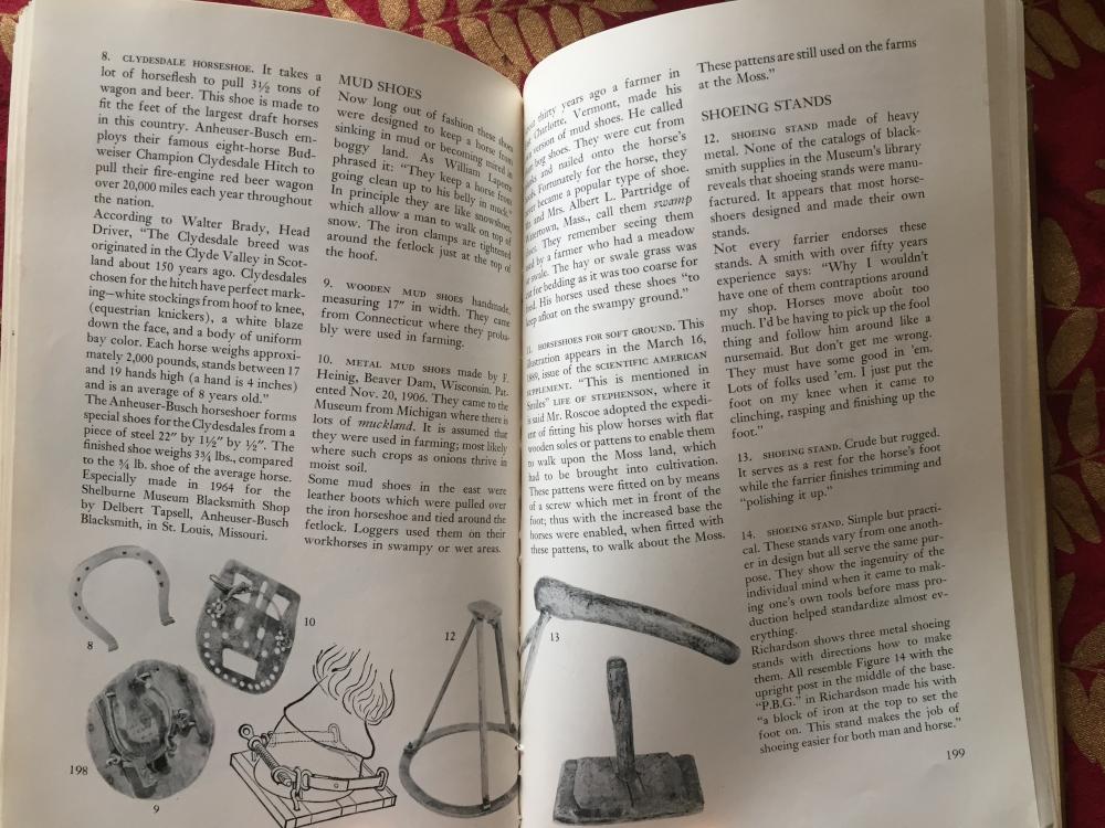

JHCC Posted December 22, 2016 Share Posted December 22, 2016 6 minutes ago, notownkid said: I've seen in museums horse snow shoes of wood with wire/light strapping type holders to go around the hoof??? I think they have some examples at the Shelburne Museum. I have a copy of their "Blacksmith and Farrier Tools" book out from the library; I'll check when I get home. Quote Link to comment Share on other sites More sharing options...

JHCC Posted December 23, 2016 Share Posted December 23, 2016 On 12/22/2016 at 8:37 AM, JHCC said: I think they have some examples at the Shelburne Museum. I have a copy of their "Blacksmiths' and Farriers' Tools" book out from the library; I'll check when I get home. Here are the relevant pages: Quote Link to comment Share on other sites More sharing options...
notownkid Posted December 24, 2016 Share Posted December 24, 2016 the wooden blank ones on the bottom are the ones I've seen in a number of NE Museums. I don't think I've ever had a horse that would have enjoyed these. Seen enough so some must have. Quote Link to comment Share on other sites More sharing options...
