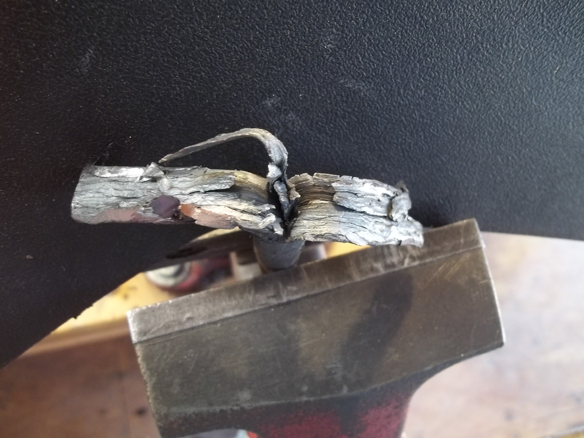

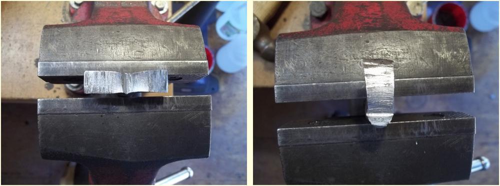

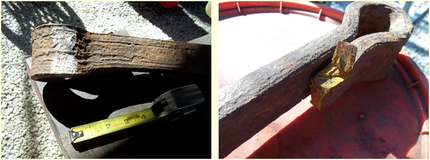

arkie Posted February 23, 2017 Share Posted February 23, 2017 I imagine that photos showing the difference between wrought iron and "steel" such as mild steel have been posted here on IFI, but from my searches it appears that earlier photos are no longer available on the site. So, in that regard, here are some that I took recently. My digital camera doesn't take close-ups very well, but here are some comparisons. The photos include a comparison of two 1/2" round rods, one wrought iron and one mild steel. Each was cut part way down with a hacksaw then split apart. You can see the fibrous structure on the wrought iron and the microcrystalline appearance on the mild steel (the shiny one with one ear broken off). Also included is a large bar, probably from a piece of old farm equipment that was folded over forming an eye. I cut through part of one end on the eye and bent it back to show the fibrous structure (you may have to zoom in on that one). The clue to the bar probably being wrought iron was the linear weathering along the bar. It's about 3" wide and 1/2" thick. Must have been fun bending that piece over. Now, I'd like to figure out what to make from the large piece, or maybe just cut it up for several projects. Link to comment Share on other sites More sharing options...

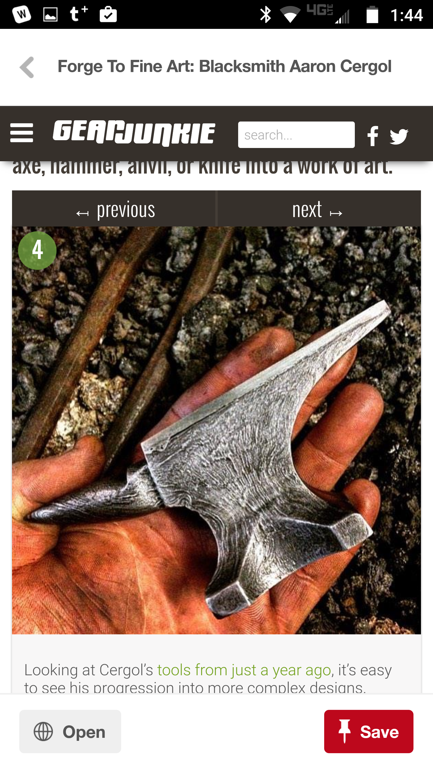

Donniev Posted February 24, 2017 Share Posted February 24, 2017 Make one of these? Link to comment Share on other sites More sharing options...
arkie Posted February 24, 2017 Share Posted February 24, 2017 I'm afraid those are a bit above my skill level...would be neat to do, though. Link to comment Share on other sites More sharing options...
