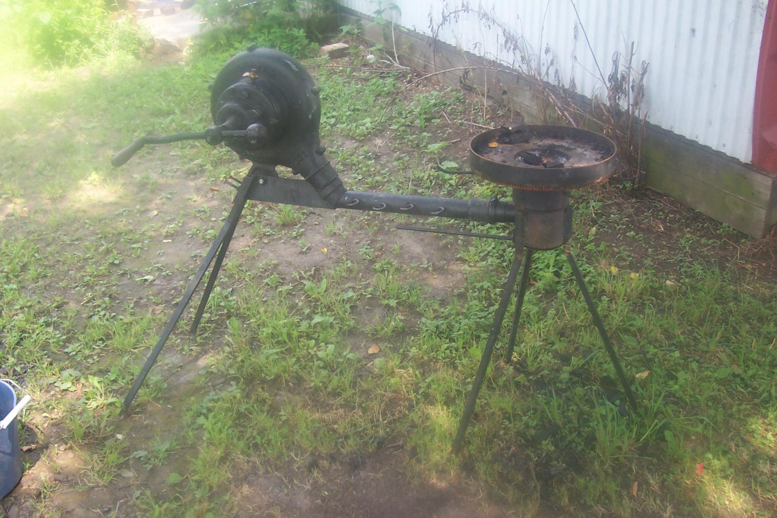

As far as the forge, I was thinking about making a portable coal/coke forge using an old turkey fryer that I have for the legs and fabricating a table using some heavier sheet metal I have. I haven't done it yet and probably won't any time soon, just sharing my ideas.

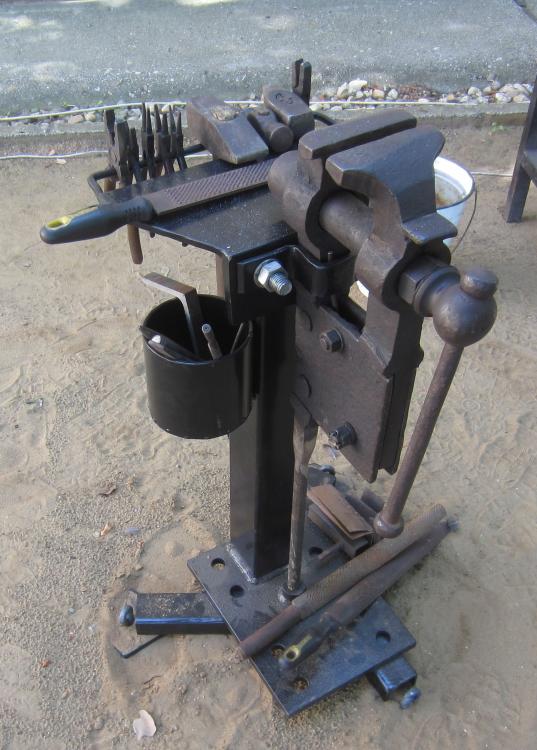

These work good for me. Both built after Aspery's instructions found in the Skills of the Blacksmith vol. 1. (Minor modifications done as the scrap sources dictated them.)
The anvil weighs 114 lbs. The vise is a 4"-er. With this type and size of vise stand the securing nails (10-20") are a must if heavier work is done.

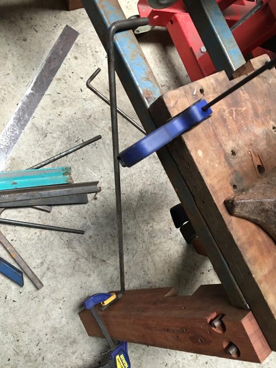

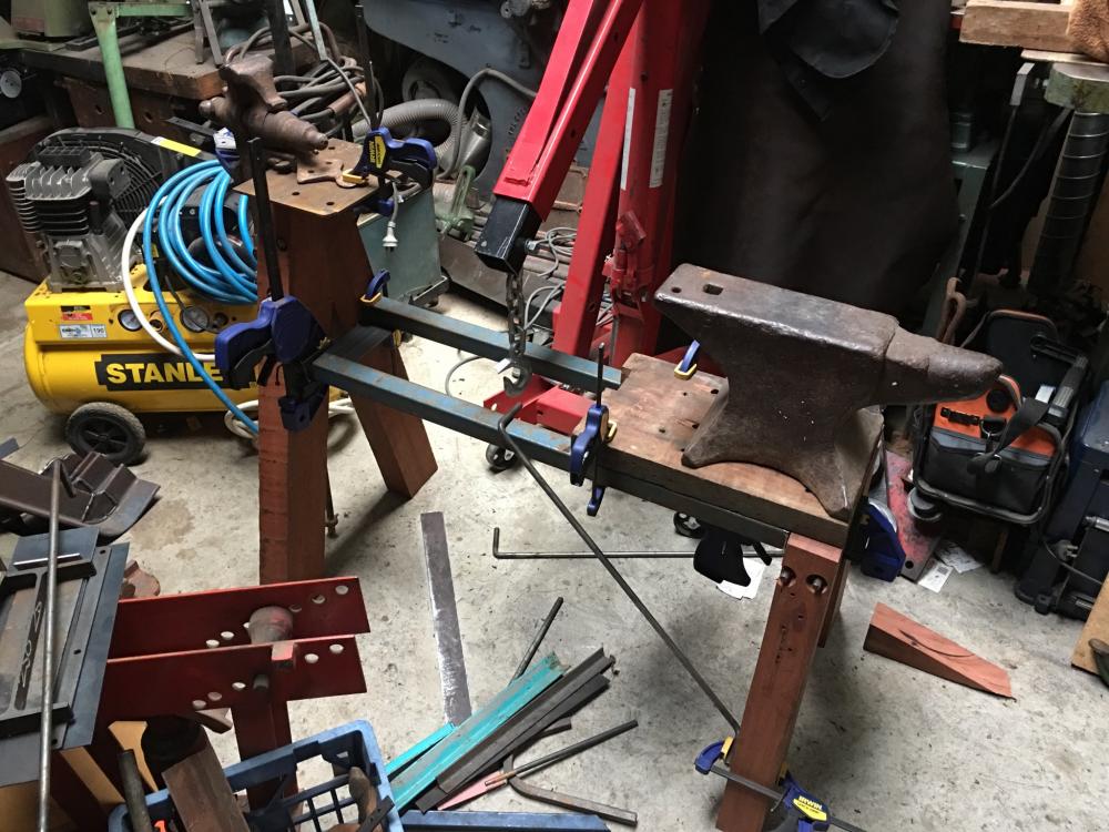

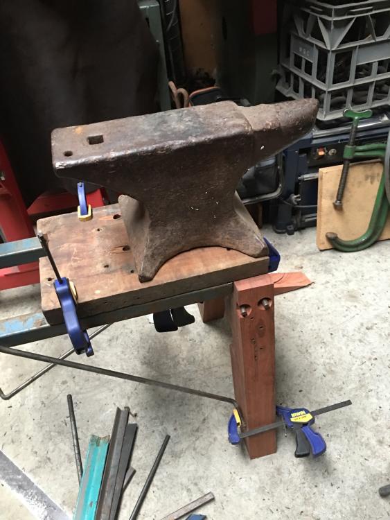

So this is what I'm going to try out.  It will knock down into three main parts, two wooden A frame ends and a steel centre piece.
I have some z shaped cross bracing that will have a saddle on the wood and pass through a hole in the steel. Hopefully it will hinge for dpackdown and bolt in and stay put when assembled.
There is going to be a bracket in the centre which will sleeve a removable post for the stake anvil.
A seperate small plate with a hole will go under the foot of the leg vise.  Also thinking to add a few eyes to the legs for some hold down stakes.
Between the steel rails, I plan on adding some racks for hammers, tongs and chisels.
