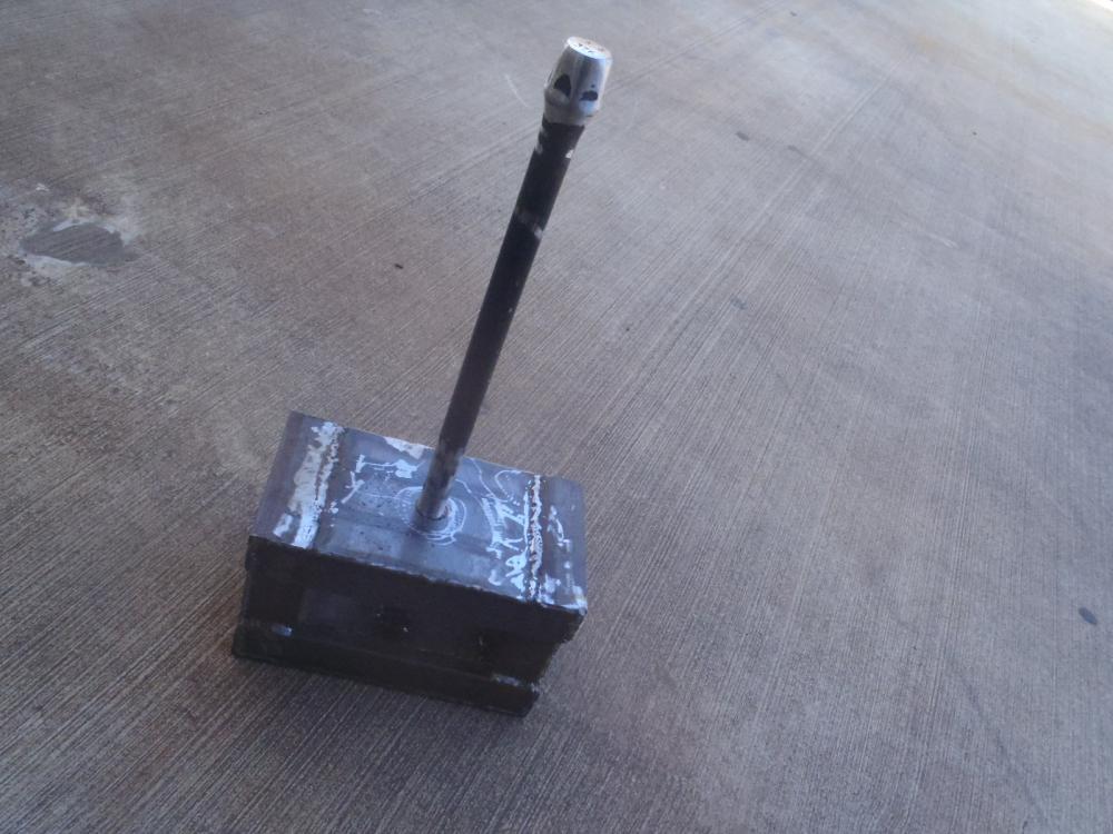

treytheknifeguy Posted July 26, 2016 Share Posted July 26, 2016 i got some 30mm rebar in the workshop and i wanna try making some hammers from it i cant see to find anything about using it for this only people making tongs knives and spears I've used 1/4" for blades before but i have no idea about using 30mm Quote Link to comment Share on other sites More sharing options...
Mark Ling Posted July 26, 2016 Share Posted July 26, 2016 What would the hammer be used for? Otherwise no don't use it, get some known steel-if your going to go through all the trouble to make a hammer you might as well use steel that you know you can heat treat properly, and can actually harden, some rebar hardens, other doesnt, for me that's to much of a gamble. Littleblacksmith Quote Link to comment Share on other sites More sharing options...

treytheknifeguy Posted August 1, 2016 Author Share Posted August 1, 2016 i was thinking i might be able to try rail spikes for a small hammer because they seem to make alright tomahawks and i also have a bit of 4140 chromoly i was gonna use for a machining project but ill never end up getting it done so maybe some of that could work ive made a center punch from it and that worked so why not Quote Link to comment Share on other sites More sharing options...
ThomasPowers Posted August 1, 2016 Share Posted August 1, 2016 HC spikes are just under the low carbon/medium carbon line. I'd use a piece of old crowbar that is generally medium carbon before I'd use a spike...or a chunk of 1050 jack hammer bit, or a car axle, or... Quote Link to comment Share on other sites More sharing options...
Mark Ling Posted August 1, 2016 Share Posted August 1, 2016 1 hour ago, treytheknifeguy said: and i also have a bit of 4140 Out of all the steel that would be MY choice. Littleblacksmith Quote Link to comment Share on other sites More sharing options...
treytheknifeguy Posted August 2, 2016 Author Share Posted August 2, 2016 i found a peice of rail track lying around the workshop yesterday and made a chisel out of it and it works pretty well so ill have to get some more and try making hammers Quote Link to comment Share on other sites More sharing options...

treytheknifeguy Posted August 10, 2016 Author Share Posted August 10, 2016 well the head on the rail is already pretty close to the shape of a sledge hammer i could probably cut a small hammer out of a large peice i rekon it would be easier if i cut out the rough shape then forged it the head of the larger rail here is about the size of a fist Quote Link to comment Share on other sites More sharing options...
ThomasPowers Posted August 10, 2016 Share Posted August 10, 2016 Chop off the web and do a little press work on it hot and I think it would be very much a hammer stock preform. Quote Link to comment Share on other sites More sharing options...
treytheknifeguy Posted August 10, 2016 Author Share Posted August 10, 2016 now i just need to get some more because i only have the one length of large rail and im using it for an anvil and the small stuff is to soft Quote Link to comment Share on other sites More sharing options...
ThomasPowers Posted August 10, 2016 Share Posted August 10, 2016 Have you tried hardening the small stuff? Quote Link to comment Share on other sites More sharing options...
treytheknifeguy Posted August 11, 2016 Author Share Posted August 11, 2016 i made a chisel from the smaller rail but it didnt harden as well as i hoped track work hardens doesnt it maybe thats why it didnt harden i know the smaller stuff isnt as hard as the larger rail because i have a small track anvil i made by cutting it to shape drilling a hole in it and milling the top but it dents very easily the larger stuff has better rebound and is similar to the anvil in the workshop at school so i use it as is Quote Link to comment Share on other sites More sharing options...
