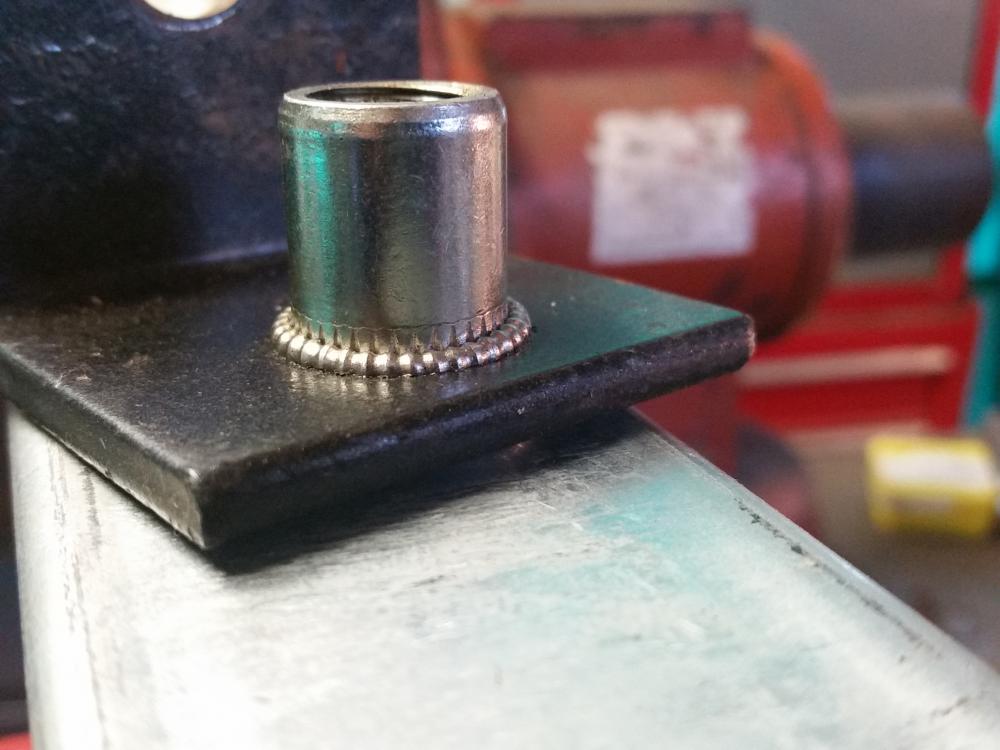

I know that "pretty darn strong" is not a real answer, but I will have to trace back the specs.
As for how they stay in:  See the corrugation on the non-installed nut? That mushrooms out when you draw the nut, as pictured.
Those wrenches, greasy nuts, & greasy washers, stand in for a $260.00 nut drawing tool. The GREASY part is VERY important.

They use them on cars. The good ones in metal parts are usually good. Cheaper ones not so good. And I pull my hair out when the put them in plastic parts.
The ones you show look like the good ones as long as you squash them good and they are a snug fit to begin with so those splines do their job. If it isn't coming apart I don't think there would be an issue as long as you start the bolts in proper.

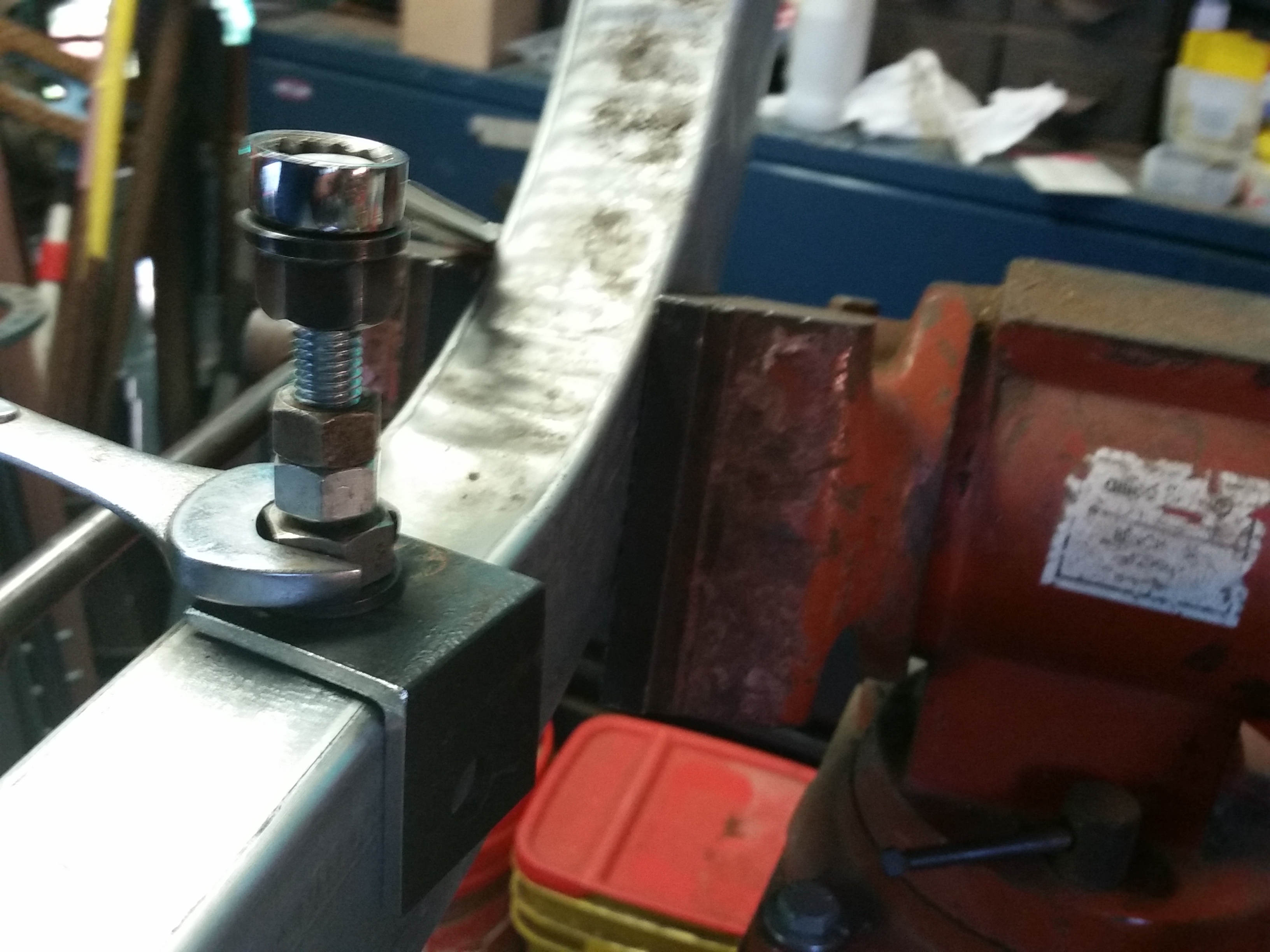

Those are cool.  I had never seen a Rivnut before.  Thanks for posting.  You showed setting the nut in a open piece of steel (angle iron, maybe) with a bolt and backup nut on the backside.  How do you expand and set it in square tubing like you had pictured?  I have one of those metal carports with the square tubing posts and the rivnuts would be perfect for hanging stuff.
Arkie, I woke up dreaming this morning about eliminating one of the unwieldy stop wrenches from my design. I will post the upgrade here today, barring any unforseen eventualities.
In order to give you maximum satisfaction, I want to know what size machine screw you have in mind, plus the gauge and dimensions of your square tubing.
Smaller gauge RivNuts install like pop rivets :).

OK, that dream I dreamed was a good one, less is definitely more:
Here it is stripped of all the bells & whistles:
The angle isolates the RivNut from rotating. Next you can see how well the high grade ones dig in:

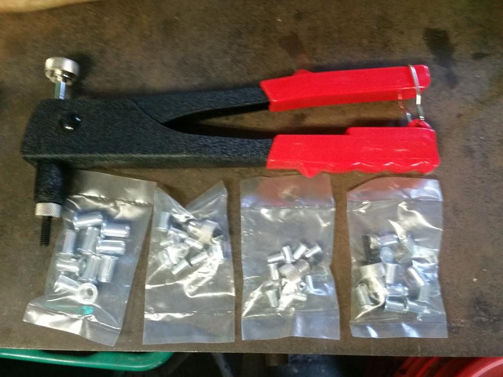

Here's the cheap HF set - aluminum and up to 1/4-20:
