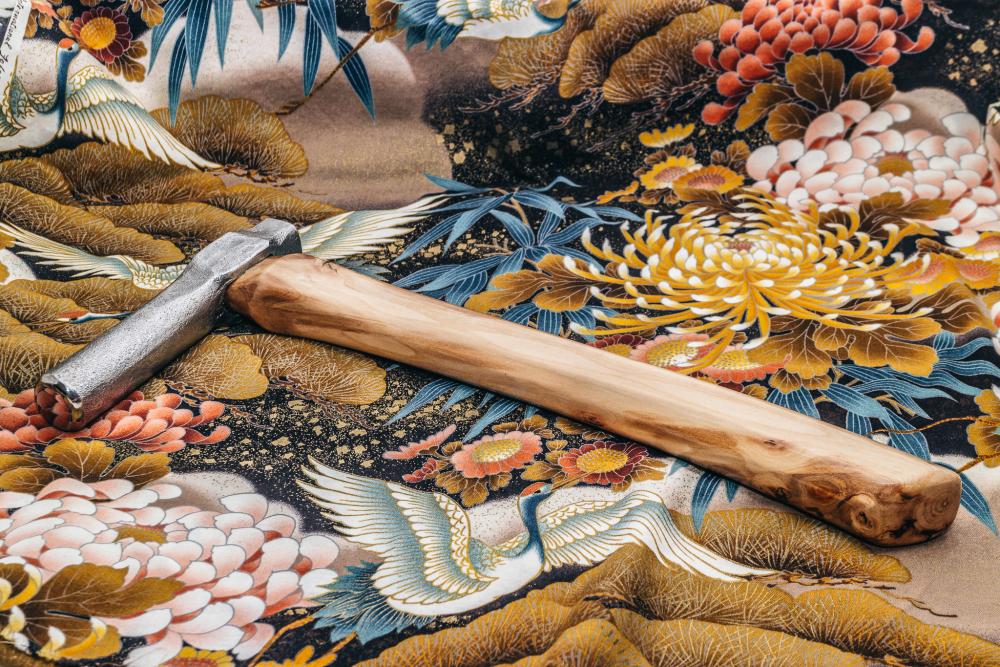

June 15, 201610 yr I recently found a roller bearing that I thought was the perfect size for a hammer for sheet metal work. A little slitting and drifting later and here it is. The head is a bit over 1 pound and I left the face fairly hard. The handle is apple which turned out to have some beautiful grain near the end, I'm hoping the knots won't weaken it too much. The head is attached with polyurethane glue. I don't use wedges anymore unless it's for aesthetic reasons and I have yet to have a glued head come loose. Thanks for looking.
June 15, 201610 yr Boy that turned out nice. Don't think that knot half way down will weaken it any but it might be a blister point. Might be a little to nice to use, maybe you'd better sent it out this way to hang on the wall and look pretty
June 15, 201610 yr Very nice job. I was planning to use some 2 lbs roller bearings to make hammers. I wasn't sure though is 52100 good material for that - have you tried it yet? Any chipping or cracking? Thanks for sharing and best wishes: Gergely
June 16, 201610 yr Author Thanks for the comments guys. It's not too pretty to use but so far I've been scared to throw it in the bucket with the rest of my hammers and scuff up the handle. On 6/15/2016 at 5:46 AM, Gergely said: I was planning to use some 2 lbs roller bearings to make hammers. I wasn't sure though is 52100 good material for that - have you tried it yet? Any chipping or cracking? I've done some test hammering with it but haven't used it extensively yet. I think 51200 will make a fine hammer as long as you get the temper right. I used a propane torch and drew the face to straw and the rest to blue but with a heavier hammer I would try to get the face a little softer.
June 19, 201610 yr Very nice work, and good photography, too. What's the story with this glue you're doing? I'd love to hear more about the prep and application.
June 21, 201610 yr Author On 6/19/2016 at 8:54 AM, VaughnT said: What's the story with this glue you're doing? I'd love to hear more about the prep and application. I do it pretty much how Hofi does it here but I use shoe goo instead of sikaflex. After the glue has had a few days to dry I soak the end grain at the top of the handle in linseed oil.
June 22, 201610 yr So since the head doesn't rely upon reverse tapers do you shape the handle hole differently?
June 23, 201610 yr Author On 6/22/2016 at 6:12 AM, arftist said: So since the head doesn't rely upon reverse tapers do you shape the handle hole differently? No it's a standard hourglass shape. I figure that way metal wedges can be added or it can be re-handled in the usual way later on, plus once the glue dries it forms a mechanical lock as well as the adhesive one.
June 23, 201610 yr 2 hours ago, navasky said: No it's a standard hourglass shape. I figure that way metal wedges can be added or it can be re-handled in the usual way later on, plus once the glue dries it forms a mechanical lock as well as the adhesive one. Good. Thanks
June 23, 201610 yr On 6/21/2016 at 1:22 PM, navasky said: I do it pretty much how Hofi does it here but I use shoe goo instead of sikaflex. After the glue has had a few days to dry I soak the end grain at the top of the handle in linseed oil. navasky, you say "shoe goo" (which is a styrene-butadiene copolymer), but above you said "polyurethane glue" (i.e., Gorilla Glue). Que pasa? (The Shoe Goo thing sounds interesting, not only because I'm making a similar hammer, but also because I need to get some to fix my boot soles.)
June 25, 201610 yr Author On 6/23/2016 at 0:15 PM, JHCC said: navasky, you say "shoe goo" (which is a styrene-butadiene copolymer), but above you said "polyurethane glue" (i.e., Gorilla Glue). Que pasa? Oops you caught me, it is indeed styrene butadiene copolymer.
