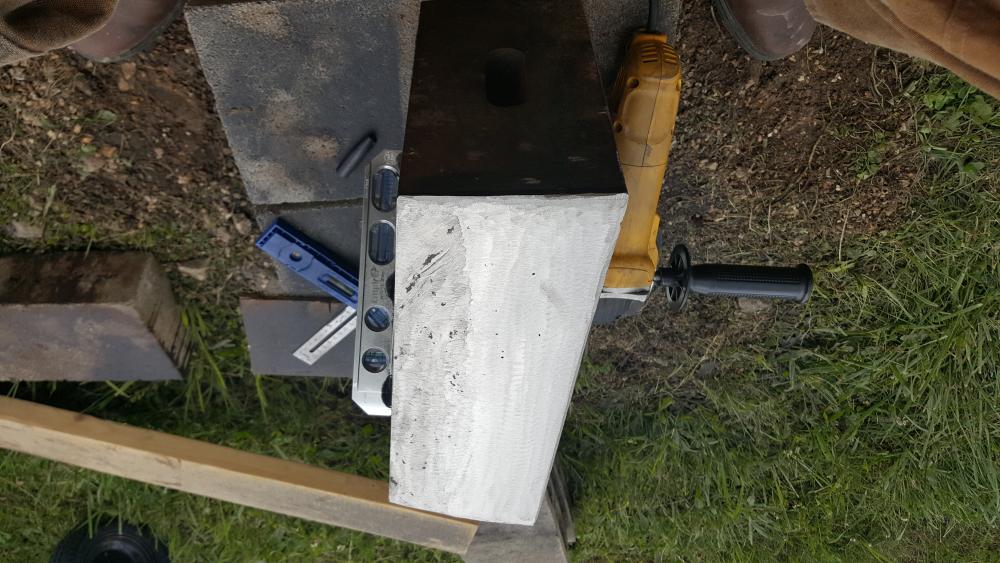

brianstucker Posted May 19, 2016 Author Share Posted May 19, 2016 I got a piece of rr track around 14" long. And a buddy of mine had a piece of 10" x 12" x 6" die steel. Bought it for 50$. I dropped a hammer on it and it rebounded around 80% Quote Link to comment Share on other sites More sharing options...
Mark Ling Posted May 19, 2016 Share Posted May 19, 2016 That looks nice! Told you that you would find something! Good price. I recomend that you turn it on edge for more mass under your hammer and radius the edge, great rebound though. Littleblacksmith Quote Link to comment Share on other sites More sharing options...
brianstucker Posted May 19, 2016 Author Share Posted May 19, 2016 It's got a slightly angled side. If I turn it on its side it won't sit straight up and down. It weighs around 200lbs. Quote Link to comment Share on other sites More sharing options...
SLAG Posted May 19, 2016 Share Posted May 19, 2016 Crp...how about shimming it? SLAG. Quote Link to comment Share on other sites More sharing options...
brianstucker Posted May 19, 2016 Author Share Posted May 19, 2016 The top is 10"x12. The base is 131/2 x 11 1/2. I could shim one side but the top side will be at an angle. Quote Link to comment Share on other sites More sharing options...
Rmartin2 Posted May 19, 2016 Share Posted May 19, 2016 8 hours ago, crappiew said: The top is 10"x12. The base is 131/2 x 11 1/2. I could shim one side but the top side will be at an angle. Nice score! Is it possible to build a stand to accommodate the angle on the bottom and grind the top flat? Quote Link to comment Share on other sites More sharing options...
brianstucker Posted May 19, 2016 Author Share Posted May 19, 2016 Possibly. But I have a buddy who is a machinist. I'm gonna talk to him about Cnc milling it. Quote Link to comment Share on other sites More sharing options...
