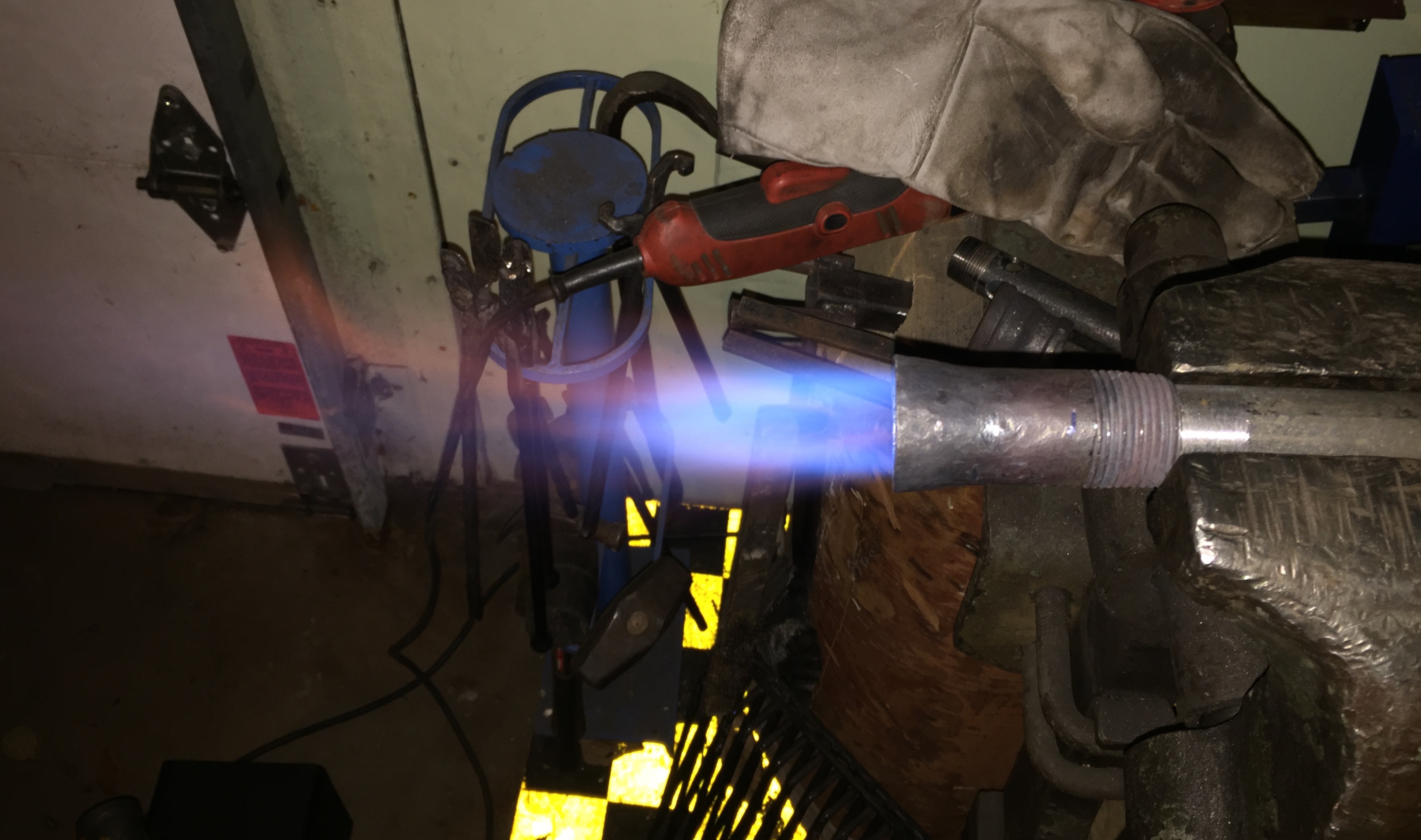

Mikey98118 Posted June 2, 2017 Author Share Posted June 2, 2017 2 hours ago, blacksmith-450 said: I am one of the new ones but I assure you that I do my homework before asking a question. However following the recipe is not so easy. Well than, lets have a look at your flame, first: What a mess! However, if you put it in a forge, facing on a tangent to give that long monster of a flame enough flame path, you would probably be surprisingly satisfied. Why? because the very long tertiary flame (in the place of the usual long secondary flame), appears--according to its color--to be a very hot neutral one. However, knowing what I do, I can tell you that it cannot help but be slightly oxidizing. I know this because it is an inevitable consequence of the primary and secondary flame envelops that precede it. The inner white envelope that should have been clear, and the secondary blue-green envelope, which should have been a primary of the same blue we can see in the tertiary envelope. So why do I say It HAS to be at least somewhat oxidizing? Not because of its color, but what I see in the colors of the two preceding flame envelopes. The white flame is carbon rich, which made the second envelope burn fuel rich, which must lead to the teriary flame being exposed to too much super-heated oxygen to completely combust it all; fun ha? It's kind of like a seeing a car "hydraulic" on a wet road, out of control, and heading for the ditch. Only, instead of disaster, you can make use of the mess So, how did you get here? Looking at this 'Reil' burner, I see a very strange thing; instead of the expected mixing tube tucked inside of his recommended flame nozzle, there is a smaller pipe threaded inside of the mixing tube!!! The wonder of it is that this burner works at all...on the other hand, it plainly does Quote Link to comment Share on other sites More sharing options...
blacksmith-450 Posted June 3, 2017 Share Posted June 3, 2017 1 hour ago, Mikey98118 said: So, how did you get here? Looking at this 'Reil' burner, I see a very strange thing; instead of the expected mixing tube tucked inside of his recommended flame nozzle, there is a smaller pipe threaded inside of the mixing tube!!! The wonder of it is that this burner works at all...on the other hand, it plainly does Thanks Frosty and Mickey That's what surprises me the most and I do not understand. The Reil burner is quite easy and here are my parts as described instructions: Reducer 1-1/2 to 3/4 Nipple 3/4 X 6 inches 1/8 Tube with no.57 hole Flare To make the flare I took a 1 inch tube and I forged it. It simply slides over the 3/4 mixing tube. That's why I wonder why it does not work (look) as supposed...? although I get a hot flame... Quote Link to comment Share on other sites More sharing options...
Mikey98118 Posted June 3, 2017 Author Share Posted June 3, 2017 Well, if I may add to your confusion; your burner's flame is hotter than his original burner's is. You can build burners EXACTLY according to the designer's plans, and have the right to demand expected results. Or, you can change them as seems right in your eyes, and hope for expected results. Or, you can spend eighteen years learning all you need to know, in order not to be surprised very often by results, like I did; these are your choices. what will it be? BTW, if you place an internal bevel on the threaded end of your flame nozzle, it should improve that burner's flame. Quote Link to comment Share on other sites More sharing options...

blacksmith-450 Posted June 3, 2017 Share Posted June 3, 2017 56 minutes ago, Mikey98118 said: But air-fuel flames are different, and I'm still learning new things about them. As long as you learn, you do not die ! That's my mindset I remade a tube with a hole no.60. The flame is 100% blue. However, there are orange flames. I guess I must now focus on the flare adjustment. Quote Link to comment Share on other sites More sharing options...
Mikey98118 Posted June 4, 2017 Author Share Posted June 4, 2017 Orange flames near a flame nozzle are usually a sign that the nozzle is being slowly oxidized away. You have a mild steel nozzle, and I can see scale on it; so, the orange streaks are not unexpected. You can even get orange streaks from using #304 stainless steel, instead of #316, you can cet orange streaks from failing to file off a small burr or ding in the nozzle's edge. I saw one orange streak marring a perfect flame on a "T" burner bcause of a tear in the ceramic blanket that was touching the burner nozzle. So, it wouldn't hurt to work on your nozzle more, but you basically have a very hot flame exiting that burner. Can you do a little bit better? Yes; do you need to? Probably not. Quote Link to comment Share on other sites More sharing options...
blacksmith-450 Posted June 4, 2017 Share Posted June 4, 2017 1 hour ago, Mikey98118 said: Can you do a little bit better? Yes; do you need to? Probably not. Mike, thanks really much for your patience. I try hard to be an achiever... i add some hammer hit on the flare... a little sand paper and I got this : Quote Link to comment Share on other sites More sharing options...
Frosty Posted June 4, 2017 Share Posted June 4, 2017 Don't feel self conscious or anything, you're doing fine, better than most in fact. You're listening, trying suggestions and telling us what happened. You're the kind of person that makes helping a joy. Cleaned out some of the scale like Mike suggested and viola' it's looking good, darned good. Well done. Frosty The Lucky. Quote Link to comment Share on other sites More sharing options...

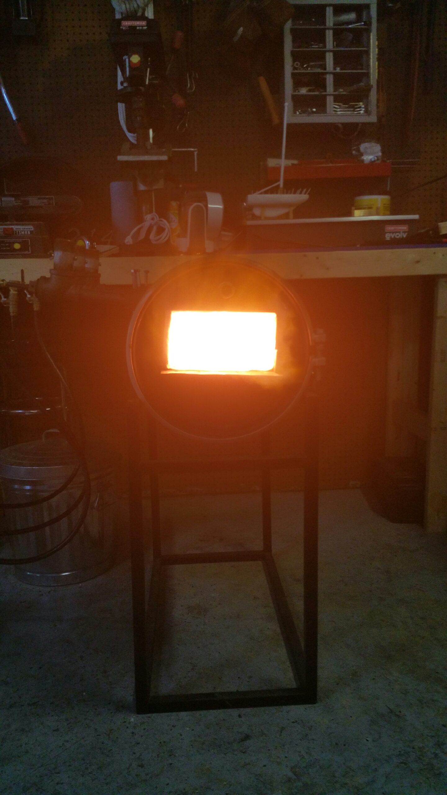

Mberghorn Posted June 5, 2017 Share Posted June 5, 2017 So I finally had the chance to put my rebuilt side-arm burners back in my forge this weekend. I fired them for the first time to set the rigidizer I applied to the fiber blanket. I must say I'm pleased with the results! This is less than a minute after lighting them off I started off at about 2 psi and was not displeased with the results! This was after turning it up to 10. Just for a comparison, this is the same forge, minus the rigidizer, running at around 8 psi before I found IFI and rebuilt my burners. I had my chokes wide open for the whole pressure range so I'm debating on whether or not to remove the choke tube completely. Also, I forgot to remove my nozzles before inserting them into the forge. I'm not sure how much of a difference it makes but I just thought I'd put that out there. Let me know what you guys think!! S/F Quote Link to comment Share on other sites More sharing options...
