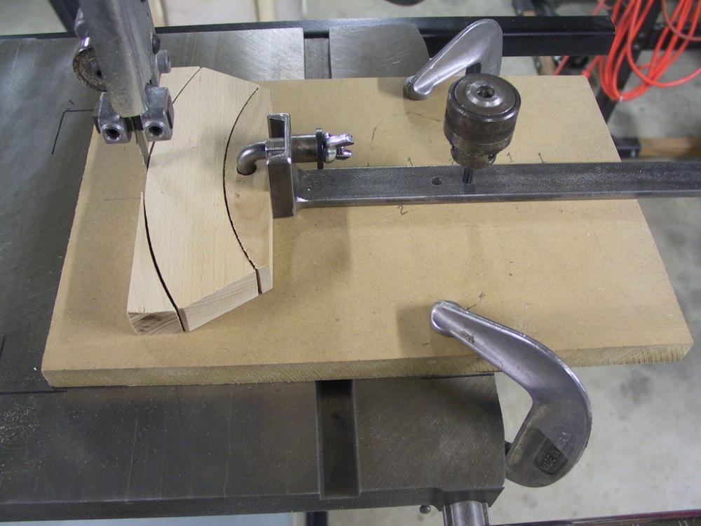

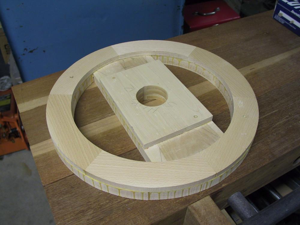

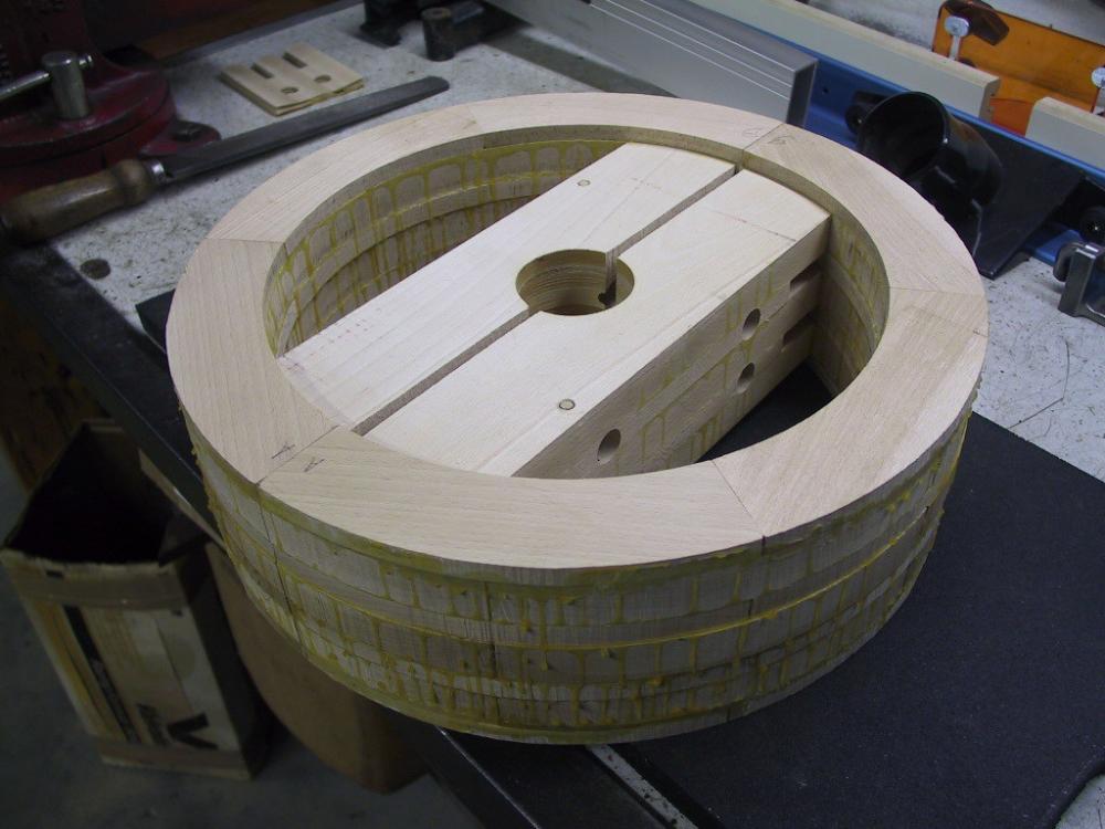

Sanderson Iron Posted April 5, 2016 Author Share Posted April 5, 2016 Thank you Turbo. My father-in-law (my FIL, Thomas ) and I have made some pulleys for the shop, and I think it might interest folks to see how we've gone about it. So far, we've made one split pulley of the Reeves design, and two cone pulleys: one for the horizontal mill, the other for the lathe. These are made of maple and glued with TightBond2. I have no woodworking tools other than a Disston hand saw (which I bought at a blacksmiths' conference!), so he did the woodwork and I did the metalwork and final turning in the lathe. The following shows the process to make a Reeves pulley. It's a lot of work, but when you need a certain size, there's not a lot of choice. We did this in 1999, before I had accumulated a pile of reserve pulleys. However, sometimes you still need one you don't have. At the time of this writing, he's making two more pulleys for me, soon to be used over the new engine. I made him a radii turning tool for his bandsaw to cut the inside and the outside curves of the wood. This has a simple clamp that holds the wood by pulling at a drilled hole. There are two holes in the fixture: one for the inside radius, the other for the outside radius. By changing the pin from one hole to the other, both radii may be cut in one set up. The first two pictures should explain this. The center of the pulley is composed of straight boards with an undersized hole for the bore. The entire pulley is assembled whole, to be cut in half later. My father-in-law used his press to gently squeeze the layers together. When the full stack is finished, it is cut in half and drilled for the bolts and alignment pins. This is a 16" pulley, so I was able to hold it nicely in my 19" lathe to bore the center and turn the outside, with a slight crown of course. Joel Quote Link to comment Share on other sites More sharing options...

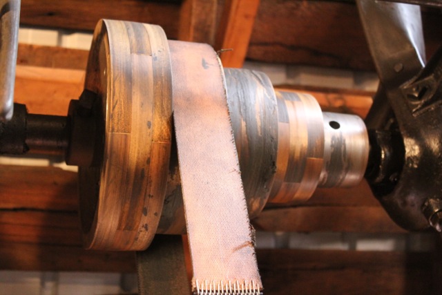

Sanderson Iron Posted April 5, 2016 Author Share Posted April 5, 2016 Cone pulleys are commonly missing from machines, since too often at some point some smart person decided to toss the cone pulley in favor of an electric motor and a gearbox or some other heinous contraption. It's a shame that happens so much. Cones are always in pairs, each one meant to be part of the machine, and their dimensions are critical, more so than first meets the eye. Cones of more than two or three steps are not composed of equal steps. For example, if the first step has an 8" diameter, the other steps might seem to be two inches larger, measuring 10", 12", 14" and 16". But this is not true. If a belt is put on a cone with equally different steps, the belt will be loose on the center steps and tight on the ends. Therefore, it is necessary to make the center steps of slightly larger diameters. There are different formula to figure this. The Complete Practical Machinist by Rose (1894) gives one formula, and the Machinery Handbook gives another slightly more precise formula. I'm saying this so that if anyone reading this makes a cone pulley, be sure to do the math to figure out the final dimensions, or you may be disappointed. Again, we made the cone pulleys out of maple. The wood is screwed to steel plates with hubs on the ends to fasten to the shaft. On the lathe's cone, the smallest diameter step is steel and serves as that end's hub; its outside diameter was turned last, along with the other steps' diameters. It's fastened to a plate and screwed to the wood as on the other end. I have never had a problem with these pulleys. However, I will say that dressing tends to build up on wooden pulleys while it doesn't on metal ones. The first four images show the five-step cone for the lathe; the remaining images show the three-step cone for the mill. Quote Link to comment Share on other sites More sharing options...

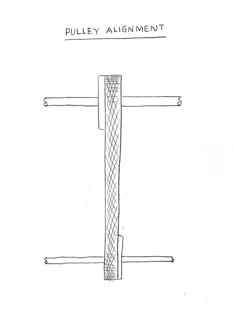

arftist Posted April 9, 2016 Share Posted April 9, 2016 Very very nice. Makes my lifetime collection of a few clutches and cone pulleys look pathetic. One question, the drive pulleys must be flat? The only machine I built specificly with a flat belt I used crowned pulleys at both ends. It works. Would it work better if the drive pulley was flat? Thanks for the photo tour. I especially like that you heat the shop with waste heat. Quote Link to comment Share on other sites More sharing options...
Sanderson Iron Posted April 11, 2016 Author Share Posted April 11, 2016 On April 9, 2016 at 10:07 AM, arftist said: One question, the drive pulleys must be flat? The only machine I built specificly with a flat belt I used crowned pulleys at both ends. It works. Would it work better if the drive pulley was flat? Sorry it took me so long to answer you. Been busy. The only pulleys that shouldn't have a crown are the ones which are opposite a tight and loose pulley. That is so the belt can move across the pulley as it is shifted from one to the other. Otherwise a pulley should have a crown. A crown keeps the belt in the center of the pulley because the larger diameter at the crown is doing more work, pulling more belt, than the edges are doing. Imagine if you had two ropes tied to a log at the other end of the yard, and you pulled one rope and your lazy neighbor pulled the other rope more slowly than you; pretty soon the log would be following along behind you and not your lazy neighbor. That's what happens with a crowned pulley too. If you have an 1/8" crown on a 30" diameter pulley turning at 200 RPM, the crown is pulling 6.5 feet more belt per minute than the rim is pulling. That's something, isn't it? Unless you understand why a belt centers on a crown, like I just explained, it would seem like a belt would want to climb to the high side when two shafts are not in line, but it does not. In fact, a belt falls off the close side. In the first sketch below, I have drawn a pair of shafts and pulleys on which the belt is riding to the right, in the direction of the arrow at the bottom. This indicates that the shafts are closer on the right (B) than the left (A). If you move the countershaft farther away on the right, the belt will track in the center of both pulleys. In the next image I have sketched a pair of pulleys where the belt is riding to the right on one pulley and to the left on the other. This indicates that the pulleys are the ones which are not in line, not the shaft. If you slide them towards each other on the shaft, the belt will track properly. Shafts are never perfectly in line. If you could have a pair in perfect parallel, there would be no need for a crown at all, but that's not how things work. The belt stretches and makes up for the imperfections in the alignment. (Which is a good reason to use new belts.) The longer the belt, the more forgiving it is, because it has more stretch. This means that two shafts close together are more trouble to align, so if you have a choice, belt your pulley to a distant shaft rather than to a close one. I did that with my shaper. I could have belted it just four feet away, off the first line, but instead I belted it across the room to the north line so I'd have a longer belt that would give less trouble. Anybody interested in some clutches I made, or is this getting too nitty-gritty? Joel Quote Link to comment Share on other sites More sharing options...

Sanderson Iron Posted April 11, 2016 Author Share Posted April 11, 2016 I just got an email from my father-in-law showing the progress he's making on the new pulley. This pulley is not going to be split. Instead it will have a steel plate in its center which will attach to a hub bored and keyed to fit over the clutch above the engine. (I'll show a picture when it's done.) The plate will fit inside the larger diameter and will be screwed to the smaller, which is the lower layer in the photo below. Quote Link to comment Share on other sites More sharing options...

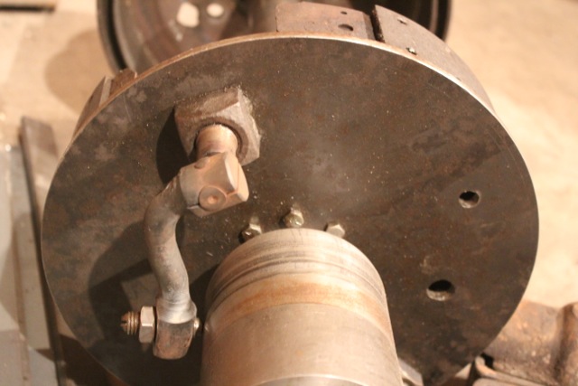

Sanderson Iron Posted April 13, 2016 Author Share Posted April 13, 2016 I've made four clutches. The first one was built from a brake out of a pickup truck. Then I made a dog clutch, because I thought it would be simpler (but it wasn't). The last two clutches I made were shoe clutches, made from scratch, which proved to be less trouble than trying to build one out of a brake. When a good line shaft clutch is disengaged, no surfaces rub other than the bearing on the shaft. An automotive clutch with its discs inside cannot be left disengaged forever or the discs will rub themselves thin and fail, not to mention this rubbing adds unwanted friction. One common type of line shaft clutch is a shoe clutch, or drum clutch. Usually the shoe is cast iron, a ring, which is spread apart by an arm so it expands against the inside of a drum. Most of the lathe clutches are of this type, and you'll sometimes see them in pairs, as I mentioned earlier, for forward and reverse (or in the case of my mill, high and low range). These are pictures of a clutch I made in 1999 for my horizontal mill. The shoes are maple. The drum (not pictured except in the last photo) is screwed to a plate which is mounted to a thick-walled pipe with pressed bronze bearings to fit the countershaft. (No close ups--sorry.) In this clutch, the shoes are engaged by two arms (see third picture), one for each shoe, which are moved apart when a cone is slid forward by the fork in the forth picture. The fork is forged form 1 1/2" square with a 3/4" square shank and 1/2" square forks (no welds of course). The arms are forged from 1" round with a ball on each end, and then drawn and swaged to 1/2" round between the balls. The ball joining the rocker attached to the shoe lever is 1" and has a 7/16" square broached hole which fits the square end on the rocker. This rocker is threaded above the square to secure the arm with a nut (visible in the third picture). The other smaller ball is tapped for the long screw which adjusts the clutch for wear. I think you can figure out the rest by the pictures. This clutch is about 10" in diameter. I made two--identical. One thing to note is the arrangement of the set screws. Two set screws at 30º is the strongest arrangement. This position offers more power than two set screws inline along the shaft. So any time you need to hold by set screw only (no key) 30º is the way to go. If anybody has any questions about these, I'll try to explain them more. Too much writing in one post already though. Joel Sanderson Quote Link to comment Share on other sites More sharing options...

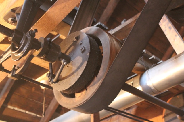

Sanderson Iron Posted April 25, 2016 Author Share Posted April 25, 2016 Did I say "overtime?" What a dork. Like I have a timed job or something. I think it'd be "extra time" or "too much time." Whatever. Here's another clutch I made. This is the one I made from a drum brake out of a pickup. Hopefully these pictures will give ideas to someone who might need to make one. The first picture shows the clutch assembled, less the pulley, which will fit to the right of the drum. There's a bronze bearing pressed into it. (Mistake, but I did it years ago.) On the left side is the cone which moves the arm to engage the shoes inside. This arm is visible in the second picture. The cone needs to spin freely on the shaft so that the arm and cone move together once engaged. There will be a yoke in the groove on the cone which will connect to the handle (no picture) to engage it. The last picture shows the inside with the brake shoes pivoted on the bottom. The arm in the second picture connects to a short shaft which rotates, spreading the shoes by means of the short S-shaped parts on top. The hub in the center is really too small for this size shaft, but I adapted it from its original position which was on a smaller shaft. I think it'll work. We'll see. It also still needs to be faced, to remove that sharp projection at its bore. Like I said earlier, I don't think I saved much by starting with a brake. It was just as simple making one from scratch. Joel Quote Link to comment Share on other sites More sharing options...

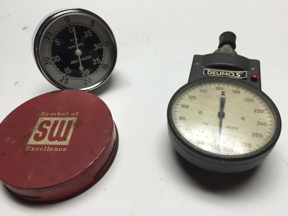

Sanderson Iron Posted May 2, 2016 Author Share Posted May 2, 2016 I suppose everyone here knows about speed indicators, but just in case, here are three different kinds. The first pictured is a Starrett, the second, a Jaquet and the third is a Hasler. Each one is held against the end of the shaft to show the speed the shaft is turning. With shafts that have a center hole, the metal point is held in the hole; if there is no hole, a rubber foot is put over the point, and that is held to the shaft. The Hasler and Jaquet also have rubber wheels for holding against the side of a shaft where the end is not accessible. This measures the feet per minute. The Starret indicator is common and can be picked up for very little money. Each revolution of the dial is 100 revolutions of the point. You hold it against the shaft and look at your watch, count the revolutions the dial makes, then remove the indicator from the shaft and read the dial, adding the reading to the number of revolutions you counted. It's best to have someone else look at their watch while you hold the indicator, especially if you're balancing on a wobbly step ladder. The Jaquet has two dials: one is a stop watch, the other the speed indicator. There are three dials reading 1,000, 100 and 1 revolutions. It is held to the shaft, and a trigger releases the mechanism to begin counting. It's very easy to use alone. The Hasler is the simplest to use. These come in high and low speed. This is a high speed. With these, there are two buttons; one returns the dial to zero; the other starts the movement. Just hold the point to the shaft, release the second button, and the arm moves until it reaches the speed of the shaft and then quits, even as you continue holding it. It is very simple to read. These are fairly common on Ebay. Quote Link to comment Share on other sites More sharing options...
Jim Coke Posted May 2, 2016 Share Posted May 2, 2016 Greetings Joel A few more from my inventory.. The oldest is not marked but I am sure it is from the early 1900s . Forge on and make beautiful things. Jim Quote Link to comment Share on other sites More sharing options...
Sanderson Iron Posted May 3, 2016 Author Share Posted May 3, 2016 Oh wow, Jim. That old one is perdy! I like it. I'm guessing the first one is digital? I thought there might be some new versions out there, but only old things stick to me somehow. Thank you for showing us. Quote Link to comment Share on other sites More sharing options...
