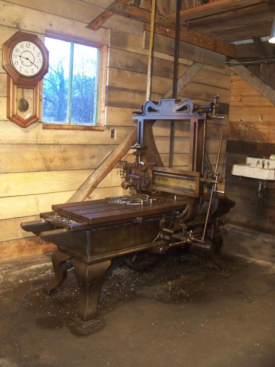

Sanderson Iron Posted March 22, 2016 Author Share Posted March 22, 2016 Here are pictures of the machine tools which I mentioned in an earlier post. As I said, each was selected to have a purpose in the shop--primarily to support the forging, making dies and so on. You can see there isn't much belt issue down low where you work. The oldest machine in the shop is the planer, made in 1869. I've heard of one other like it in the Henry Ford Museum in Dearborn, but mine's still making a living at 147 years old. I bought the lathe from an old gentlemen at Tip City, when Quadstate was still there, who said his father bought it used in 1910, and he guessed it was from the 1890's. Both of these machines are more accurate than I can measure, doing half thou work consistently. The horizontal mill is dated 1911. The surface grinder and vertical Becker mill both are from about 1910 or so. The drill presses are in that neighborhood too. I'm not sure when the Garvin die slotter was made, but I'd guess around 1920. One thing to note is the way the Becker is driven. You'll notice there is a three step pulley, making three speeds. Overhead however, there is a double clutch, which most people associate with a lathe for forward and reverse. However, I'm running each clutch with a different size pulley, making a high and low range, for six speeds. These speeds range from about 400 rpm to 2500 rpm. It's a great little mill. Again, this isn't my invention. If you look on page 60 in Kenneth Cope's planer and shaper book, there are two engravings of Flather shapers with double clutch assemblies. There is no reason to run a shaper in reverse, so this could only have been for different speeds. The last picture shows the two sized drive pulleys going to the Becker. Quote Link to comment Share on other sites More sharing options...

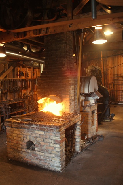

Sanderson Iron Posted March 23, 2016 Author Share Posted March 23, 2016 In the center of the shop are my forges. The main one, which I use the most, is a coal forge. This forge has a blower which runs off the line shaft at a continual speed. There is a blast gate to control the airflow, with two handles to control it: one on each side of the forge. My hot working machinery is located around the fire. These machines include: a 25 pound Little Giant, a 100 pound Hackney, a 250 pound Murray, a 25 ton toggle press, a 3 X 4 rolling mill, and a 24" shaper. There is also an anvil nearby, but I hardly ever use the thing except as a table. I think anvils are ridiculous and belong in the same basement as clinker makers. Even my center punching is done mostly with the Hackney. But that's another subject. I have three gas forges, or furnaces, too: one is a tiny single burner for itty-bitty stock, a biggish one for general forging, and a long one for the rolling mill. The long one heats up to 50" long, the general one is about 14" by 20", and the little one is just 4" by 8". I have not fired the general gas forge in two years--that's how much I prefer coal, which is cheaper and more versatile. There is a hood over the gas furnaces with an exhaust pipe connecting to a blower at the other end of the shop, run off the line. This gets the fumes outside, of course. The same blower also connects to my tumbler to suck the iron oxide dust outside. The tumbler is behind the Hackney, so I can drop parts into it when they're done. The Little Giant and the press are both 90º to the line, so there is a gearbox to get the belts to them. I forgot to take a picture of that. In one picture you can see the anvil on the left and, behind it, the wall of spring tools for the power hammers. The table beneath them is covered in single tools, and the lower shelf of the table is covered in swages and kiss blocks for the hammers. Beneath the left end of the bench is the coal shoot from the bin outside. On the right end of the table is a large stake. You'll notice the anvil is a saw maker's anvil. I do not like combination anvils. If I want a stake, I'll use a stake. Anvils don't make good stakes. I'll never understand the appeal of the double horned anvils people buy. They take up too much space and are always jabbing you in the thigh. But as I said, I don't use an anvil anyway. Quote Link to comment Share on other sites More sharing options...
