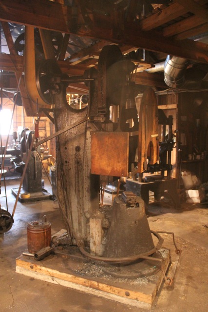

I'm gonna move back to the forging area, since that's where I left off.  Like I said, the machines are arranged around the forge.  I put in the Murray (the 250) before I added to the shop, so at that time there was no "around" the forge, because there was hardly room for a vise on the other side.  Anyway, that's why the bigger hammer is in such a tight spot and the smaller hammer, the 100, is in the open.  It would be better if it were the other way around so I could have a crane to the big hammer, but that's not how it worked out.
I made a mistake by placing this hammer at an angle to the shop and not in line with the shaft.  This means the belt coming to it has to be contorted to make the trip, and that's really hard on it.  (The belt in the picture is the third one I've had on it.)  The countershaft above is positioned so that the center of the rim of the driving pulley is directly above the center of the rim of the hammers' pulley--so the belt going upwards (the drive side) has only to twist on its centerline to make the journey.  On the return side, the slack side, there's an idler pulley positioned at an angle, pulling one side of the belt inwards.
An idler pulley is really hard on a belt, because it bends it backwards and delaminates it over time.  The advantage is that the belt has more wrap around the pulleys, so you can get a bit more power out of it, especially with sudden loads like on a hammer's start.  This idler also serves as a belt tightener.  It's mounted so that two threaded rods draw it tight.   Since idler pulleys are small, their shafts turn fast, making noise and requiring attention.
I mentioned earlier that the engine runs the same speed as this hammer.  This allows a 1:1 ratio between the hammer and its drive, giving the belts maximum power and torque.
This is a good hammer, with good control and enough power to handle stock bigger than I can lift.  Plus it has a nice long stroke and lots of ram adjustment for tall tooling.  Ram height, more than power, is usually the reason I turn to this hammer.  It can deliver strong single blows, which is also very nice.  But of the three hammers, I use this one the least.

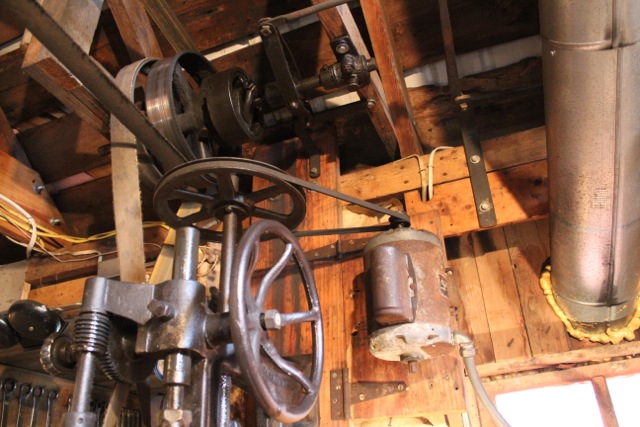

I looked at the number, Notownkid, and sure enough, it's a 16.  Now why didn't I know that?  Hmm….  I guess drill presses aren't hammers, and I'm a blacksmith, huh?  Here're some pictures of it.  This was the very first machine I bought.  I think I was still in high school or just recovering from it.  I first ran it on the electric motor that's still on it.  When I added the countershaft with the clutch above, I just left the motor, since it didn't make sense to start a big old engine to drill an itty-bitty hole.  The motor's reversible too, which is nice for tapping holes.  I take the motor's belt off when I use the line and just let the motor spin the countershaft.  This is the only machine in the shop that can be driven by a motor.  The belt coming down is crossed in order to miss the handle on the left, but it needs to run that direction anyway.
Canedy Otto must have made a lot of these, because I've seen them around here and there.  It's a decent design, with two gears for a high and a low speed; you just shift that double rear gear up for low and down for high.  I actually have four speeds, because the line shaft drives it quite a bit faster than the motor.  High with the motor is about 400 rpm, which is pretty slow, and high on the line is about three times that if I recall.  I'll have to look it up if it matters to anyone.  This machine has a ratchet down feed.  For anyone who hasn't run a drill press with power feed, it's really nice and drills holes more accurately than you can hand feed.  The controls on this are all quite high up, so my wife has trouble running it.  I could mount it lower, I suppose, but then the table would be low too.  She prefers the Rockford anyway.
I hope you get yours running, NotownKid.  It'd be worth it.  If you find it has any missing parts, let me know and I'll send you pictures to make them.  I had to make a dog and part of the feed mechanism for this one.  That feed wheel on the right isn't original either.  Originally there was a big three handled thingy, which was missing, so I put this on it.

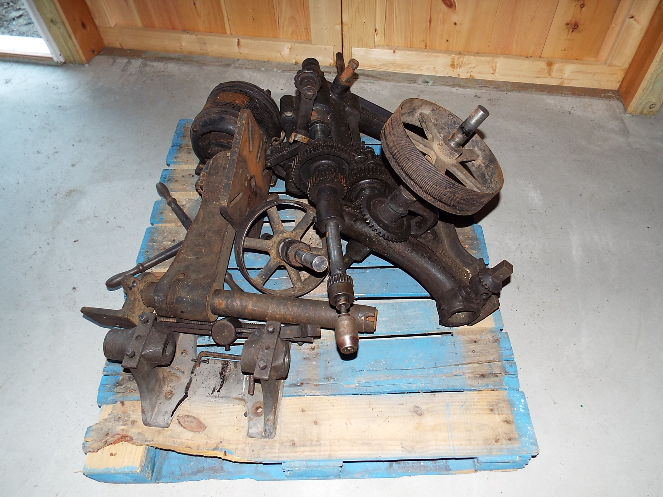

I hope I do as well.  I had never heard of Canady Otto before this came into my life.  I live in a small rural area that has a Country Store & PO and that's it.  I often go there for Breakfast on weekends when I'm home.  I walked in one morning a private Corp. Pilot who is there usually  told the guy setting next to him, this is the guy you want and he offered me a 5" leg vice for $40 I paid him and he asked didn't I want to see it first I told him if it in good decent shape I wanted it.  Then he offered a "big drill press with motor on a pallet" for FREE (Free is right up my ally ) and said he didn't want to send it to scrap, I went to his farm & looked at it, looked like a huge erector set to me, I passed and on the way home my wife asked about it and I told her I had passed on it she made me turn around and tell the guy I would take it as long as he delivered it.  I've moved it a dozen times around the  blacksmith shop, lucky I put it on movers dollies from HF.
Glad to see yours isn't restored as mine will be operating but the next guy will  have to restore it.  Hoping this summer to get help enough to get it hung on a post in my big shop.  I had another hand drill press that seems to have made a disappearing act after a divorce a few yrs. ago but much smaller.
The only thing I see is missing so far it the top wheel you have the  electric motor on, mine the  shaft looks cut off a few inches above the machine. Looks like the electric motor ran off a flat pully where your line shaft belt is.  I will try to find some pictures I took of it in a pile if they are on this computer.  Found them, no small feat for me plus getting them to load!!  You can see the motor, original??
Thanks so much for the pictures and text on this.  My wife hopes to retire this summer and we will finish moving to our Vermont farm and be able to travel, you will be on the list, love your shop, and have sent the pictures to my son, brother in law and a bunch of others in the area.

Nowtownkid, that's in nice shape!  Your hand lever do-hicky is in one piece, and the bevel gears that lift the table are there too.  I say, that's a fine specimen. You're gonna like it.  The table on these things is kinda lame though, especially since it doesn't revolve to align your drill.  I put a drill press vise with X Y on it, and that helped it a lot.  That is a nice motor.  In your second picture, just to the right of the pulley on the frame there's a little spring-loaded peg thing. What does it do? Any idea?  Mine has the same thing.  I'd guess it's a shield latch, but I can't see where one was mounted.  Here's a close up of my mystery thing.

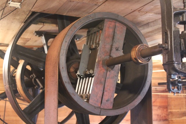

There are three companies whose pulleys are most commonly found in my part of the world (Michigan, USA), and there's quite a difference between the power they'll transfer.  The first and second pictures below show a pulley made by the Reeves Pulley Company of Columbus, Ohio.  This is a very strong design.  (It also is simple to replicate, which I plan to show in another post.)   If you have to use a wooden pulley, these are about the strongest.  It still won't carry as much as a metal pulley, but it's close if you put a metal insert against the shaft.  They're made of hard maple, and they must have used better glue than other companies, because they rarely come apart.
My entire shop is run by a Reeves pulley, directly over the Reid.  I added a 3/8" plate with a web down the middle to give it more strength to squeeze the shaft, where the wood would otherwise collapse.  When that Ried leans into a load with its 750 cubic inch determined pulses, it's asking a lot out of a pulley.
The third and forth pictures show another pulley with basically the same construction.  I don't know where these were made, but they're old.  One of the mills I got a lot of my pulleys and hangers from burned and was rebuilt in the 60's (1860's).  These pulleys were some of the oldest there, so I'm guessing they were made about that time. These are made of whitewood, also called tulip popular.  They are not as hard or as strong as the Reeves, but they're made big enough to compensate.  They'll carry a good load if they're clamped right.
Another other type of pulley that's common around here (and they show up on Ebay, so they must have been sold all over) is one made in Saginaw Michigan. These things are terrible.  The glue is bad, they come apart, and the structure is so poorly thought out that the action of the grip breaks them apart.  Their spokes and hub are made of little triangular pieces that just don't stay together.  They're only fit for light loads.  The last picture is of one which once drove my shop with the small engine (now sold), and you can see how well it handled the load.  I had another one over the 250, and when I took it down, you could rotate the hub a good 20º without moving the rim.  The belted one in the second-to-last picture below is driving my big grinder, and you can see it's coming apart now too.
Hope this is useful to someone.
It is called a gear release pin, you are supposed to be able to hold it down and rotate the double gear until the brass release lever is depressed. I cant really explain better than that without a photo.

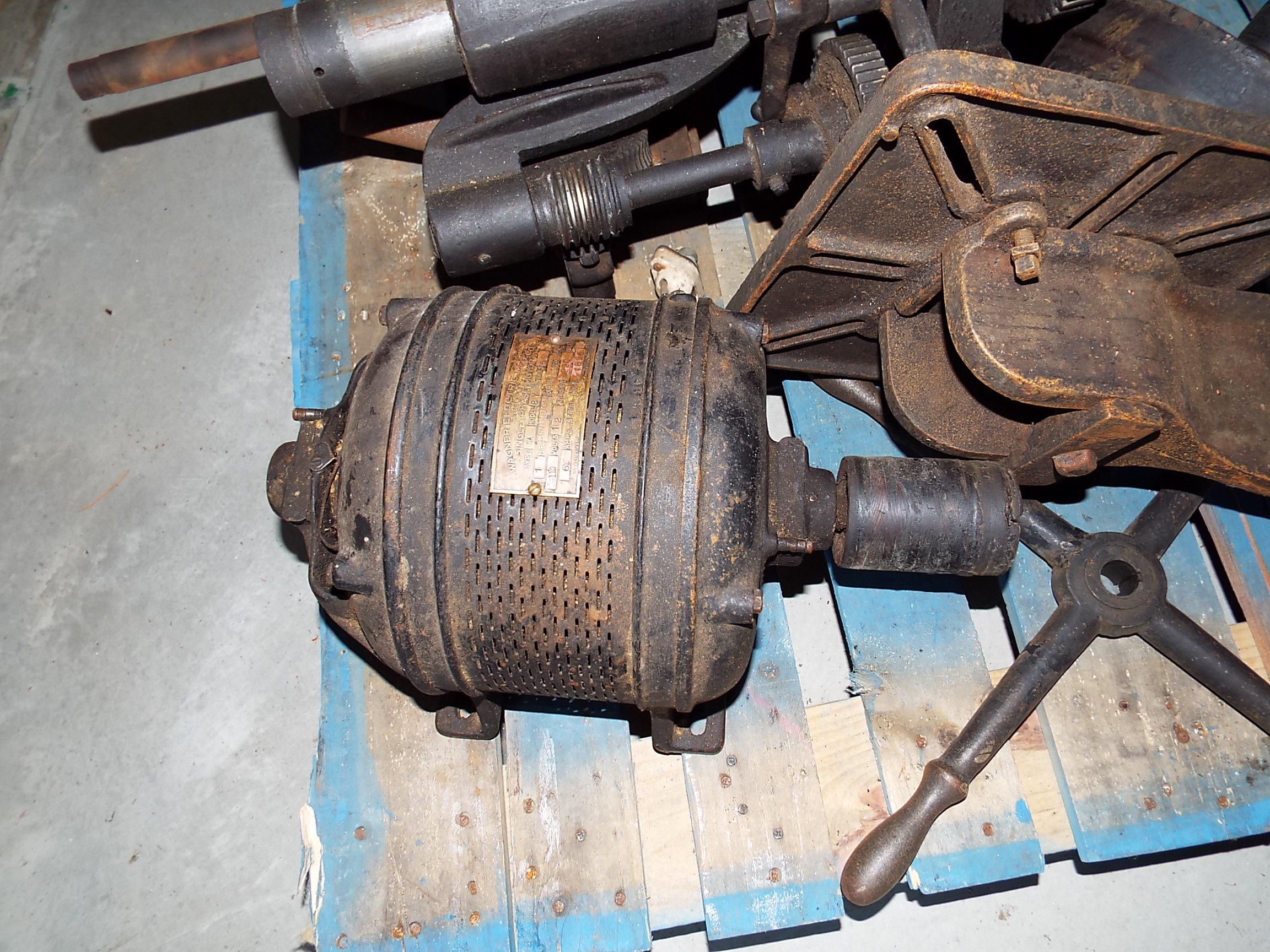

Joe:        after conversing with you on the C-O #16 I got to looking at the motor, it turns out it is a Wagner 1HP type SA 110 v and of course they are out of business now (merged with Studebaker in the late '60s and my family were Studebaker dealers  right to the end)  and hard to find anything on the net about them.  It was said to be working when they took it apart.  Will consider taking it to a shop and see their reactions someday.  I also located the spring loaded pin you showed and guess I'll have to get it upright to see better.  Also explained a spare part I couldn't figure out where it was suppose to go, I think it is the motor mounting bracket they had used.  I can't seem to make it fit anywhere else.
