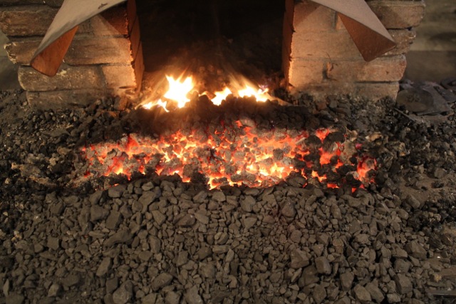

I mentioned the coal forge briefly.  The blower for it runs off the line shaft too, with two handles, one on each side of the forge, connected to a blast gate to control the airflow.  When I put this in, I was amazed how much more control I had.  A lot of people use variable speed motors, which I had in Ohio, or crank blowers or whatnot, which take awhile to wind down and stop the airflow.  Having the ability, with a blast gate, to instantly cut the air from the fire is really nice.  Let's say you're running a little too hot and you see some sparks.  With a gate, you can cut the air to the fire, leave the work in it, and the iron quits burning.  By leaving it there a minute where there is no oxygen, you're okay.
My coal fire is built on a fire pot of my own design and construction.  This is a side draft pot which makes a fire 16" long and 6" wide.  This is large enough to keep my 250 happy, and it's even enough to heat several small bars simultaneously.  Awhile back my assistant was heating five little bars in the fire so he could pick one out after another to work continually.  They were 3/8" bars tapered to 1/8", and he worked all afternoon without loosing one to the fire.  A good coal fire has better control than a gas furnace.  Unfortunately, the clinker makers on the market do not make a good fire, and as a consequence, people are turned off by coal.
That is not to say a gas furnace does not have its place.  I have three.  These are forced air furnaces, and they all are driven by the same blower with different pipes with valves to each furnace.  I use gate valves, because they are all metal and can take the heat, and there really is insignificant pressure downstream of the blower.  (Of course, I use a ball valve on the gas line.)  To run the main furnace, I close the valve going to the small furnace and open the valve to the large one.  It's really simple.  When I use the long forge for the rolling mill, I roll it in position, attach the pipe, and close both valves to the other furnaces.  The blower I have is an antique blower called a NoCoal, and it was given to me by Fletcher Coddington when I worked for him at Arrowsmith in New York.  It's a little 1/10th horsepower AC motor.  Unfortunately, being AC, I can't feed it with the dynamo.
Beneath the gas furnaces is an opening in the bricks which is filled with ashes for annealing. A support rack pulls out to hold the ends of long bars in the fire. It can be put on either side.

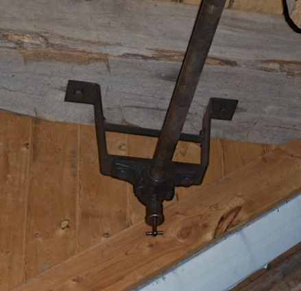

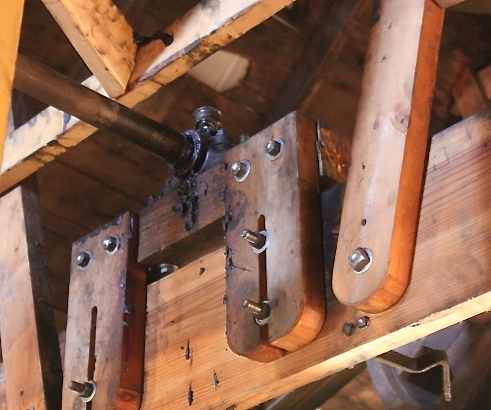

I know how that is, Adam.  I didn't have the right things when I started putting mine up either.  A lot of times, you never do.  Like Jim said, we can't just go down to Home Depot and pick up what we need.  I've made a lot of bearings and hangers that work, so I'll show them to you here.  The first picture with the wooden mount shows how my main line shaft is mounted.  I was just out of college and didn't have real line shaft bearings or much to work with--but I had pillow blocks and a band saw--so to get the bearings level and in line I made these adjustable wooden bases that could slide up and down for positioning.  They're just 4 X 4's and 2 X 6's bolted together. (I ran out of money and never bought all the bolts!  Ha ha!  Still missing some!)  I used a string to get the bearings in line and on the same level, and then I put the shaft in place.  The bearings set on a rod 90º to the shaft so they can rock fore and aft.  These are the bearings I mentioned that are fed with grease cups.  It's been working for 20 some years, so I guess it'll keep on working.
The next two pictures show other pillow block bearings, but here they have steel mounts.  These are just 3/8" by whatever and riveted together.  They look more in keeping with a line shaft, or at least like a real blacksmith made them (unlike the wooden ones).  The first one is over my die filer; the second is over the rolling mill.  Notice the grease cup on the rolling mill's?  It's the kind with a T handle, so you can reach up with a stick with a notch in the end and turn it.  Handy.
The fourth picture shows the hangers I made for my Little Giant.  I made these, bearings and all.  The bearings are just thick walled pipe with babbitt poured inside.  These are held by two vertical screws for adjustment and alignment inside a ring.  The stem of the ring, mounted to the beam, is 3/4" X 1 1/2" if I remember right. The stem and ring are all one piece, riveted back onto itself.

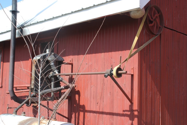

The last picture shows the bearings and mounts I made for my outside radiator.  Same idea--thick walled pipe filled with babbitt, but these are pretty crude since they're outside.  They work though.
I hope this gives you some ideas.  You've just gotta use what you've got.

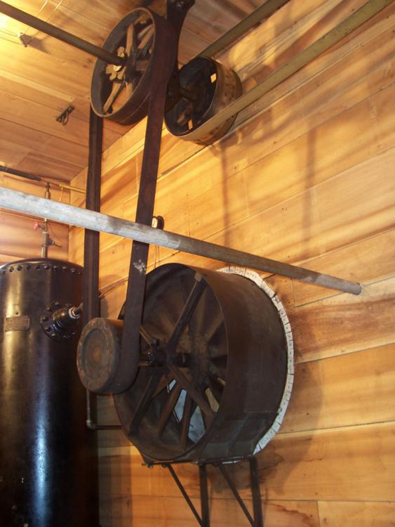

Whatever the engine, it needs to be separate from visitors.  My engine room is lower than the shop and office, so there's an overlook with a guard and gate so people can pass through the room without being in danger.  This guard is to code.  Separating the engine is for your own safety too, of course.  The engine is the most dangerous part of the shop, since it is raw power without any chance of a belt coming off.  All the time the line is running, there is an exhaust blower running, circulating air through the engine room.  Any open crank engine is gonna leak fumes, and if you have an exhaust leak, you'll be in trouble.  This fan is about 36" in diameter, and it runs pretty slowly.  I leave a window open whenever the engine is running.
The engine room floor is also lower in order to get the line shaft and plumbing over head.  I laid up the stones myself.  I figured it'd make a more sturdy foundation than anything else, to handle the line shaft.  That's probably true, but boy was it a job!  Not gonna do that again.
The small riveted tank at the top of the first picture is an expansion tank for the 200 gallons of coolant through the shop radiators.  There's a sight gauge in the side to tell the level.
