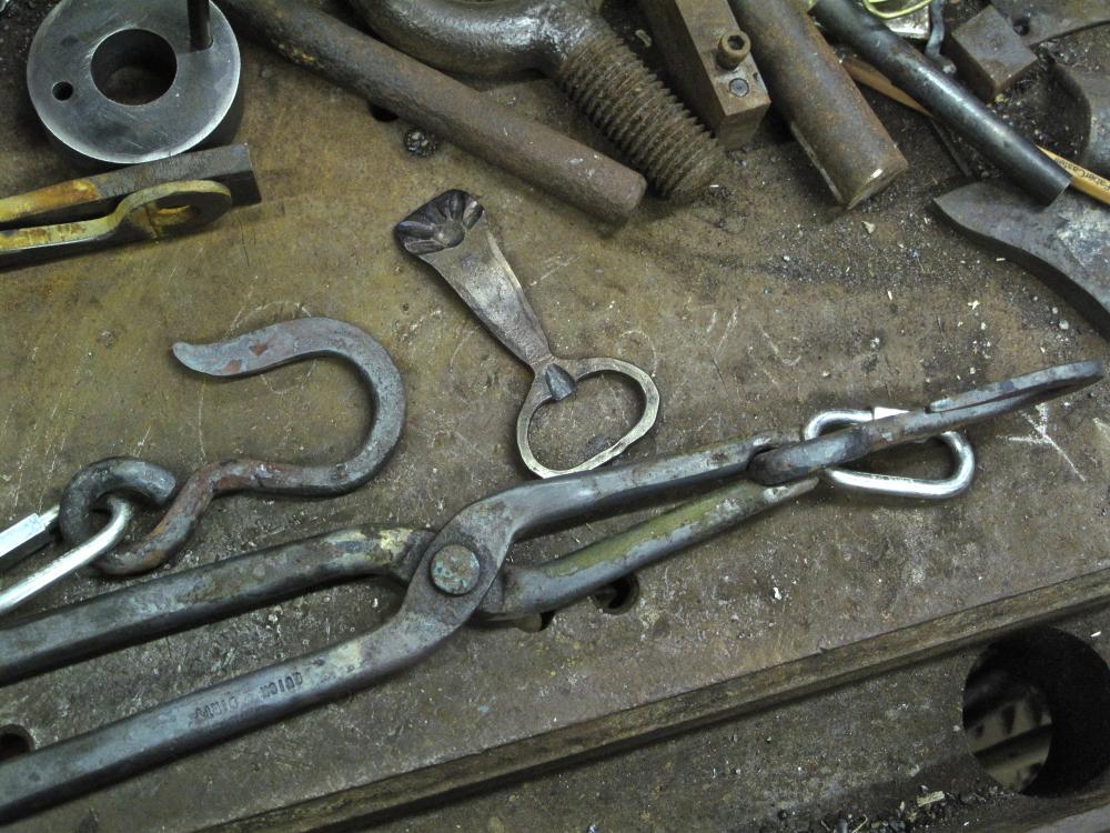

While I'm on the record as being wholly against making your own tongs until you've got the skills to do it in a timely fashion and know you'll end up with a quality product that rivals what you can buy new...... there is a middle ground.
Companies like Quick and Dirty Tools offer "tong kits" that are cheaper than their fully-made tongs but have all the big work done for you.  You get to forge the jaws to shape and set the rivet, but don't have to worry about drawing out the reins.
I keep a few "kits" on hand for those times when I need a set of tongs for some weird maneuver or just don't want to wait for them to get mailed.  When I needed a set of ring tongs for a quick project, I grabbed a kit and had the tongs made in about ten minutes.
