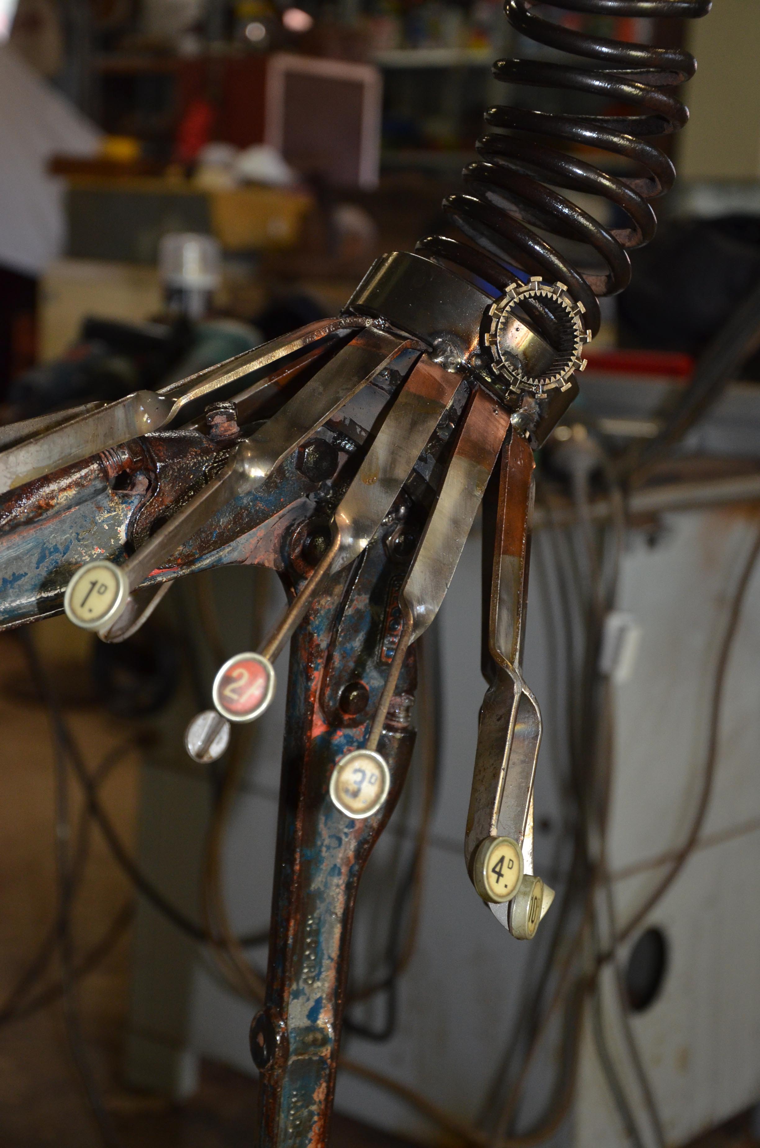

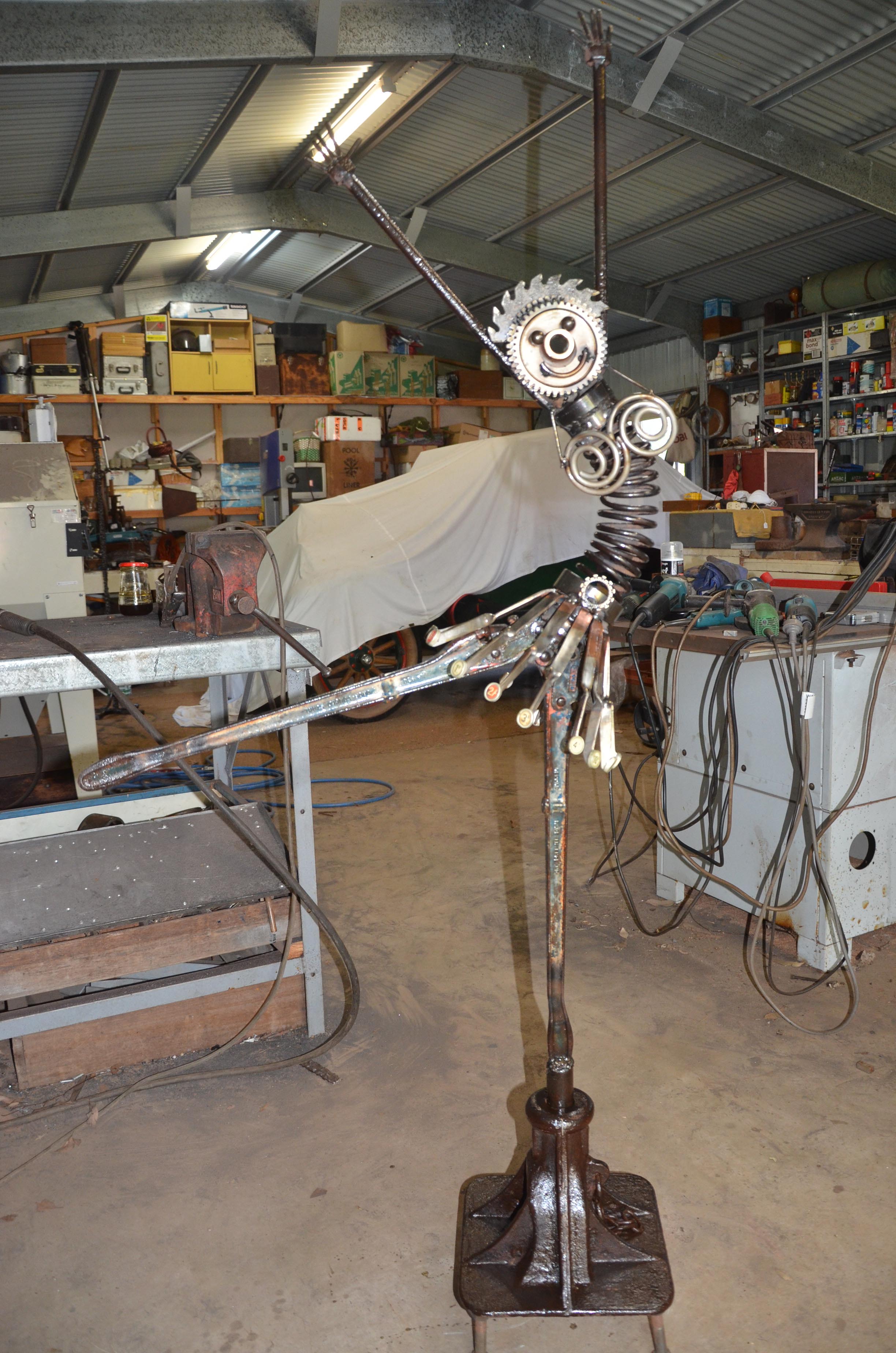

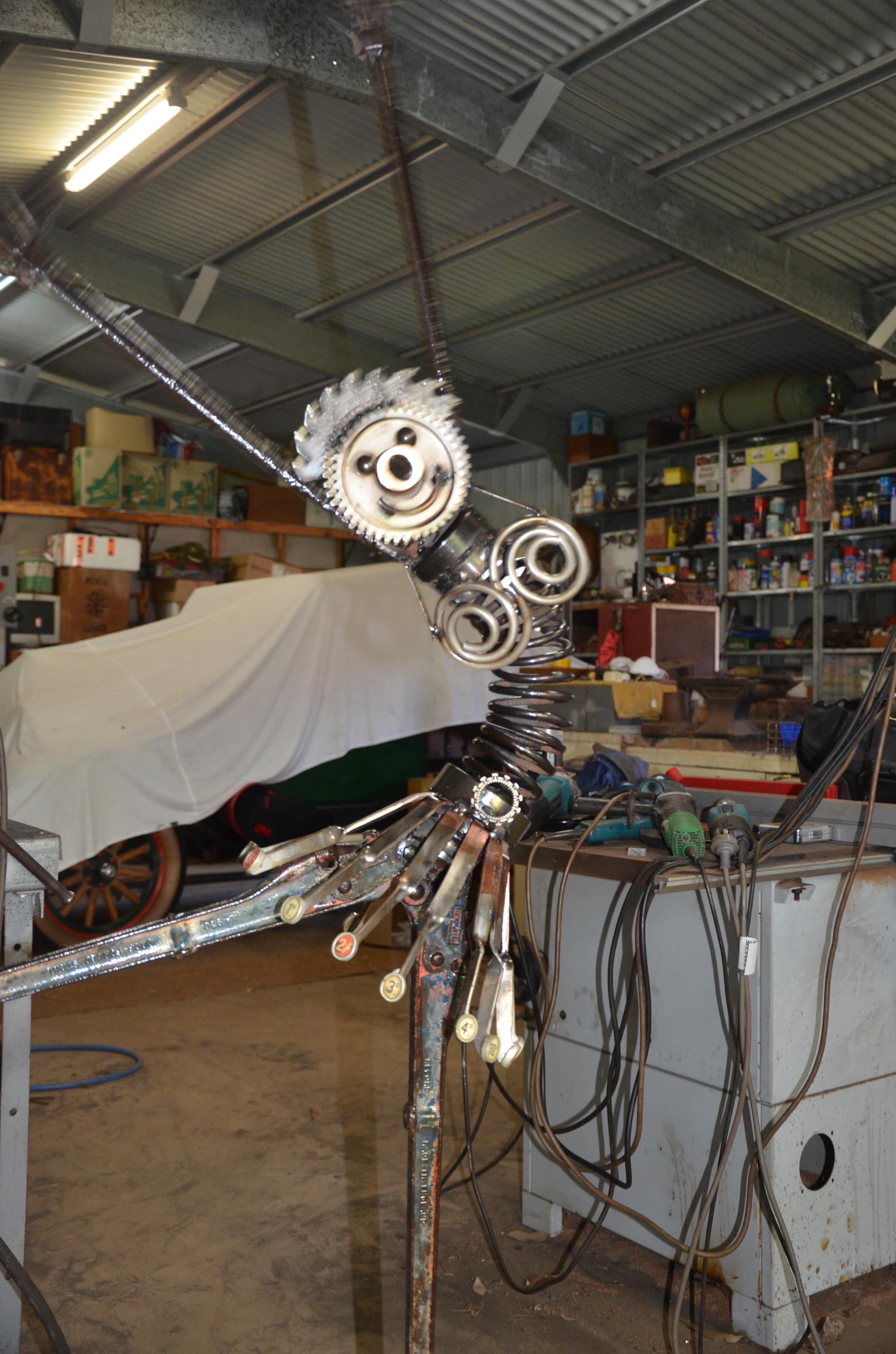

Here's a movement sculpture for the garden. She moves in the slightest breeze. The first spring I used for the body was way too soft to carry the head and arms and she was more inclined to touch her toes than sway as intended. I cut that spring out and found a beefier one, trimmed to length to have the best flex.

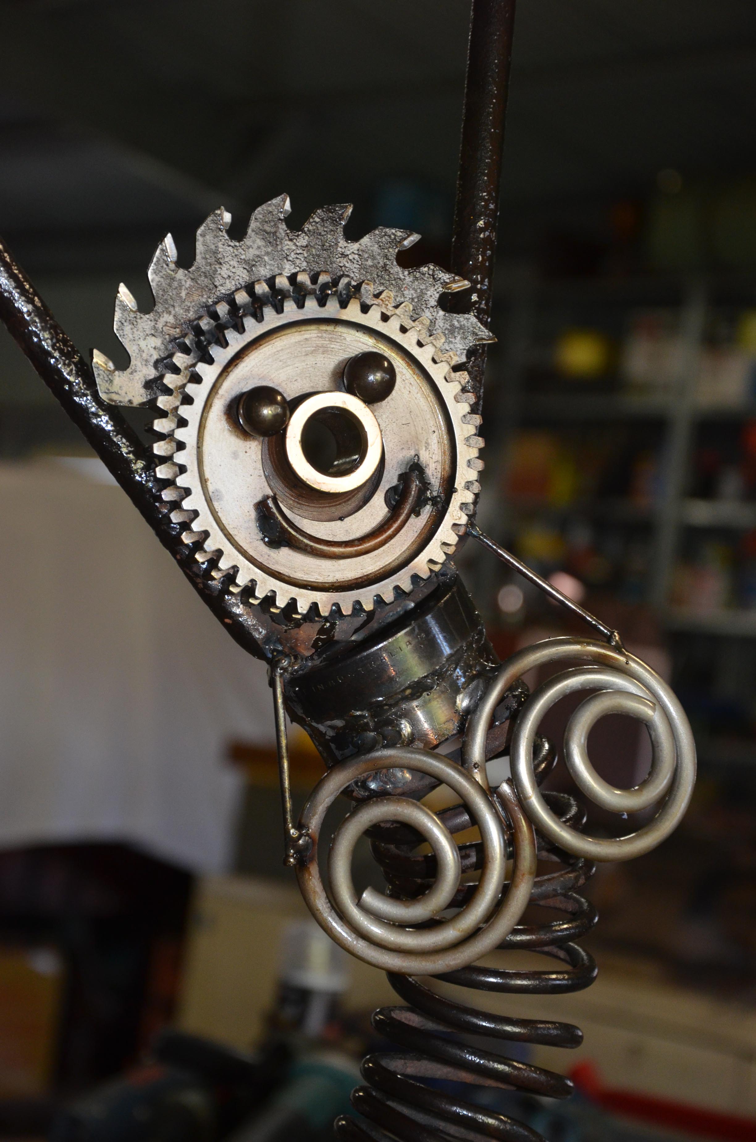

The legs are a pair of bolt cutters, the head is made of gearbox bits and the arms are a long U-bolt. Fingers are piano pegs. The skirt is made from keys from a cash register, and her top is a pair of stainless coil things from a power line.
I've done a few of these of various sizes and find it's best if you keep the left leg vertical and left arm in line with it. The others roughly at right angles. Seems to balance that way.

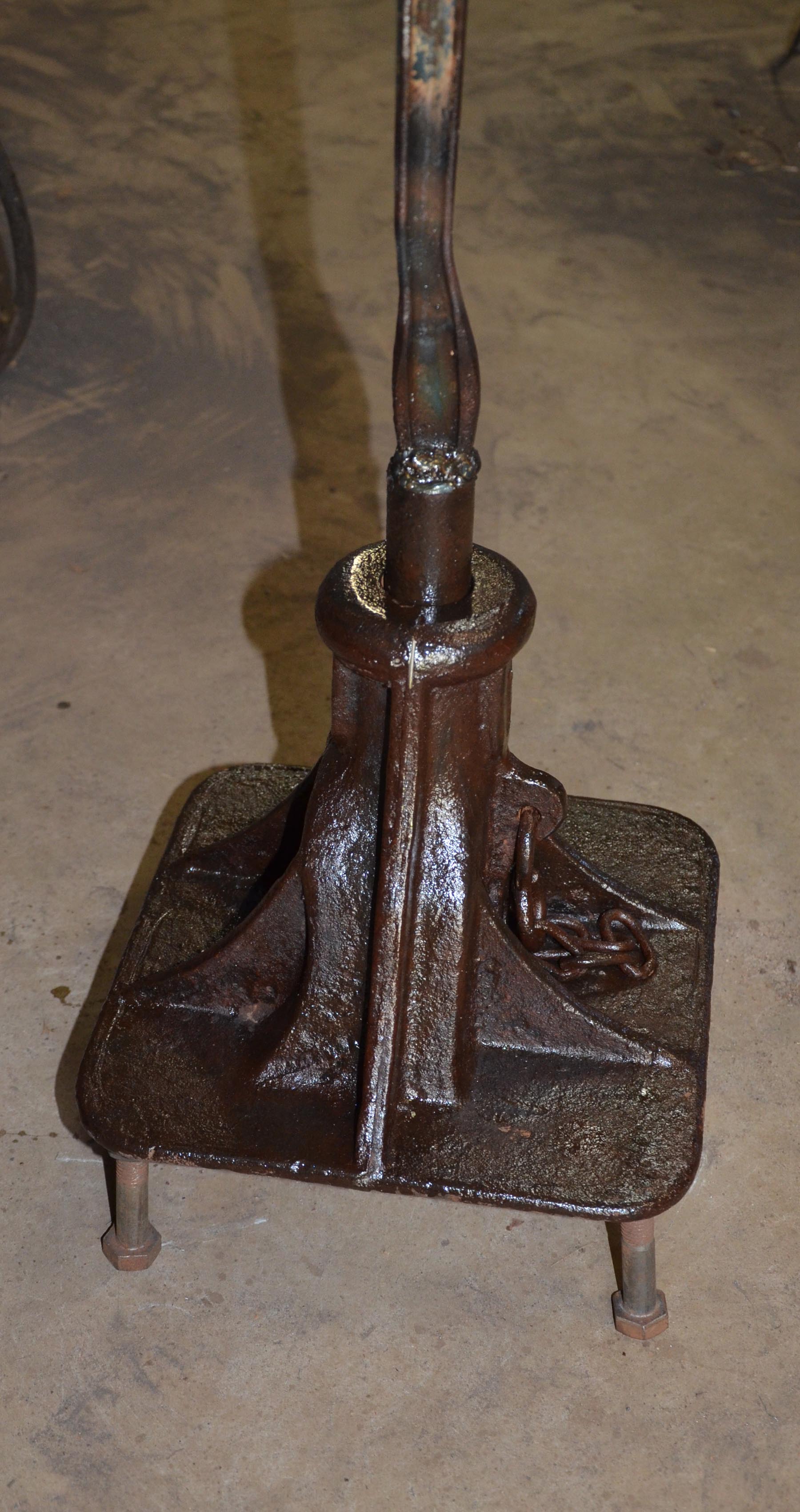

For anything with a spring movement you need a firm base - either heavy or anchored down. This was a big lump of something from the scrap - nuts welded underneath hold the bolts which can be adjusted for length on an uneven surface. Any movement in the base is not good. It's heavy but detachable for ease of shifting her around.
Anyway, she's a happy girl for the garden. She's moving in the last picture. Would look better amongst the flowers than in my shed.

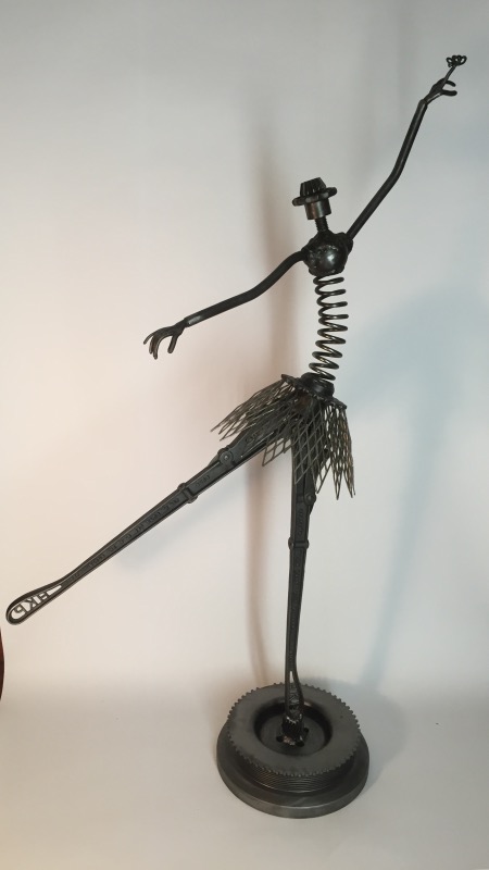

Ok. Ever since I saw this I've been inspired to make one. since a junk pair of bolt cutters showed up at my doorstep I was on it. finished it up tonight and am calling it Ballerina. gave her a little butterfly for inspiration. sorry for the horrible picture. I am still working on my photography. Thanks for the inspiration Aus!
Nice work, Das. I'm pleased to see you put the bend in the spring. Her arms and hands look elegant. It's good how the boltcutter handles look like ballerina shoes.  Is the spring soft enough to make her sway gently or does she vibrate? Looks like a motorcycle shock spring to me.
Glad my dancing girl could inspire you!
You have been very inspirational. Thank you.
The spring is just a touch tougher then I would have liked but she does sway more then vibrate.  The hands are the ends of 3 different sized nails with the bolts that held the jaws on the bolt cutters as the wrist portion. Then I heated each hand in the forge and bent the fingers.
20 minutes ago, BIGGUNDOCTOR said:
Das, you could take some of the temper out of the spring to soften it up. That may get it to sway easier.
I heated it up a bit ( dull red) to bend it. Not sure if more heat would loosen it up much more. But it's a great suggestion.
