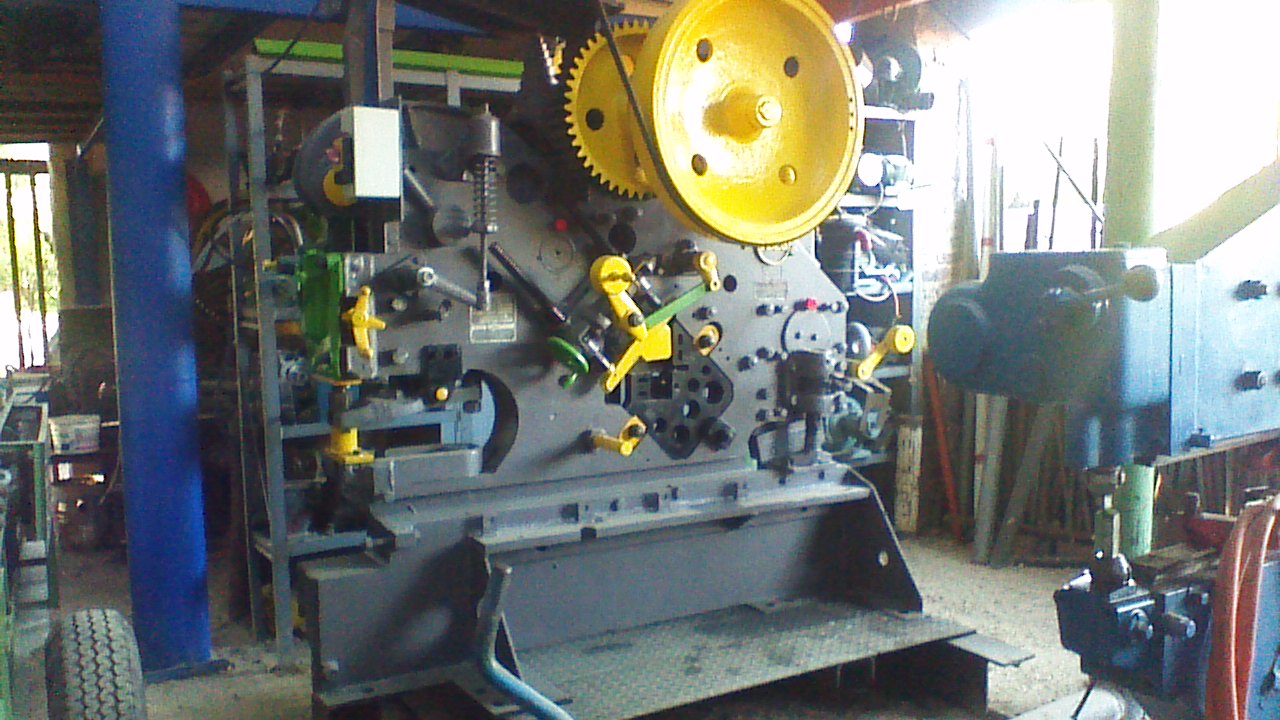

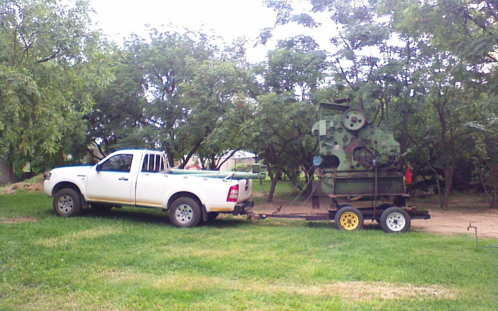

There are obviously times when a 2" ratchet strap just isn't going to cut the mustard!
Incidentally the same machine after we slapped some paint on it.
A pels ironworker
