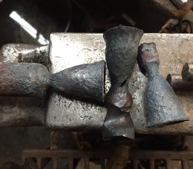

last night I found a piece of pipe in my scrap pile and had been wanting to make candle holders.  Using my spring fuller I tapered off the section to use as the "cup" for the candle and it went well.  I then took it to the anvil horn to flare the top then taper off the lower part of the "cup" a bit and I noticed I'm twisting the part I fullered, and it's splitting. The last one I even tried to pay more attention and tried to go easier and watch to see how I was getting this twist but couldn't really see how.
  Looking at the tutorial that I hadn't looked at for a while I pretty much answered my own problem as they flared the cup before spring fullering the section.  Still would like to achieve a hammered look and maybe there's a better way then what I'm doing in getting the the fullered area twisted and split.
 If the pipe is galvanized remove the zinc first. Always plug the non-working end of the pipe so it does not form a chimney or generate a steam cannon.
Flare first, hammer texture, then fuller.
EMT pipe is good for candle cups. Work any pipe HOT to help avoid splitting.

Hi Das with regard to the twist, it may be you are rotating the piece as you are striking the top tool, thus one half is rotating whilst the necked bit is stationary between the fullering tool. Try it with a pause in rotation when you strike the top tool.
I would also suspect the forging temp is low judging by the finish on the fullered area, if the tools are smooth, I would expect a better finish on that area as you can see on the centre one of the three where it is not necked in but has been struck.

IronWolf, i was just trying to flare it out a little for looks not to make the whole thing bigger diameter really, and havn't had much problem there. it's been harder for me to taper the pipe in more at the bottom by the fuller for some reason. and thats when i get the cracks.
John B, possibly for that i should be using the straight pein that RT redid for me that has a wider radius but the cracks are happening before hand. as for the rotating on the hits i tried to pay attention to that more this time and actually While fullering it dosn't Look to be twisting it's while i was working the rest that it seems to twist, or atleast show it. i tried to work it like Glenn said and couldn't get the taper before the fullering that i wanted but with flaring and then fullering i did still get a minor twist crack on one. but i also still lightly worked them after for the look.. Ugh.. my bad.. i'm going to try some new pipe and see what i get out of it. it could be this pipe or My working it. i even kept an even heat in between where i fullered on both sides this time thinking i under heated half last time.

You can cut the socket off a lug wrench and weld it to a hardie plate. Heat the end of the pipe, place it on the socket and whack the other end a couple of times. Instant flair, and an even flair all the way around.
You can try fullering down the pipe from opposite sides, 2, then 4, then 8, then 16 etc like forming a taper from square to round, and it may not want to twist.

Looks like you are using the anvil edge, as opposed to your spring tool, If forged in a spring tool at the correct heat I would expect a better more smoother finish that what yours appears to have.
