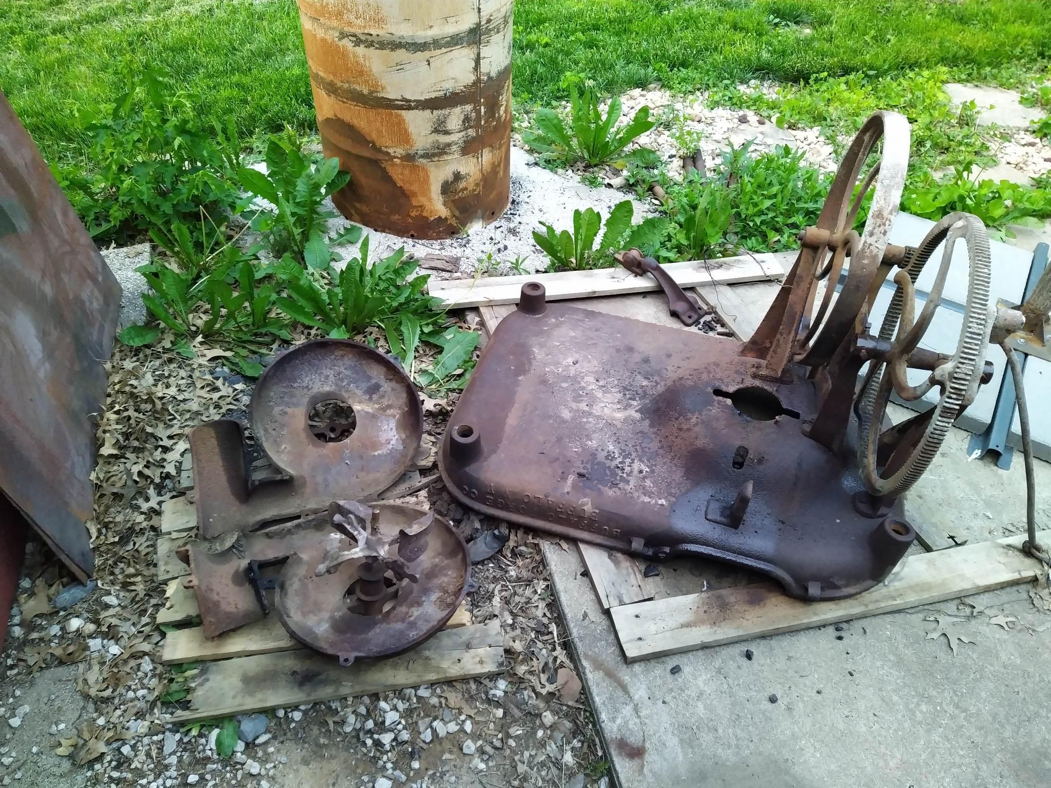

Shainarue Posted May 18, 2023 Share Posted May 18, 2023 The 50% Dextron II ATF and 50% acetone mix is what I've been using. Wire brush, spray, let it soak while I forge. Then when I'm putting stuff up, I try with a wrench, hit it a few times with a rubber mallet, try again, then spray the mix again and try again the next day. Been doing that for 10 days. Haven't tried heat. I'll give that a go next. What happens if there's still residual atf/acetone mix in there when I heat? Quote Link to comment Share on other sites More sharing options...

Shainarue Posted May 22, 2023 Share Posted May 22, 2023 I was using the rubber mallet on the wrench - not that it mattered. The wrench wouldn't hold on to the nut anyway. I also used the rubber mallet to kind of just bang around on the seal/ears of the housing to see if it would jar something loose enough to help. I've also whacked on it a bit with a piece of 2x4, lol. I honestly don't care if I break the bolts or the nuts. I figure the worst ones will need replaced anyway and I'm not trying to keep this a "100% true to all original parts" restoration. I already knew I'd have to replace the original wrought iron legs with new steel pipe. And there are a few parts I already know I'll need to recreate or purchase. I have no qualms with replacing the bolts & nuts on the blower housing. That said, I'm also trying not to cause any stress on the ears of the blower housing where the bolts go through - because if those break off, I don't know that I'd be able to repair it without just recasting (and I've never casted, lol). I haven't worked on it at all since I last posted here, so I haven't tried heat yet. But if heat doesn't work, then I'll go with Frosty's suggestion to soak a rag in the ATF Acetone mixture and try that. I'll post an update when I have one. Quote Link to comment Share on other sites More sharing options...
Frosty Posted May 22, 2023 Share Posted May 22, 2023 Stripping the wrench facets off nuts is common trying to break them loose brute fashion. Taking a mallet to the wrench is a definitive Brute force method right up there with getting a bigger cheater. Tapping the bolt or better head end with a hard hammer causes shock waves in the bolt shank. The shock travels at a different speed through the bolt than it does through rust so it crushes the rust. The penetrant will help lubricate the joint and improve freeing it up. The real downside to brute forcing frozen nuts is the chance of breaking the bolt flanges, even loosening them puts a lot of stress on the flange. You'll have to do some brazing if you break a flange off. How much do you have in your tool budget? I expect you are using open end wrenches and they slip, stripping the wrench facets off the nuts. Yes? If you don't have box end wrenches or there isn't room to slip them over the nuts you need "fuel line" wrenches, they are deeper meaning more contact with the nuts and have a small opening so there are two more contact faces on the nut. (image below) Few things deform or strip off like the flare nuts on a fuel or brake line and these are designed to keep really fragile "nuts" in tact. They're really common in pawn and second hand shops if you don't do mech yard saling. Another alternative is to buy an electric impact wrench, a 3/8" drive is more than enough brute-ness for your current purposes and you'll want to turn it down power wise but they're designed for breaking frozen juts and bolts. One way or the other. I got my 3/8" and 1/2" pneumatic impact wrenches and my electrics in pawn shops. Not great deals but they got better when I rolled my eyes at the marked price and lack of willingness to bargain, turned my back and headed for the door leaving the impacts on the counter. If they're small enough nuts you can use an impact drill like you use to drive long screws. Best of luck, everybody needs it breaking frozen threads. Frosty The Lucky. Quote Link to comment Share on other sites More sharing options...
Shainarue Posted May 22, 2023 Share Posted May 22, 2023 I do have some fuel line wrenches like you pictured. Came in a Dremel tool bag I bought at an auction. They didn't fit the nuts though. I also have an electric impact wrench. It was actually one of the first things I tried. The socket doesn't have room to fit onto the nut due to the outward curve of the fan housing. I've got about 20 minutes before I need to run out for an appointment. I'm gonna go try a few taps with the hammer just for good measure. Quote Link to comment Share on other sites More sharing options...

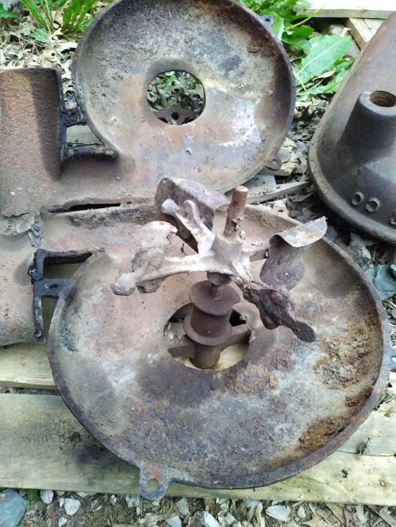

Shainarue Posted May 23, 2023 Share Posted May 23, 2023 Got them all out tonight! Freed up two before my appointment and the other 3 after. Tap tap tap, heat, cool, tap tap tap, try. Repeat. Finally got a look at what the inside had in store. I'll need to fabricate a few fan blades. Otherwise there's not much to it since basically the gears are on the outside in the form of those humongous wheels, lol Next up, the tightening pegs that hold the crank wheels in place. Tapped and sprayed them tonight before I packed up for the evening. Tomorrow I'll give them a try with the wrench and move straight to heat if they don't budge. They don't look like they have as much build up though so fingers crossed. I know, slow is fast. But my wife's patience is running out regarding the "pile of junk taking up almost all the patio". She exaggerates. It's only taking up a quarter of the patio. But I promised I'd have it moved off as soon as I got it apart. Quote Link to comment Share on other sites More sharing options...

Shainarue Posted May 23, 2023 Share Posted May 23, 2023 I have last season's baby pool to use for the derusting process. I am going to use electrolysis. Pool just needs a few patches and it's ready. PNW_Sparky, it's model 0 (zero) from the late 1800s. I've been following your thread as well and already had the POR15 paint bookmarked. Though I'm kinda leaning toward BLO. Just depends on what it looks like after rust removal. I shiny metal, it will get painted. If dark metal, then blo Quote Link to comment Share on other sites More sharing options...
