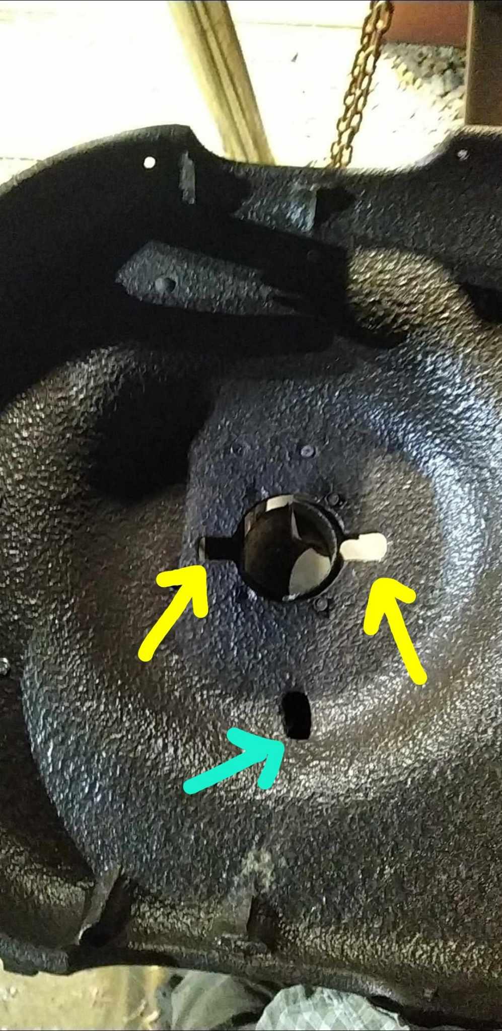

Shainarue Posted November 14, 2023 Share Posted November 14, 2023 Any one know what these holes are for? I'm thinking surely they're intended for something that fits into them because otherwise That's a big air space and coal hole, lol Pretty sure the blue arrow is where the rod to the clinker breaker comes out. Like like that on the catalog picture anyway. Quote Link to comment Share on other sites More sharing options...
Frosty Posted November 14, 2023 Share Posted November 14, 2023 Perhaps the air grate and clinker breaker rested on pins that fit in them? Frosty The Lucky. Quote Link to comment Share on other sites More sharing options...
Irondragon Forge ClayWorks Posted November 15, 2023 Share Posted November 15, 2023 I'd also say a round air grate. I can't control the wind, all I can do is adjust my sail’s. Semper Paratus Quote Link to comment Share on other sites More sharing options...
