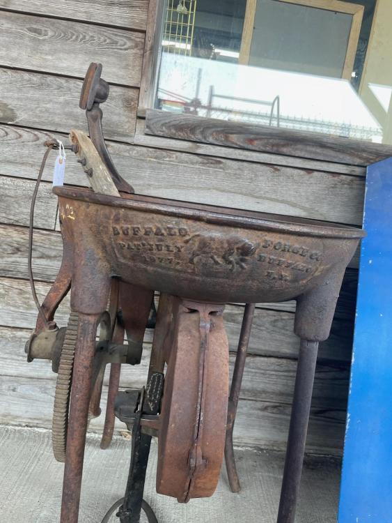

I am very new to blacksmithing and recently acquired a Buffalo Forge which is stamped  pat. 1879.  I am looking for assistance with proper rust removal, paint color and any missing parts.  I have spent a great deal of time researching, but have yet to find a photo/info on the type of forge that I have.  Any help would be greatly appreciated.  I do have photos available.  Thanks

Here are the photos from the Buffalo Forge I recently received.
Sorry some of the photos are sideways.  Still trying to navigate thru the website.
I do have the blower for the bottom, which I currently have apart and rebuilding the fan blades.
I am looking for help in:  original color, clay line or not, missing parts etc.
Any help would be appreciated.
I'm not really knowledgeable on these, but i dont Believe they were originally clay lined and i wouldnt know about color but i've seen some with the pot and blower black and the legs and gears red but thats just some i've seen. could have just been someones repaint.
  like i said i'm sure someone else on here could chime in with more info.
here's a question, Do you plan to use it or just restore it?  If your going to use it then make it how it would best work with the fuel your going to use in it.

You can use clay, nothing special, clay from a river. I have used clinker and crushed fire Brick pieces. Anything to give  a space between the cast and the fire.
The proper colour is what fits your attire. There is no rule committee, look in your paint cupboard and decide on what you have in stock. I personally like putting on Flames, any colour you like.
Go very light with the sand blast!! Too much will remove parent material and ruin oilite/brass bushings. The seals are "OLD SCHOOL", be careful.

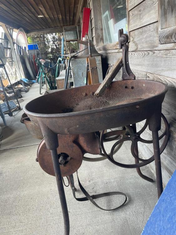

  • Here is the completed forge.  Sorry getting used to loading images on this site.  I placed a piece of metal in the bottom.  The screws you see are through the bottom of the steel plate are to hold the plate in place as well as the blower underneath.  I was worried that the blower would fall out due to the bottom of the pan being so thin in that area. I have a piece of grating over the plate.  Should I be worried of the steel plate warps?  I would hate to damage the pan.
  • Thanks for any help or suggestions.
  • Still unsure about whether to clay line or not....
  • 4 weeks later...
I've had numerous small forges and I clayed the first one with high temp refactory cement, water eventually got underneath the cement and started to rust out the pan. I've never cemented another and never had any problems, no cracking or warping the pan.
Thanks PaulE!
Living in Michigan I have lots of bad weather so I will take your advise and not clay it.

I recently purchased and plan to repair a forge very similar to Martin Mendells. i seen the painted forge. it looks nice, I am also from Michigan. did you ever end up lining it with clay? or does anyone have an answer on how to do it? id like to make mine operational again I'm glad I found this form. I didn't take into consideration these were lined with something at one point. Any feed back would be greatly appreciated
Yes, line it with clayey soil. I like 1-2 parts sand to one part clay and just moist enough to ram it hard with a mallet, end of a 2x4, etc. Leave a depression over the air grate exposing it. The depression provides a small "pot" to contain the fuel but you can easily build a larger fire with more fuel and air.
Do NOT make mud or modeling clay of the liner material, it will shrink check when it dries.
No refractory cements or mortars, just clayey dirt or buy a sack of fire clay from a masonry supply. Fire clay isn't any better than road cut or garden clayey soil but it is convenient.

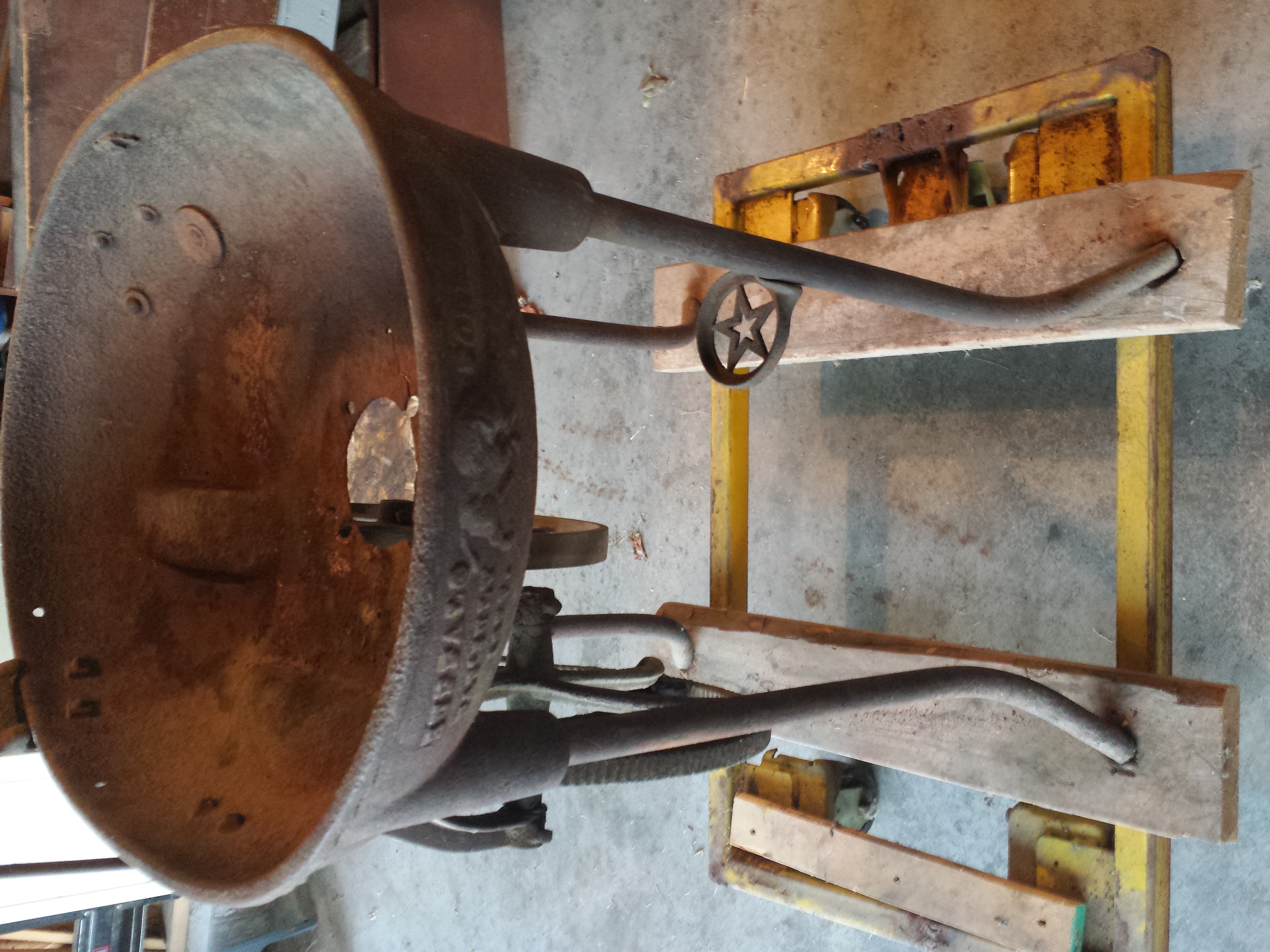

Whoa. I was also coincidentally looking at this thread the other day because I am ALSO looking to restore an old buffalo forge! Mine isn't exactly like Martin's. However, it does have the lever-operated blower which is what I needed more info on. Mine's a Buffalo No. 0 (zero) which is also shown in that ad above. I was going to post pictures once I actually started working on it. So far I've only just removed the legs & the lever mounting piece. Lots of soaking & waiting to get the blower cover off and see what all I've got going on in there (or not going on, lol).
Edited by Shainarue
correction
Shainarue,   I'd love to see what yours looks like. Here is mine. The last picture is what I believe mine looked like. I found my blower was in poor shape so I have already started making new fan blades for it. I realy like the patina on it so i may just leave it (meaning not paint it). but other than that I'm going to bring it back to working order.
Here's what it looked like before I turned it upside down and removed the legs for easier access to the blower.
I've been soaking & tapping on the bolts holding the blower cover on for over a week now and they are not even close to budging. I'm thinking I'll just use a dremel to cut them off since they'll likely need replaced anyway.
Keeping my eye out for a used air compressor with 1HP or higher, and then purchasing a cheap hand-held sand blaster. I plan to set a table over this and drape a tarp over the table - creating a make-shift spray cabinet - so I can reuse the blast medium.
What are you soaking the bolts with? Have you tried heating them a little? Cast iron will expand a little more than steel with heat. About 350-400f and a little oil works often enough to be worth it for me to try.
Frosty The lucky.
